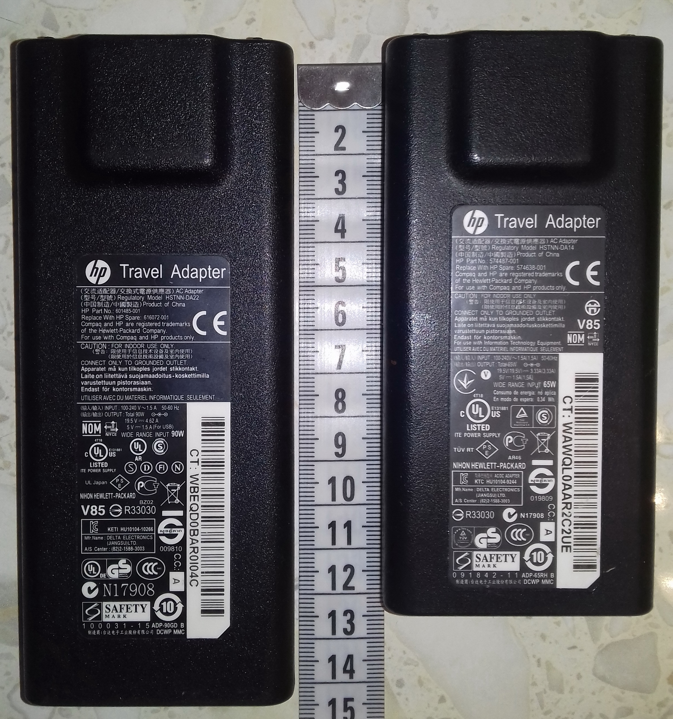

On 1/6/2018 at 2:24 PM, Onoakino said:
Can you guys recommend a slim/lightweight probably 2017 model charger that's easier to carry than the stock charger that works for our 2570p?
So damn true, the 2570p is bit heavy...
About the charger - last year about 20-30 chargers went through my hands, my impression was that Watt capacity was very tightly related to weight. That is, a charger gotta weigh at least that and that grams for 65W, that and that grams for 90W and so on.
7 hours ago, ImMortal468 said:
Not sure if that USB will have full functionality anyway (other than storage), you might want to research that. Also make sure to get a CD-Rom caddy for the optical drive bay if you wanna put anything different than a DVD drive in it.
For extra USB ports I use this express card. Poor build quality but it does the job. https://www.aliexpress.com/item/New-Express-Card-Expresscard-34mm-to-USB-3-0-2-Port-Adapter-PCI-Express-Card/32647044360.html?spm=a2g0s.9042311.0.0.Hcy6Fc

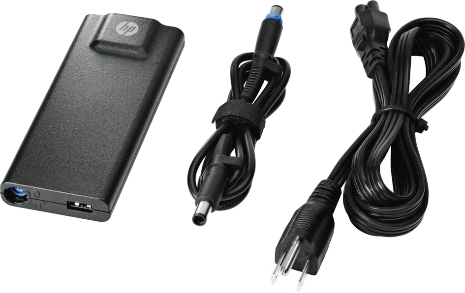

Yes, you can bay travel adapter HP. Here for example: Ebay 5a5b1570e9ddd_TraveladaptorHPEliteBook2570pSlim90WBT796AAORIGINAL.thumb.png.f79228869bea7e2eb0c64dca67006986.png
I use the 90W adapter. Your processor is i7 3612QM and you can bay 65W adapter. But my advice is 90W adapter.
Edited by invait53

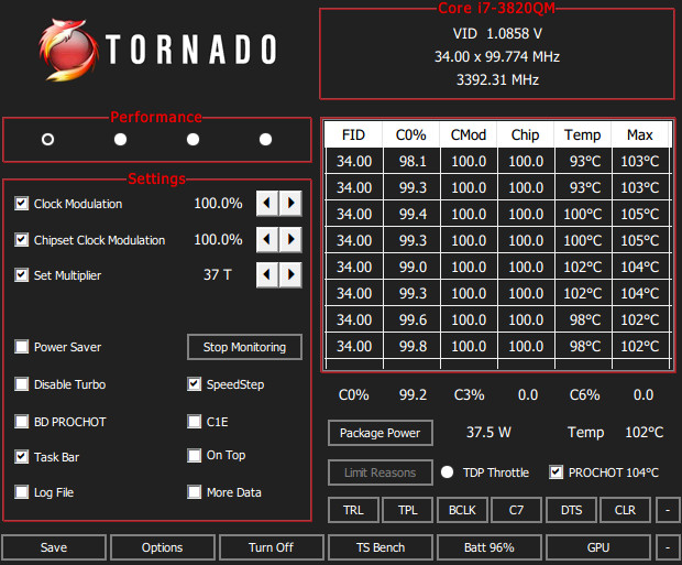

Actually, I have a 3820qm and I had the same problem about the fan spining non stop.
This was getting me insane, until a day I disabled by mistake entirely the fan, and it started to speed only at critical temperature at 90°C.
So, now my fan is constantly disabled and running at 100% only when at 85°C.
I don't recomment this a lot, but my ears are very calm now as the fan in mostly off. I can change laptop, but not my ears.
But I have turbo enabled, so the laptop spikes up quickly at 85°C and throtles sometime, especially when it have to open browsers, compress documents, etc.
I really don't recommend a Quad Core in this laptop (or even this laptop short) because of all this problems.
About the thermal mod, I am not really impressed. Can you show the curves from cold boot (or standby) with HWMon32 ? Just double click on any line and it will show the curves.
Because, as it was said, if my fan runs at 100% I will stabilise at 95°C with CPU usage at 100% (stress test).
So I think the mod is usefull only to limit the time you hit hight temps but you will always hit high temps.

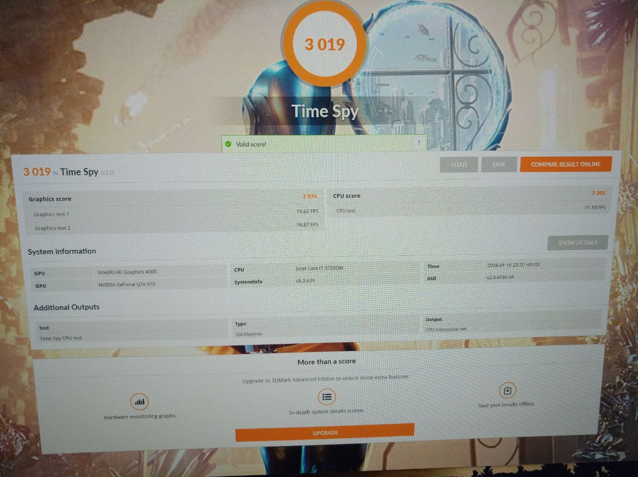

I finally modded my 2570p with an i7 -3720QM. Added a 50x50x4mm heat pad between heatsink and case and use Arctic MX-4.
Load temp after 10 minutes prime95 are 85°C on all cores and 86°C on CPU package.
For gaming I use a GTX 970 via GDC Beast in EC slot. DSDT override was necessary, nothing else.
3DMark GPU score - 2974
3DMark CPU score - 3305
Edited by SaxnPaule
I did new tests. Seems that I am maximizing at 100°C-102°C on full load with the 3820qm. Maybe I should repaste. Good thing is my CPU keeps full four cores at 3.4 Ghz (turbo 4c is normally 3.5Ghz), and almost don't throttle even at this high temps.  Fan is at 100%. I will try a shim and to repaste when I will have more time.
So I think you have good results.
