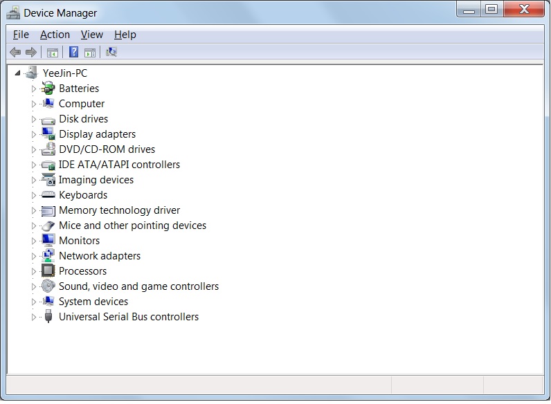

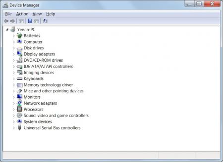

Sill no bluetooth i change my wlan (bcm4313) with ar9285 (ar5b95), i got mod bios 2.07
Hey nrosver, did you manage to figure out the bluetooth problem after flashing 2.07?
I face the same problem as you, after flashing mod 2.07, the Broadcom bluetooth card just stopped working. I can't even find it on device manager anymore.
