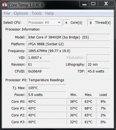

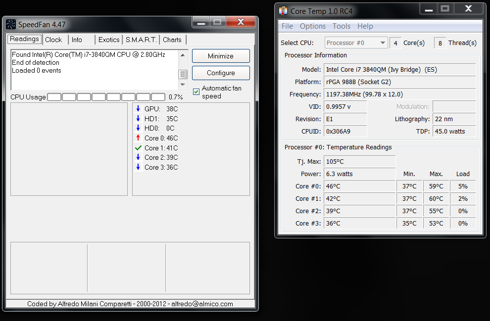

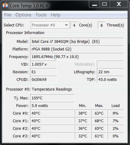

I'm not much of a science person, but how exactly does that aluminum tape mod work? At stock settings, my P150EM idles at 36C~45C. As soon as it starts doing work, it idles at 45-51C. Maybe its OCD but... I wanted to get it lower. (Max recorded temp was 86C at 100% load on i7-3840QM).
EDIT:
So I decided to try the mod anyway for aluminum foil. Got a nice drop in temps from the idle after work.

[ATTACH=CONFIG]5423[/ATTACH][ATTACH=CONFIG]5424[/ATTACH]
How much has the aluminum shielding essentially, improved your temps. A few C?

By 4-6C. You have to use very thin rows of aluminum tape, just enough to cover the gaps and then a bit more to make sure it sticks. Too much will do the opposite and start collecting more heat (in which you can feel from the backplate). So for now, I have literally no problems with heating.
EDIT: If you want, I can take a few snapshots of how I did it in case you want visuals.
