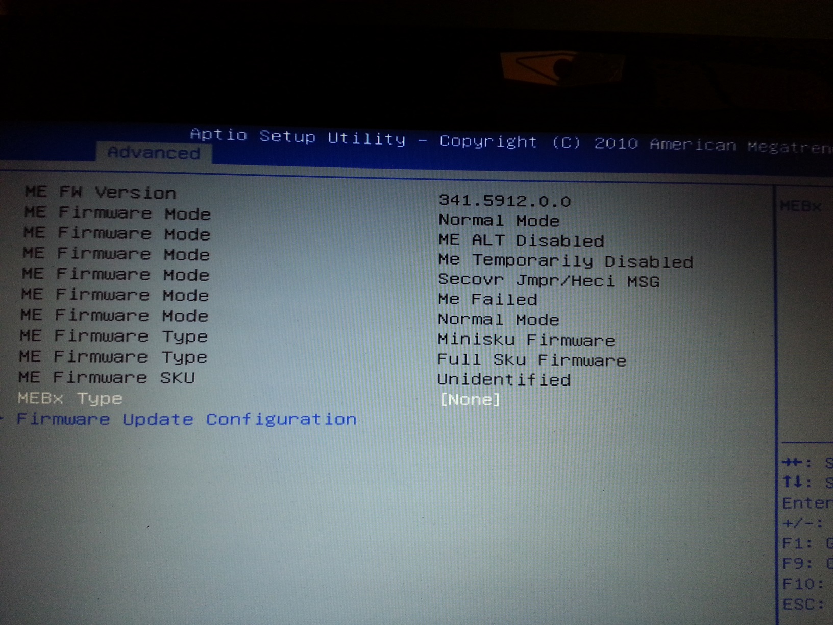

Moderator BAKED Posted November 11, 2013 Moderator Share Posted November 11, 2013 Lol, I flashed again and after restarting the system wouldn't post at first.. When it did I got a error message saying "End of post message to ME failed" I could enter the BIOS and I guess the ME was pretty messed up this time And I could not boot from anything to do a reflash. I ended up desoldering, programming and resoldering the chip again Quote Link to comment Share on other sites More sharing options...

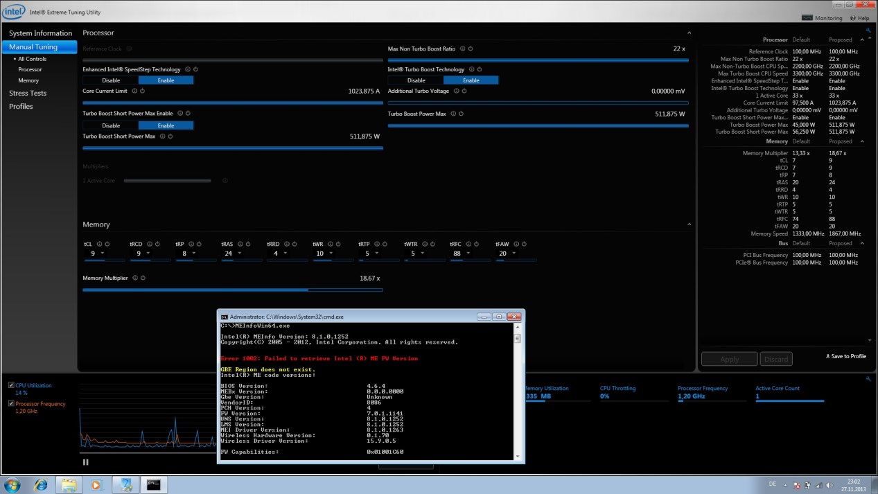

greg87 Posted November 28, 2013 Share Posted November 28, 2013 I had now the opportunity to test a ivy bridge in my system and as expected, it failed. After that I ran MEInfo and to my surprise it didnt update the fw. Seems to me that it updated some other parts. Thats probably why my system still booted. While it failed for others. I even included some new microcode in the bios. So sorry for the noise, though I really dont understand what went wrong as windows even detected new hardware after ME flash... Quote Link to comment Share on other sites More sharing options...

Tech Inferno Fan Posted January 1, 2014 Share Posted January 1, 2014 XTU BCLK adjustment -> what is it doing? Can we get Throttlestop to do it instead?Wondering.. has anyone debugged XTU to figure out what the BCLK over/underclocking code is doing? As XTU has been a bit hit-and-miss in terms of getting it installed and working it would be great if Throttlestop could be enhanced with BCLK adjustment instead. Quote Link to comment Share on other sites More sharing options...
Khenglish Posted January 1, 2014 Author Share Posted January 1, 2014 XTU BCLK adjustment -> what is it doing? Can we get Throttlestop to do it instead?Wondering.. has anyone debugged XTU to figure out what the BCLK over/underclocking code is doing? As XTU has been a bit hit-and-miss in terms of getting it installed and working it would be great if Throttlestop could be enhanced with BCLK adjustment instead.Adjusting bclk requires writing to the nvram section on the bios flash rom via me fw functions. It's a lot of work.For me installing xtu 4.0 or older with the mei driver installed always gets bclk working. Quote Link to comment Share on other sites More sharing options...
Tech Inferno Fan Posted January 1, 2014 Share Posted January 1, 2014 Adjusting bclk requires writing to the nvram section on the bios flash rom via me fw functions. It's a lot of work.For me installing xtu 4.0 or older with the mei driver installed always gets bclk working. Strange. MEI interface driver doesn't appear with my i7-3740QM. The CPU does supposedly have VPRO support. First, big thanks to Khenglish for modding the ME FW for me! I didn't think there would be any chance of overclocking my machine (HP Elitebook 2570p) but I was wrong! Here's the detailed info on how to flash and were to get the modded BIOS. So after flashing I still couldn't see the reference clock slider in XTU. So, I reinstalled it a few times and eventually used one of the older versions. Dunno what exactly did the trick, maybe an older version, a number of reinstalls but it got unlocked in the end! Previously the CPU was locked at 38-39W and 3.4ghz on all cores, but as you can see from the screenshot below it can now hold 3.55Ghz @40W and 104.8BCLK!!! Am in the same boat. Flashed the 2570P BCLK ME overclocking firmware and afterwards the BCLK slider disappeared. Tried installing XTU 3.1, 3.2, 4.0, 4.2. None making it reappear. There's talk in this thread that the BIOS itself has XTU-enabling flags. I'm running 2570P F.42. Can you advise what version of bios you have on yours? UPDATE: What I've discovered it that flashing the supplied 2570P overclocking ME firmware at http://forum.techinferno.com/hp-business-class-notebooks/2537-12-5-hp-elitebook-2570p-owners-lounge-12.html#post65904 broke my ME firmware. The alarm was raised when the ME 'key' system tray icon failed to appear. I then went into my BIOS doing a 'reset bios defaults' and 'unconfigure AMT'. After which my system rebooted with a ME FW error. I then flashed back my original ME and re-tried those changes in BIOS and now the 'unconfigure AMT' did boot and give a "unconfigured ME" type bios message which was reassuring. In addition, XTU 4.x now once again has the reference (BCLK) slider appearing BUT is grayed out. Wondering if the system's own ME firmware must be modded rather than using a pre-modded one from someone else even if they are the same system? Quote Link to comment Share on other sites More sharing options...
