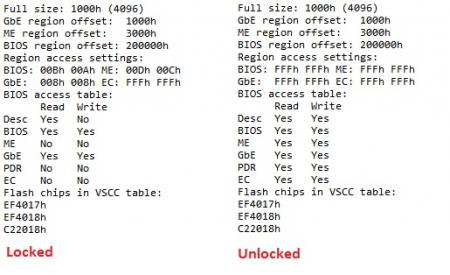

I think the only way to unlock the flash descriptor (by software) and flash the ME region is by utilizing the "BIOS emergency recovery" -method (changing those HEX), as stated in blowntaha's post earlier.
For our system you have to put the BIOS under C:\ and rename it G46VW.BIN  and turn off the system, then  HOME (hold) + CTRL (hold) and Power (push once)
When it's booting up, keep holding HOME + CTRL, and it should look for the BIOS and "recover" your system.
If you're willing to test it, please report back. Thanks again!

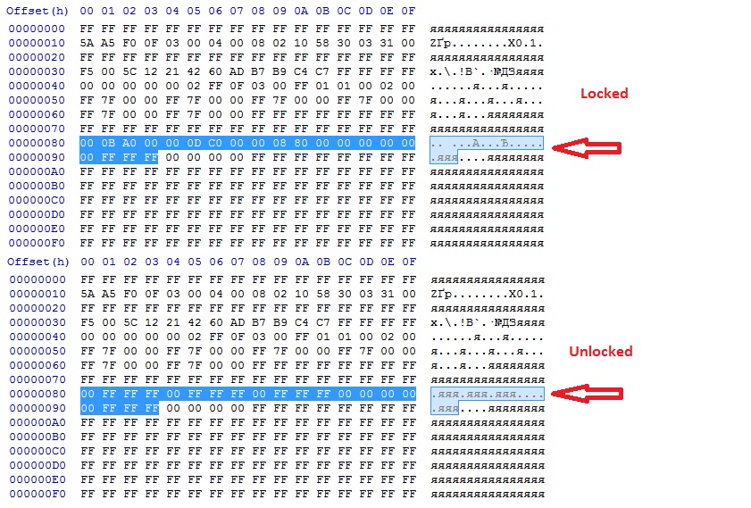

EDIT: Make sure you made the HEX changes in the earlier post. We need to unlock the flash descriptor in order to change stuff such as voltage and BLCK for the CPU and system.
Edited by jacobsson

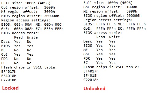

For unlock descriptor you need change some values in file bios 8Mb. Use any Hex editor. How to do it you can see on the previous page, post from blowntaha  . Just see at him picture. Then flash prepared file with a programmer. If you already have SOIC clip, you can flash without desoldering the bios chip.
Edited by Klem
1 hour ago, Klem said:
For unlock descriptor you need change some values in file bios 8Mb. Use any Hex editor. How to do it you can see on the previous page, post from blowntaha  7 Nov 2015. Just see at him picture. Then flash prepared file with a programmer. If you already have SOIC clip, you can flash without desoldering the bios chip.
Cool, thanks Klem!
Gonna test my programmer setup and make a couple of full 8MB dumps and compare the checksum.
I'll report back when I had the time, hope fully tonight!

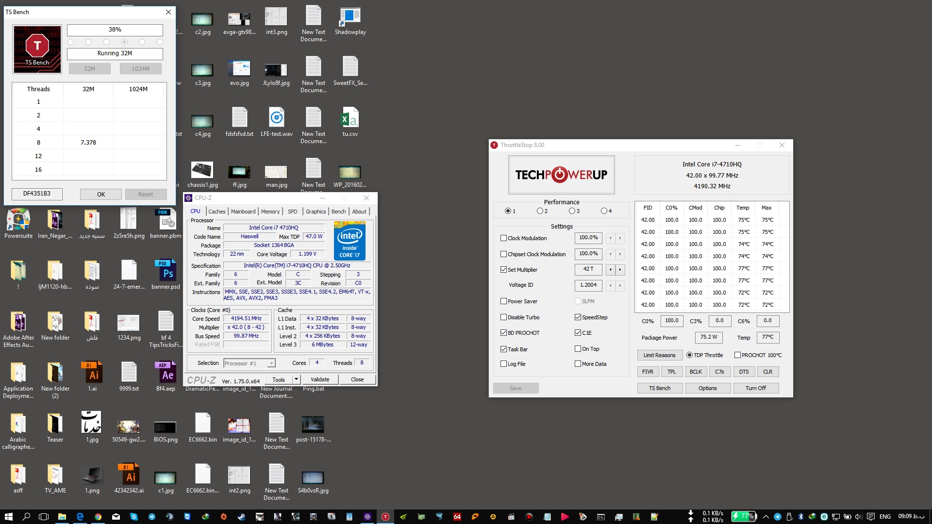

Hello guys, I've followed dufus own research and I've managed to unlock my Haswell mobile CPU (i7 4700HQ).
I did a quick test run and I was able to do 4200MHz (x42 multiplier), by default, the CPU is supposed to overclock only 3.4GHz  on all cores.
At first attempt the CPU crashed, so I went back into Throttlestop and adjusted the core offset voltage +100mV just to stay safe.
The only issue for now is how to keep the little beast cool, it jumps pretty quickly over 95 degrees celsius.
So, the puny bclk margin we were able to achieve looks now pretty obsolete for Haswell mobiles, if we can do the overclocking as we should only from multiplier. :)
The 4GHz validation is here:
http://valid.x86.fr/ie08cd

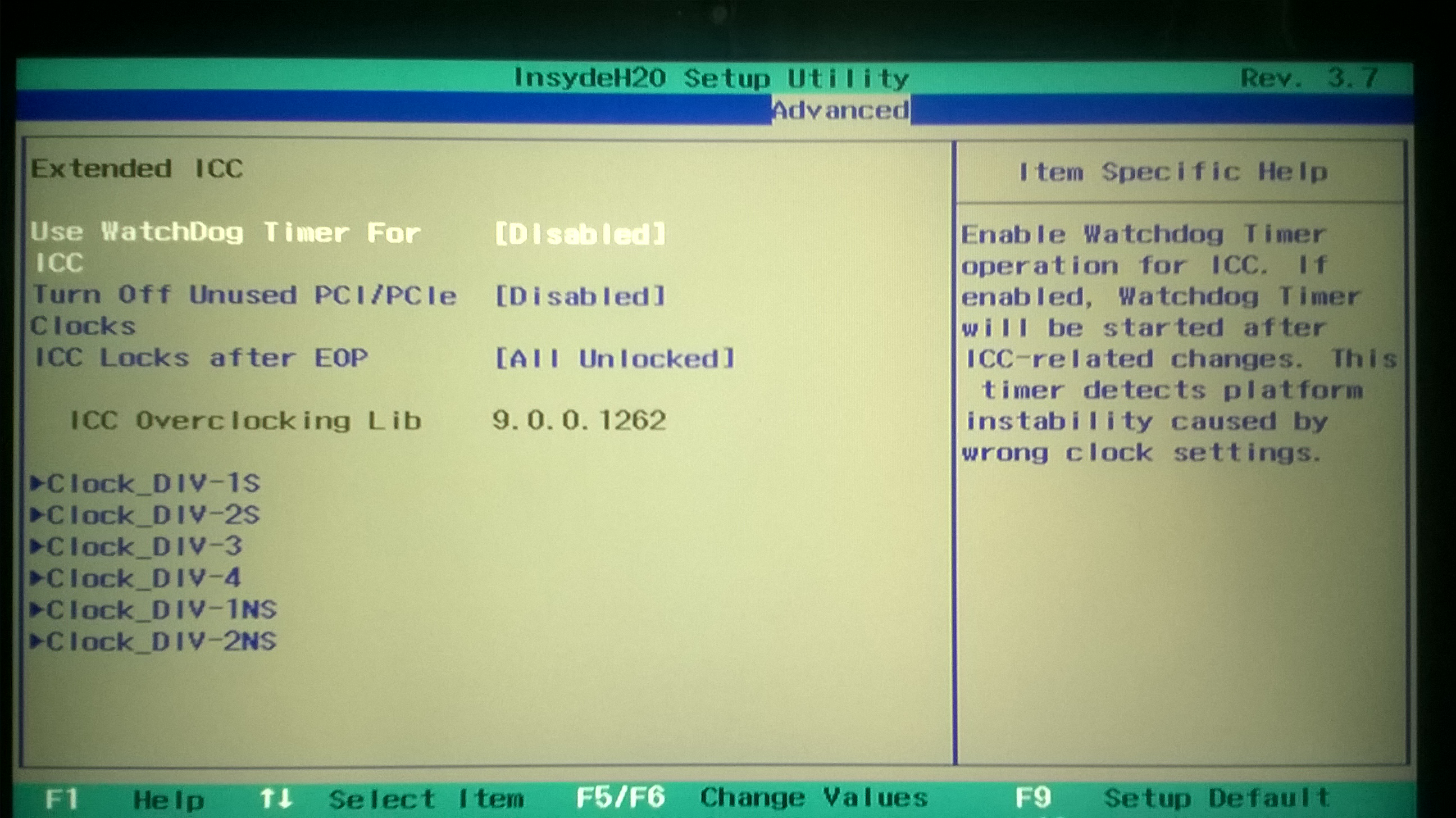

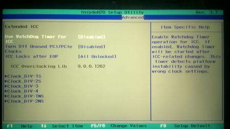

I have Lenovo Y50. i can able to read Me (via bios "ME Image Reflash" ). could help me unlock more multiplier and BCLK?
Here my ME and Full Dump (Bios+Me+Desc): https://www.sendspace.com/file/lfgw9d
i can also to enable --> ICC Locks after EOP [All Unlocked] in BIOS.WP_20160206_20_19_54_Pro.thumb.jpg.7a8fb
Edited by EDk-TheONE

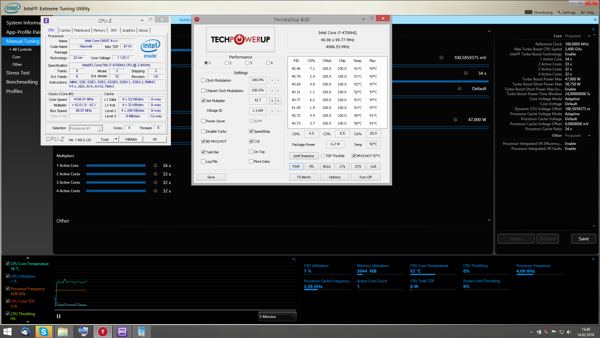

Ive tested with 06 microcode and that only allowed me to go 36x on all 4 cores at the same time. (By default 4700hq/mq can do 36x only on a single core).
Still a nice improvement of +200MHz, but if you want more you will have to go with a lower version.
Cant remember if those +200MHz can be used from XTU or you still require throttlestop.

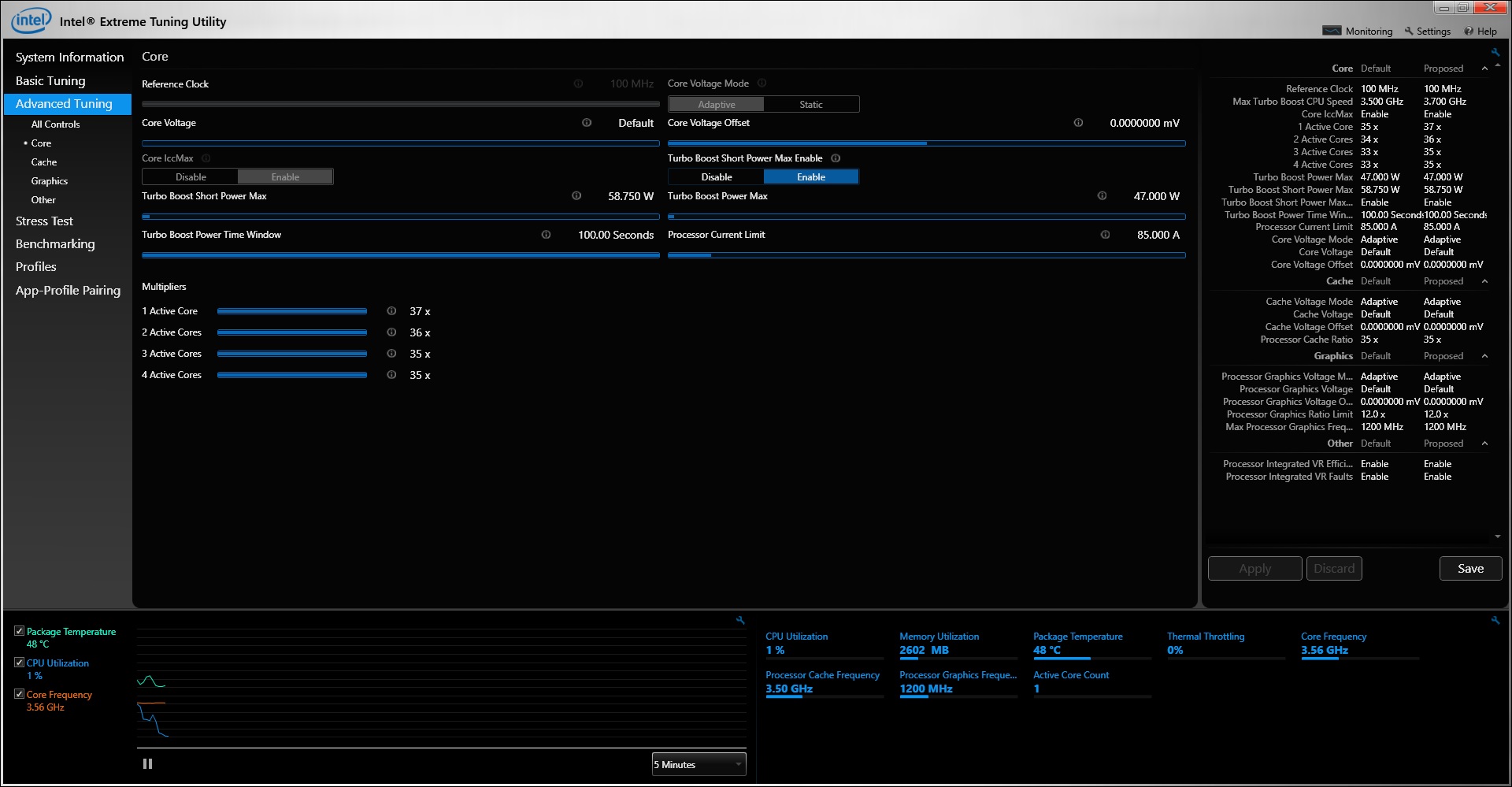

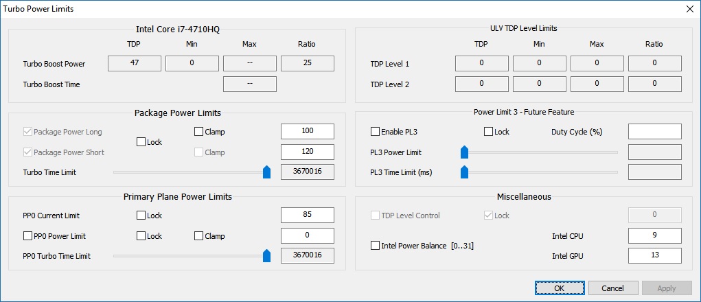

Can I ask one thing - how did you guys manage to overcome the 47W TDP limits? I've downgraded my microcode to 02 version, but it doesn't really cooperate. I'm able to set the multiplier to 42 or even higher, but it only maintains this for two cores because for 4 it just throttles down to use exactly 47W. I've messed around with TPL settings and power limits in the BIOS but it still doesn't really care about the limits I chose.
my bios modded and i can enable package power short/long TDP/Time Window.
Just now, Ultrax5 said:
My BIOS is also unlocked and I can also set the limits, but even after setting it up like on your screenshot it seems to just ignore it. Btw, what version of microcode update did you use? 02, 01 or a different one?
01 version.
55 minutes ago, EDk-TheONE said:
01 version.
Tried 01 one, disabling MSR locks in BIOS, setting the limits inside the BIOS or via TS and it still only hits 58W which is only sufficient for a maximum multi of 34. I don't even know what's wrong with my setup now. :/
58W is a value that implies that the cpu is in full load, or at least stressed with something.
At first you should try only raising the multiplier and validate the frequency.
After you do that you can switch back to the tdp rating?
What laptop do you have? What is the temperature when you have 58W in load?
