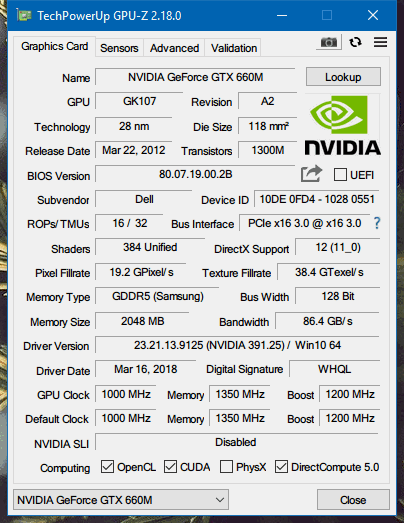

UPD2: Uhm... vBIOS 144032 works with my GTX 660M after 2 or 3 reboots... What's happening? So... it works. But it's unknown for me why doesn't OC version work properly. I even paid for taking access to it. Any ideas guys?
The second surprise. After reinstalling GHz OC edition i got my videocard working properly.
Spoiler
The only thing I've changed was UEFI > UEFI + Legacy boot mode. It doesn't relate any hardware (but it does as you see).

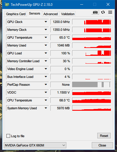

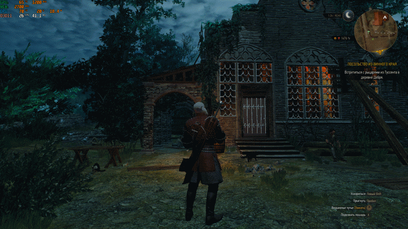

On the second screenshot you can see successful rendering (I've played The Witcher 3):
Spoiler
Aaaand... here we go - proof of working:
Spoiler
My problem really existed because I used fast boot, that GHz edition doesn't support:
