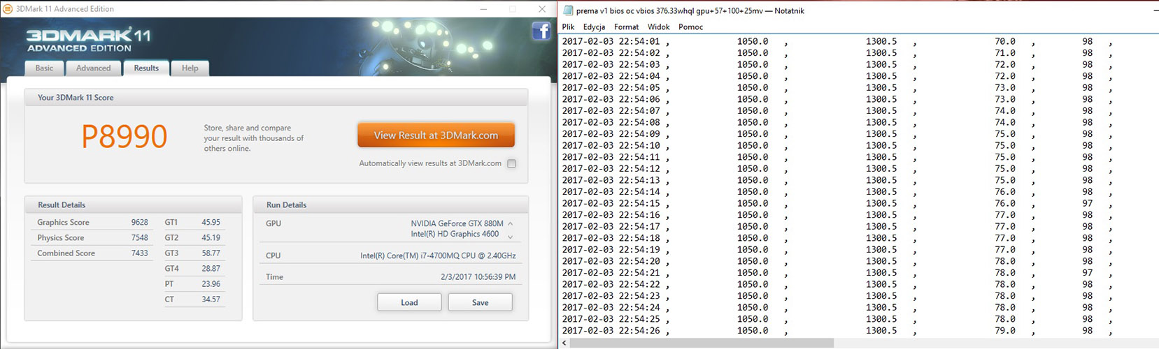

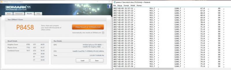

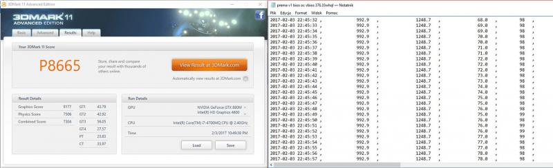

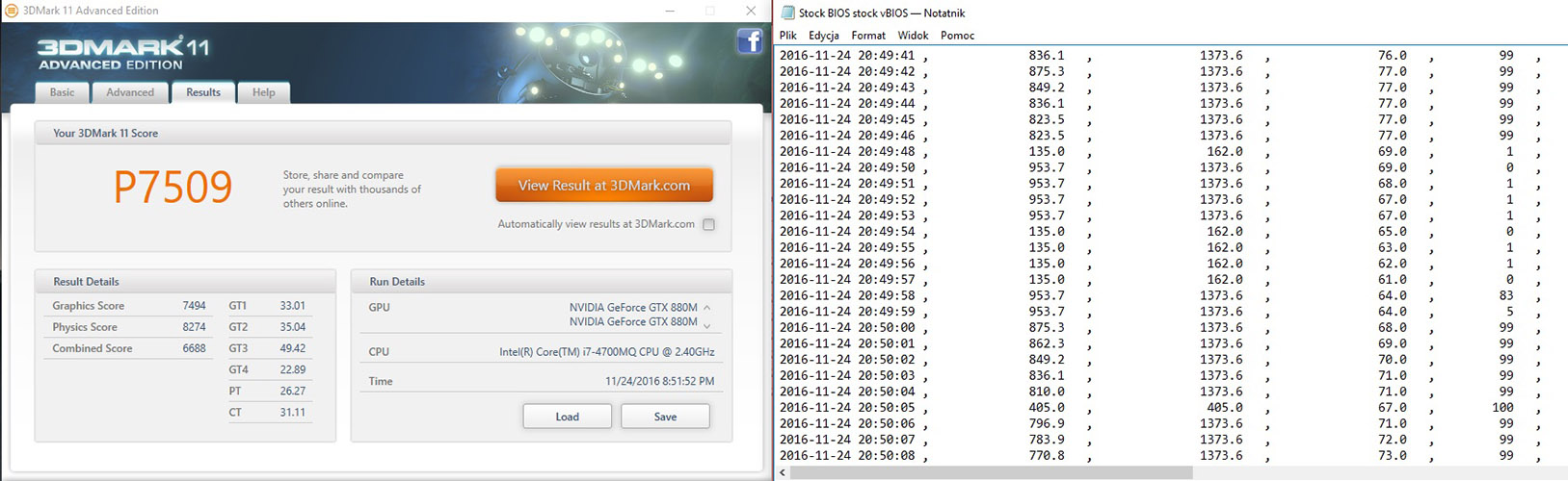

Indeed, I have updated BIOS (well truly it is downgrading...) to Prema mod v1 from the page you gave me https://biosmods.wordpress.com/p157sm/ and after that I did some tests using 3DMark11 and The Witcher 3. The results? Just G-R-E-A-T no more fps drops, temps the same. It seems that Clevo with BIOS update - dunno which one - broke support of GTX 8xx series, probably for better support of 9xx series.
Here are some results before and after specific prodedures:
1. Stock BIOS, stock vBIOS:

2. Prema v1 BIOS stock vBIOS:
3. Prema v1 BIOS oc vBIOS:
So all in all if anybody has CLEVO and his experience with GTX 8xx series is the same as mine with unknown fps drops, then first of all look at your BIOS version. Prema mod v1 is based on 1.03.03 Clevo BIOS and it's working perfectly with GTX 880m 8GB, originally I had 1.03.09 BIOS which was like a nightmare for this GPU.

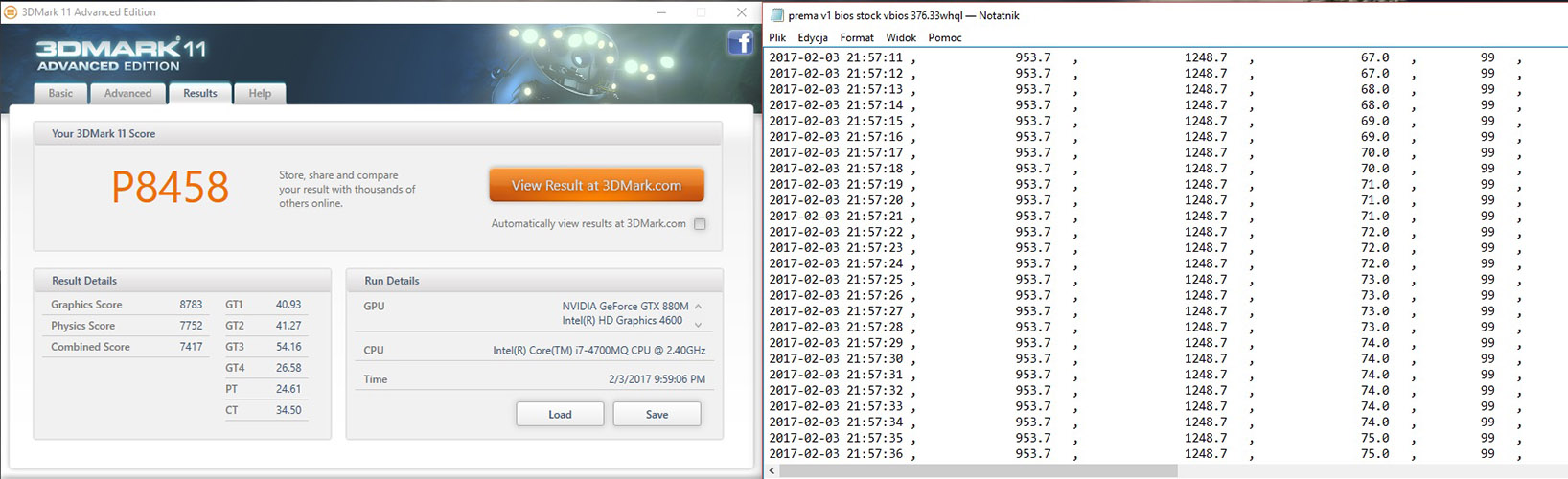

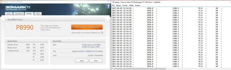

4. Prema v1 BIOS oc vBIOS + little oc
