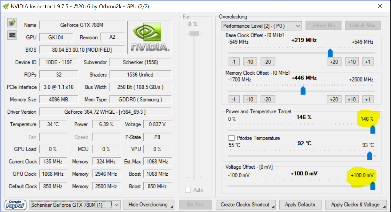

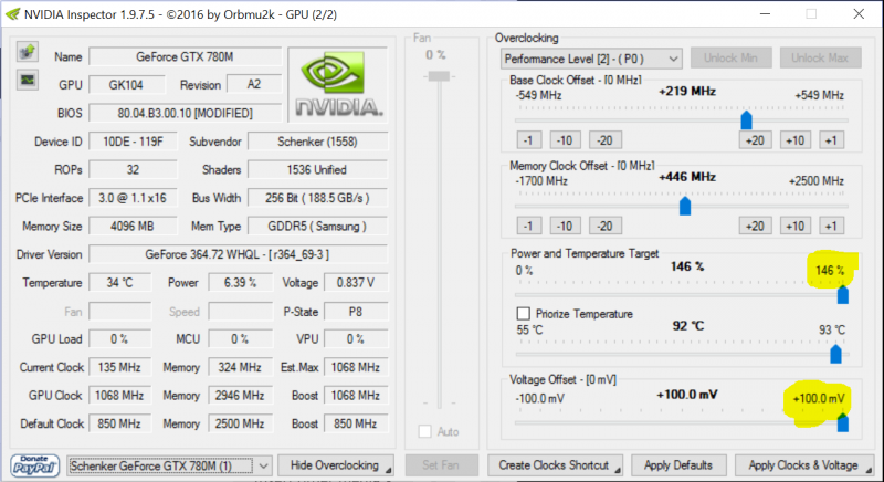

Dear @Prema
I already flashed the @svl7 vBios it's working fine up to now, but I have a limited Power and Voltage, how can I get more, please see the attached pictures comparison between the svl7 settings and my settings.
When I apply this OC settings and start some games like Far Cry 4 the temp go fast to reach 90~93 is this normal?
Regards.
Edited by Dr. AMK
On 3/30/2016 at 7:07 AM, Dr. AMK said:
Dear @Prema
Regards.
I will try and explain this the best way I can.  First of all if you are hitting temps like that just playing games like Far Cry 4, You need to re-think and re-evaluate your overclocks. Your system should not hit 93C as with that temp it is probably thermal throttling to protect itself from being fried. So go easy with the overclocking, no need to push it so hard for no good reason.
As for your other inquiry about the additional voltage, that is a "no go bro", for 2 reasons, firstly most cards are meant to be running at certain voltages, anything passed the amount given unlocked is what you can push it to, anything past that the card will not boot. Atleast that is as far as my experience goes with AMD cards, im pretty sure Nvidia is the same. Second reason, Your already producing an excess heat amount, more voltage = more heat = more thermal throttle ~= less performance.
My recommendation for overclocking, go from stock clocks increase by 50 mhz at a time, run a benchmark, temps should be the same on average. if it fails, increase voltage slightly. check temps again, make sure they are within the threshold.
The voltage and power range visible in the picture is probably from earlier times when that program was probably not reading it correctly or something. Either way, you dont need more voltage, you have enough heat. do what i mentioned above.

1st of all thank you ( TheCodeBreaker) and (Mar7aba xD) for your kind reply and explanation, I found that the temp hit the 90's only on 4K settings of that game, but with 1080p it's almost hit <80, so I think the 4K settings with my 780m SLI overclocked is the only problem, otherwise the svl7 vBios is perfect and it gives me more power for all my games.
