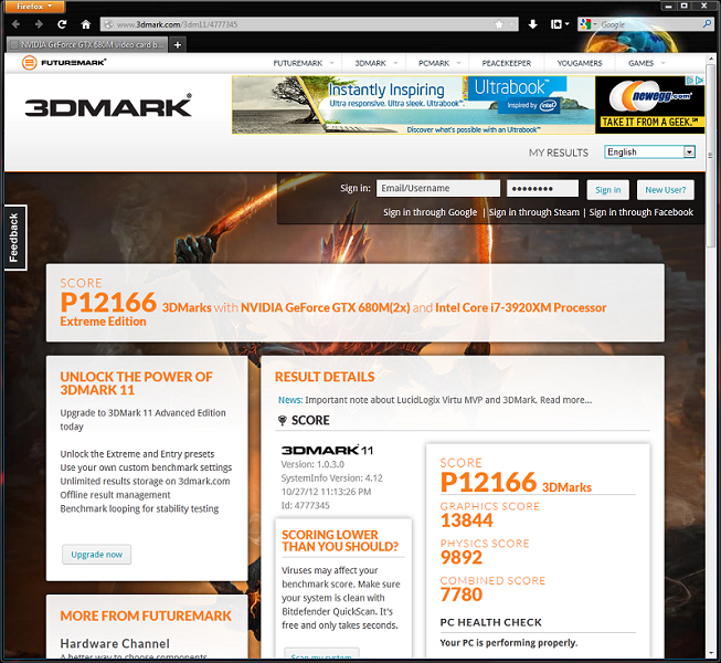

Well I have some good news and some bad news to share.
The good news is that I gave svl7's ROM's a try, and found the 850 base ROM the most effective - all the others either booted with the 680 at stock 719 speeds or would throttle under load. I don't have an unlocked system BIOS, and it seems that is what's holding me back, because if I could tweak the frequencies in software I know I could push it closer to 900 without throttling.
The end result is that with an easy 4.3 OC on the CPU and 850/1200 on both GPU's I was able to break 12K on 3DMark11 scoring P12,166:
