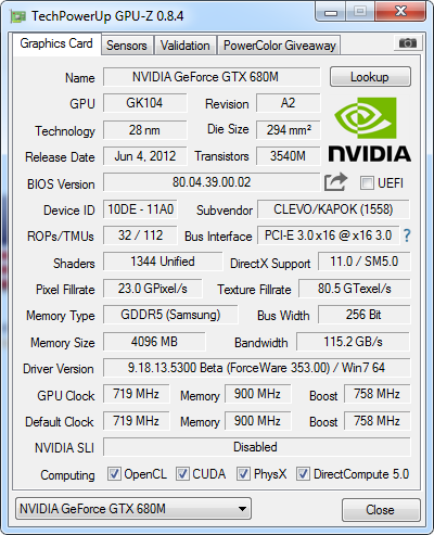

alkiviad Posted July 10, 2015 Share Posted July 10, 2015 What vbios i must use for Clevo P150EM? I have MSI GTX 680M 4gb (green textolite card).... flashed with "Clevo" vbios v.80.04.39.00.02 i think. Quote Link to comment Share on other sites More sharing options...
