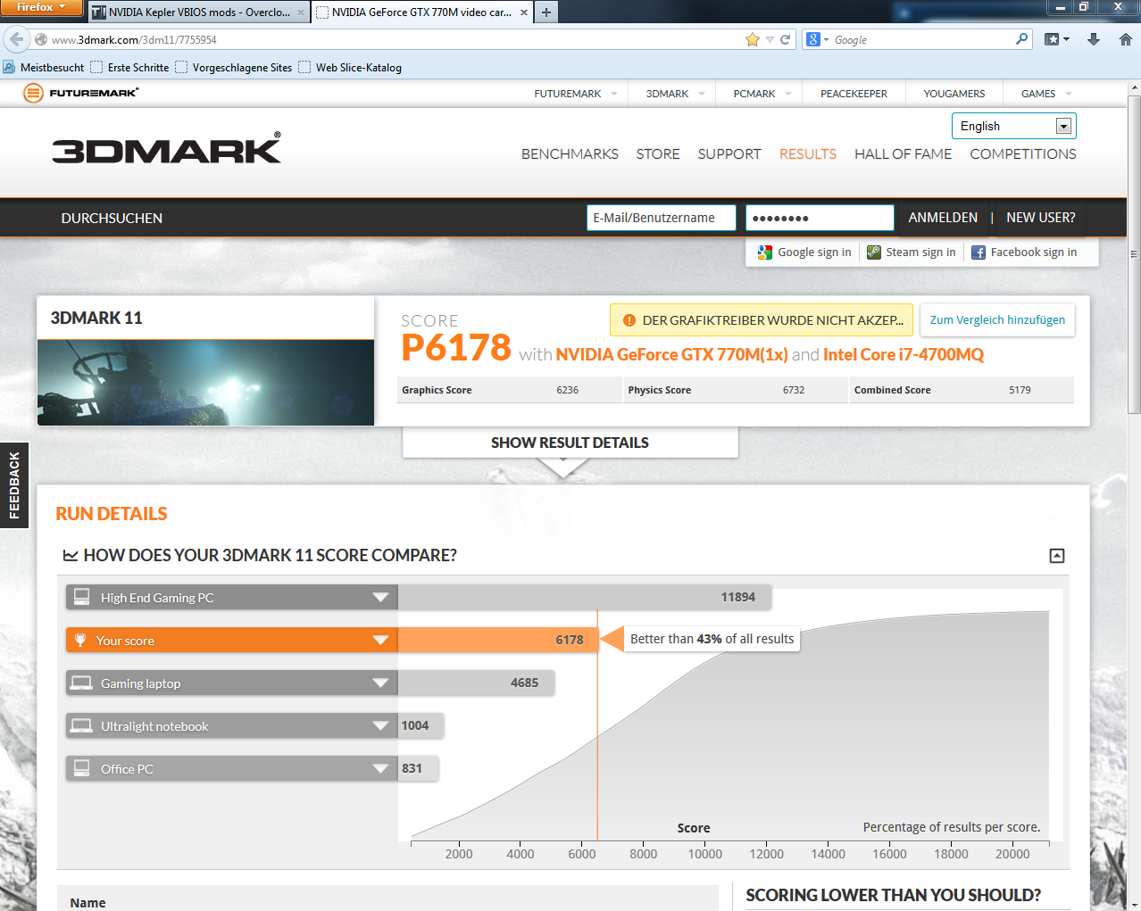

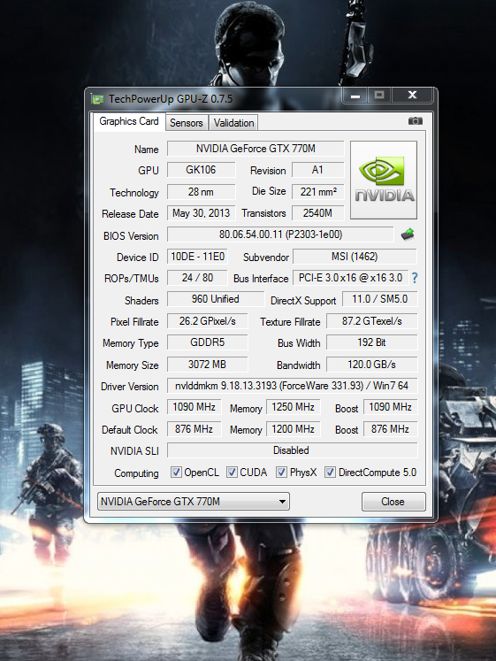

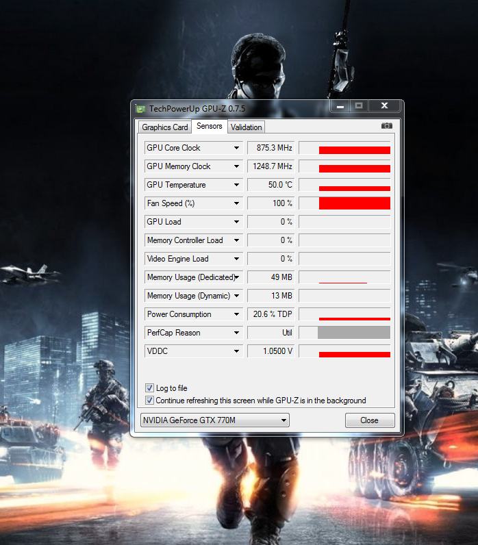

Here are my overclock settings from my gtx770m. For everybody who is interested in overclocking his gtx770m. :)
PS: I'm not responsable for any damage on your vga-card!
for me this settings are stable ;)
my temperatures are never over 75 Celcius

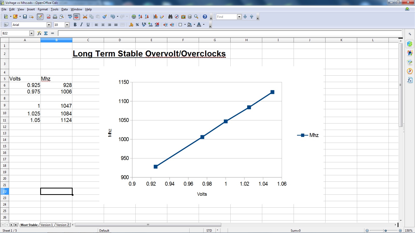

The attached pic are the long term gaming stable overvolts & overclocks that I can achieve - interesting that it's a linear relationship.
