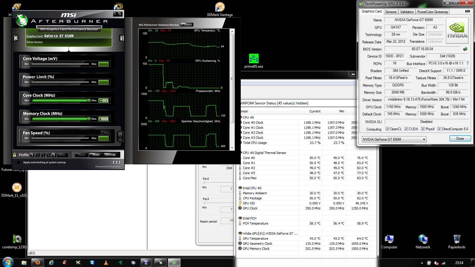

deadbydawn Posted July 17, 2012 Share Posted July 17, 2012 @svl7 there you go dude 1 Quote Link to comment Share on other sites More sharing options...
svl7 Posted July 17, 2012 Author Share Posted July 17, 2012 Hahaha, awesome! And if you set the core to something like 200, it goes to this clock? 1 Quote Link to comment Share on other sites More sharing options...
deadbydawn Posted July 17, 2012 Share Posted July 17, 2012 yeah it does, just tested it 1 Quote Link to comment Share on other sites More sharing options...
svl7 Posted July 17, 2012 Author Share Posted July 17, 2012 Oh yeah! HAHAHA! Fantastic! 1 Quote Link to comment Share on other sites More sharing options...
