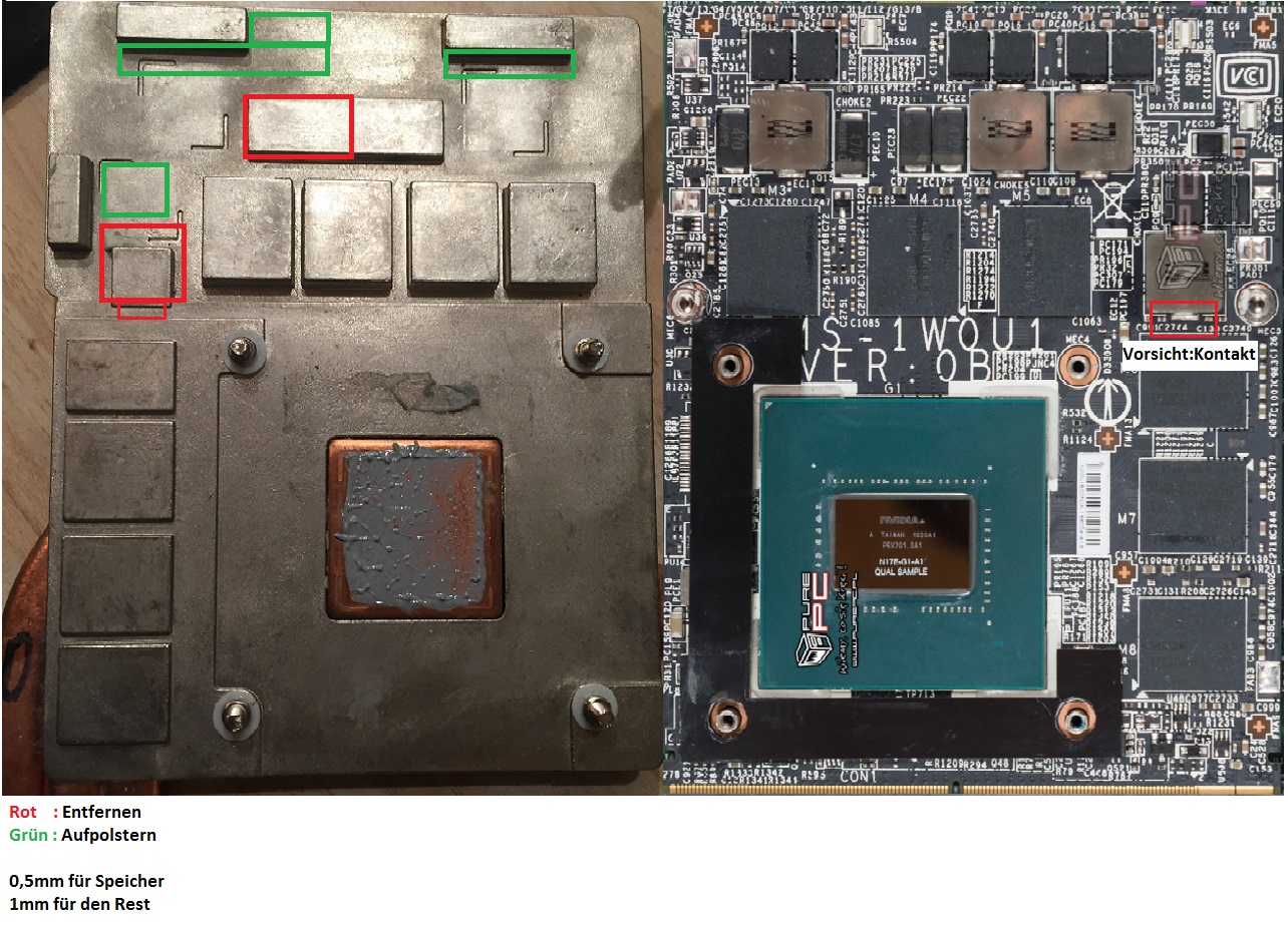

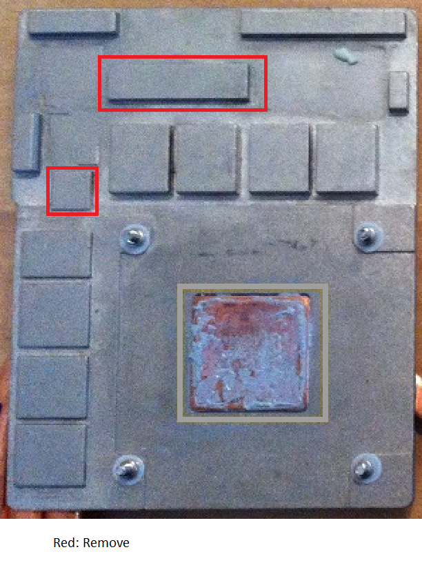

senso Posted February 12, 2017 Share Posted February 12, 2017 You will need a GT72 VR cpu and gpu heatsink, but the 1070 is a drop in replacament, works out of the box with just the latest(pretty old actually) BIOS , just be sure to get a non G-SYNC model and its plug and play. Quote Link to comment Share on other sites More sharing options...
Bloetschkopf Posted February 12, 2017 Author Share Posted February 12, 2017 You also can modify Your Old GPU Heatsinkfor it,is not somuch work. Quote Link to comment Share on other sites More sharing options...

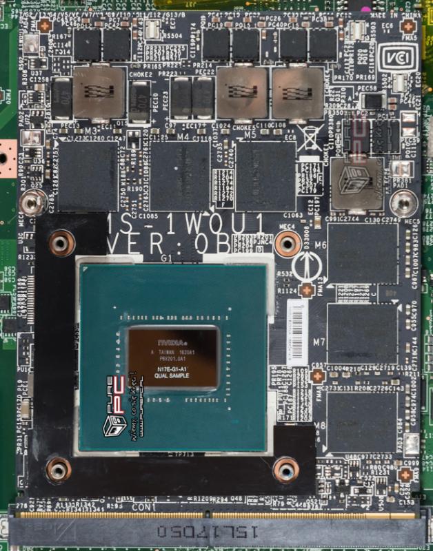

Bloetschkopf Posted February 12, 2017 Author Share Posted February 12, 2017 The GTX 1070 is MXM Standart Size,but it have a second Conector for Powersupply. But they have also other interesting Cards like GTX 1050 ti. Quote Link to comment Share on other sites More sharing options...
senso Posted February 12, 2017 Share Posted February 12, 2017 11 hours ago, Bloetschkopf said: You also can modify Your Old GPU Heatsinkfor it,is not somuch work. You gain another heatpipe with the newer heatsink, but yes, its an easy mod to do. No, the MSI 1070N does not have any extra power supply connector, its just a plain MXM3.0b connector, no more, no less. Quote Link to comment Share on other sites More sharing options...
Bloetschkopf Posted February 12, 2017 Author Share Posted February 12, 2017 The GTX 1070 on aetina have a second connector for it,the GTX 1070 from the Zotac Magnus don`t have it. Quote Link to comment Share on other sites More sharing options...
