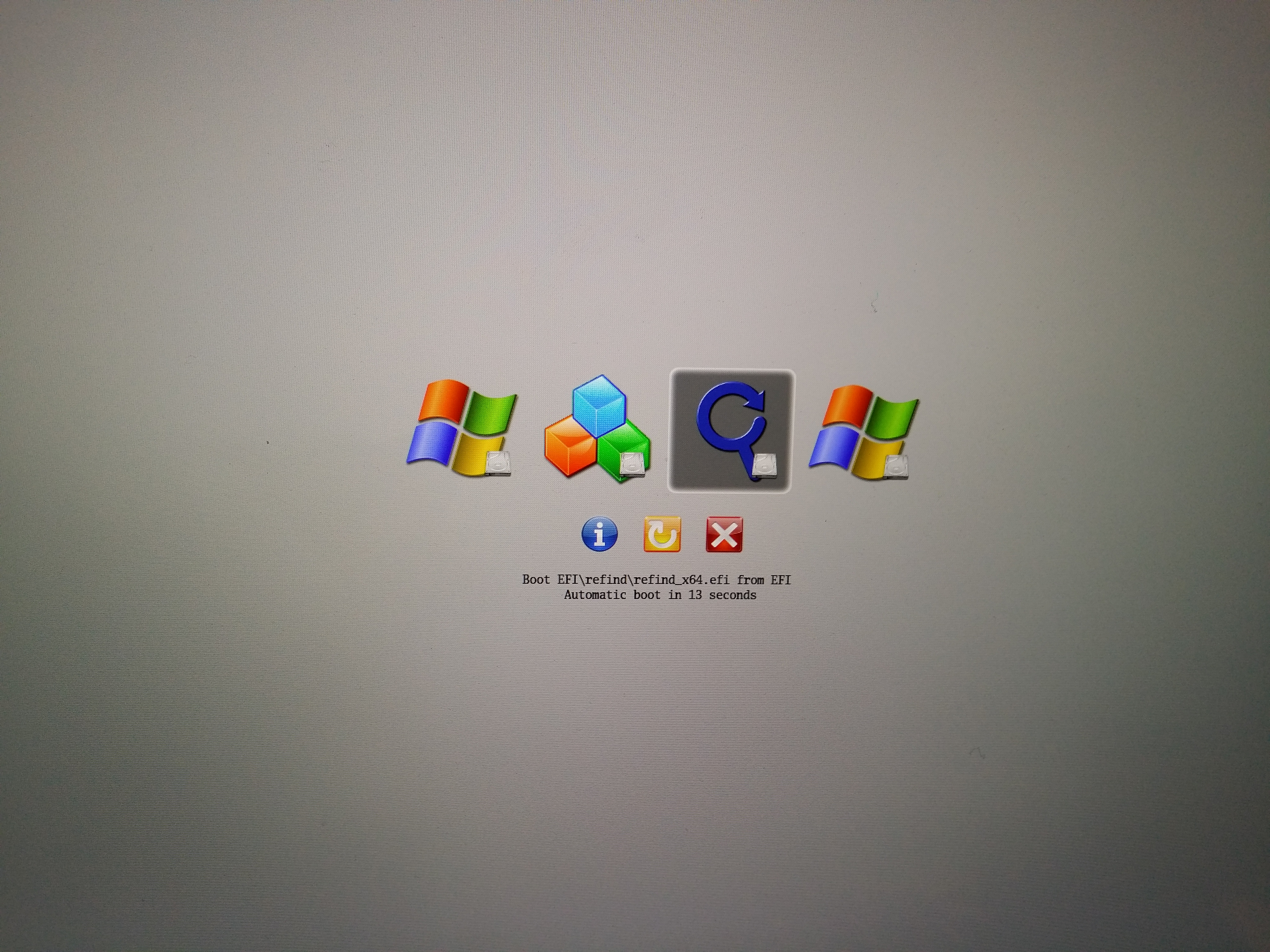

I have tried your solution on windows 8.1 internal display with Optimus, however Step 4 and 8 is different. It's working right now with internal display on Windows 8.1.
What I did:
First I followed all the steps, but when I am up to 7, it didn't restart with the boot menu. Even if I tried holing option when rebooting it was Apple reboot menu, but with black background. Therefore, I restart the solution from 1 again, this time I skipped step 4 ( I didn't delete the refind folder), and this time it reboot with the eFind boot manager. However, when I pressed the GRUB boot, it said abort, therefore cannot finish step 8 (photo 2). In conclusion I can run internal display in windows 8.1 but with skipping step 4 and 8.
Another problem is the "?" in boot manager, it is always ? when reboot, however when I select ? and enter, it will load and change to apple. post-29815-14494998666402_thumb.jpg(photo 1)
P.S. I am using Mac 10.10. Mid Macbook 2014 13 inch Retina Irish Model
Hi. Thanks for the info. I am away from home this weekend. But I have some updates files and included a cleaner more Mac theme and a revised step guide I will post up when I'm back. I edited the grub configure file to enable direct boot into Bootcamp automatically now. And removed all unneeded code. Literally all that is needed is the apple_set_os in the grub.cfg to enable igpu at boot. How simple!
From your errors. I believed I have missed a step as the folder structure has changed the boot file needs the bless command issued again in terminal. Sorry about that.
