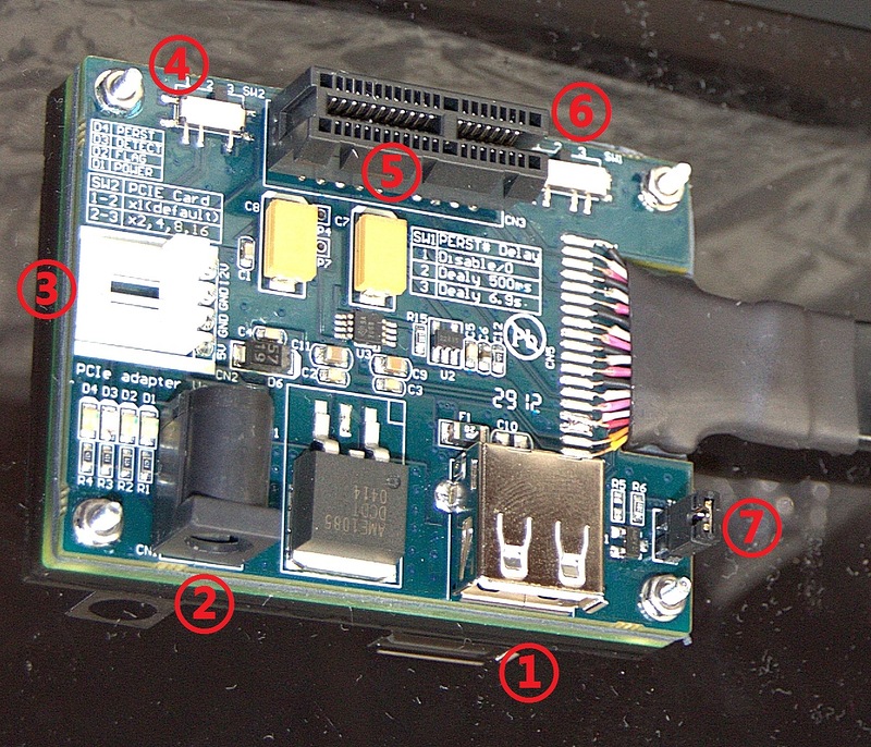

2. Is now anywhere some reference/user manual for the egpu board? When i bought it i was only able to get the datasheet
I'm particularly interested about switch 4 and 6, from what i understand switch 4 is a PCIE x mode switch, and switch 6 is a bios delay switch, but what are the values on them?
I have also seen some setups which were maybe using the USB port to power the eGPU, is it actually possible, howto achieve this if possible?

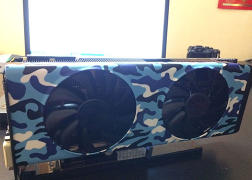

Thanks in advance and for your time heres a photo of my project :D
[ATTACH=CONFIG]12400[/ATTACH]
