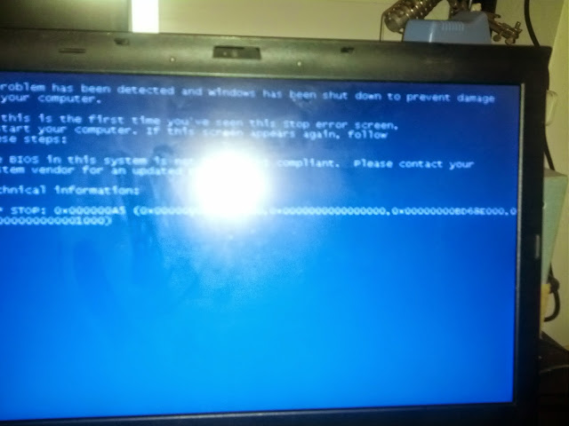

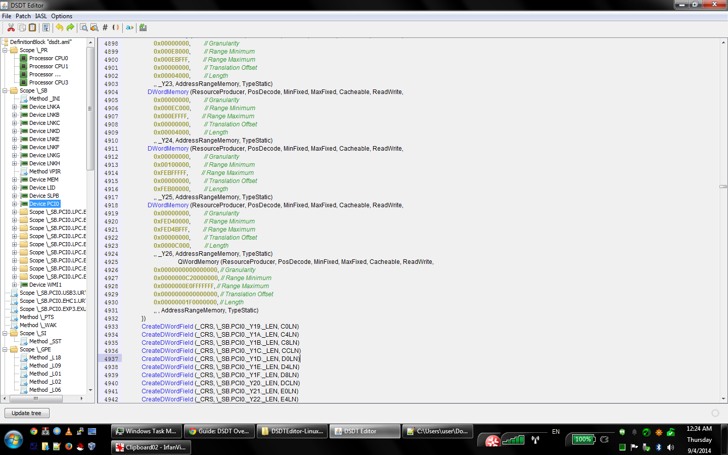

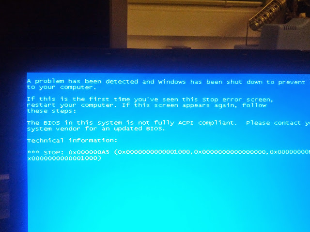

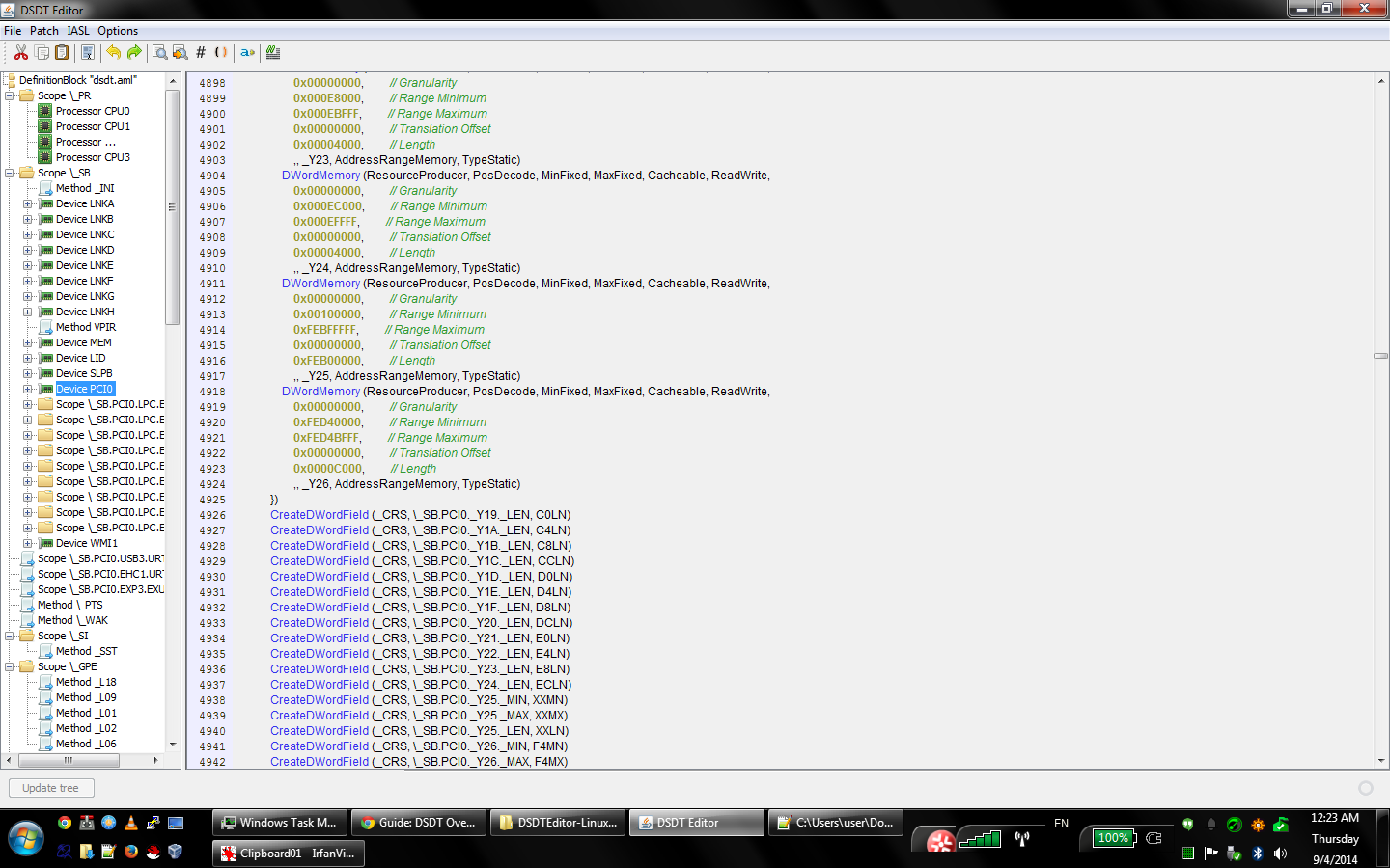

Hi, thank you a lot for the simplified guide! Unfortunately its not working for me and I'm getting blue screens each time i load the settings and restart, screenshots and vid below. I don't know what em i doing wrong, I'm following the guide to the letter. For the first time i was checking the copy pasted code and added spaces since they were missing, no luck for the second time i just copy pasted the code, compiled it, fixed the errors ,exported it and loaded but again same issue. Please find my dsdt.dsl file as well with the screenshots of the bluescreens attached. To make things simple, you can find below how it looks like when i copy paste the Qword, i guess i either overlooking something or that its not possible to run the override on the lenovo as per the BSOD statement. DWordMemory (ResourceProducer, PosDecode, MinFixed, MaxFixed, Cacheable, ReadWrite, 0x00000000, // Granularity 0xFED40000, // Range Minimum 0xFED4BFFF, // Range Maximum 0x00000000, // Translation Offset 0x0000C000, // Length ,, _Y26, AddressRangeMemory, TypeStatic) QWordMemory (ResourceProducer, PosDecode, MinFixed, MaxFixed, Cacheable, ReadWrite, 0x0000000000000000, // Granularity 0x0000000C20000000, // Range Minimum, set it to 48.5GB 0x0000000E0FFFFFFF, // Range Maximum, set it to 56.25GB 0x0000000000000000, // Translation Offset 0x00000001F0000000, // Length calculated by Range Max - Range Min. ,, , AddressRangeMemory, TypeStatic) }) CreateDWordField (_CRS, \_SB.PCI0._Y19._LEN, C0LN) // _LEN: Length CreateDWordField (_CRS, \_SB.PCI0._Y1A._LEN, C4LN) // _LEN: Length CreateDWordField (_CRS, \_SB.PCI0._Y1B._LEN, C8LN) // _LEN: Length CreateDWordField (_CRS, \_SB.PCI0._Y1C._LEN, CCLN) // _LEN: Length CreateDWordField (_CRS, \_SB.PCI0._Y1D._LEN, D0LN) // _LEN: Lengt Full data with screenshots below [ATTACH=CONFIG]12396[/ATTACH][ATTACH=CONFIG]12397[/ATTACH] From eGPU -
