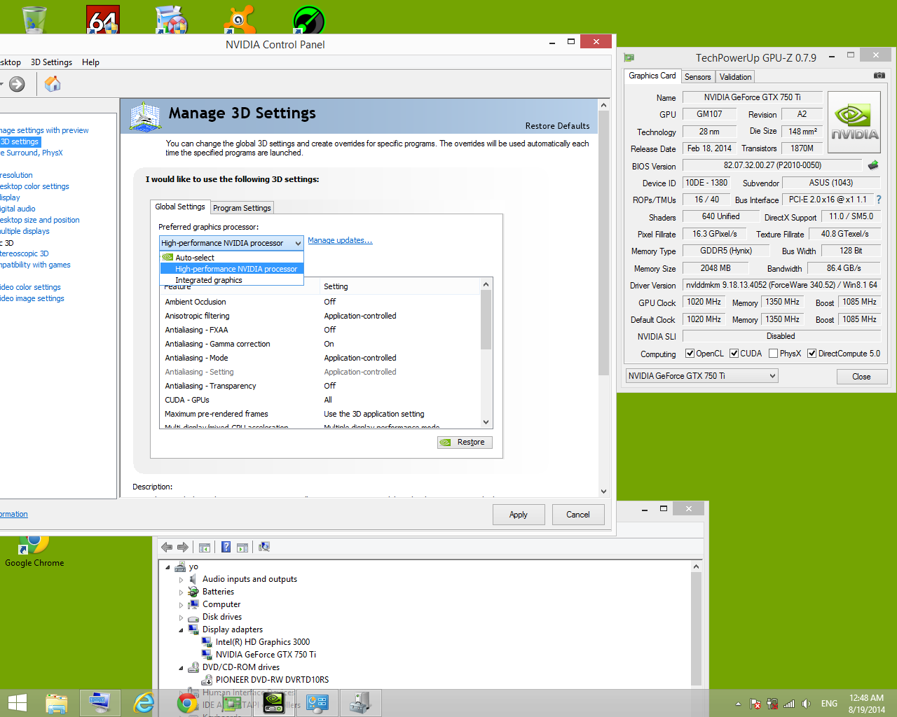

Need help setting up an EXP GDC v.8 + GTX960 for internal display use
dan replied to Uuugz's topic in DIY e-GPU Projects
you will not see two display in the optimus internal screen,only you wil have a transparent option in the nvidia control panel wich alows to use egpu as a preferred render graphics- 46 replies
The 740m need to be eradicated from the displays manager list,you have to see only the igpu and the egpu there. There is two ways to do that,disable in bios or use x1setup provided by ******. Sincé none of them is available for you you coud try to disable the pcie that host the gt740m,not the card but the pcie bus that host it in the system device. Works for me few times. i see you are mod the driver,guess there is no need for that,once you achieved that the system not see the dgpu,you could install the egpu driver without mod.anything.- 46 replies
