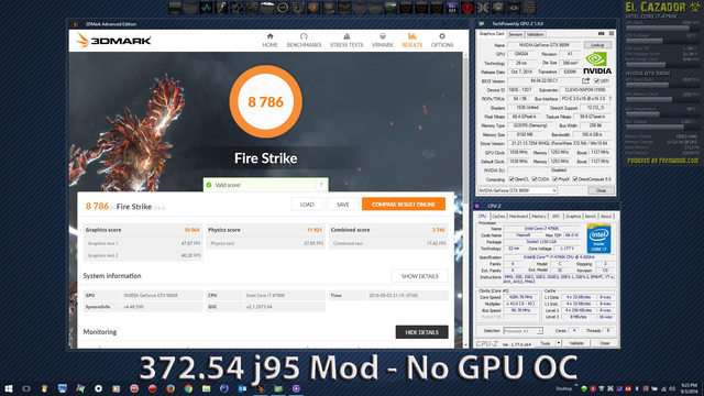

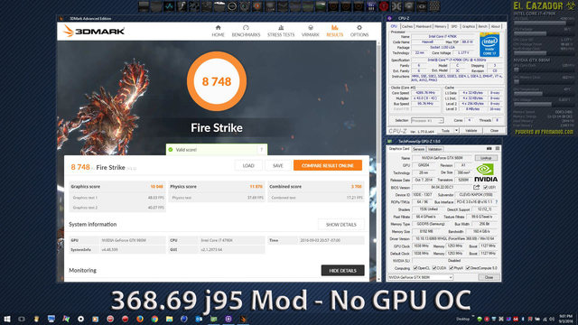

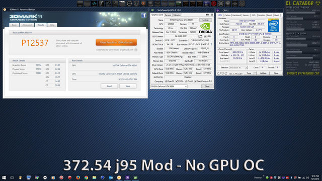

Guest Posted September 4, 2016 Share Posted September 4, 2016 As usual, great job Nephew @J95... comparison of 3DMark 11 and Fire Strike scores with no GPU overclock. Quote Link to comment Share on other sites More sharing options...

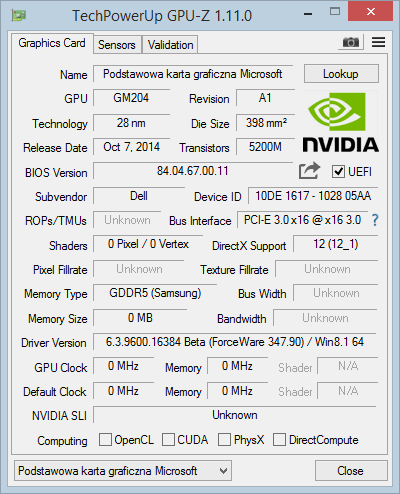

AdamU Posted September 16, 2016 Share Posted September 16, 2016 (edited) Hey guys, I have alienware 17 r1 ( or r5 with old name 2013year) i7-4700MQ and old 770M GTX. Wanted to do upgrade with 980M from Clevo ( g-sync card) can you help me. Right now it is shown as default graphic device and I cannot install drivers to it. Any chance to help me? Do I need to modify vbios or drivers, or both? Attached gpu-z screen for this card. Please help me Edited September 16, 2016 by AdamU Quote Link to comment Share on other sites More sharing options...
