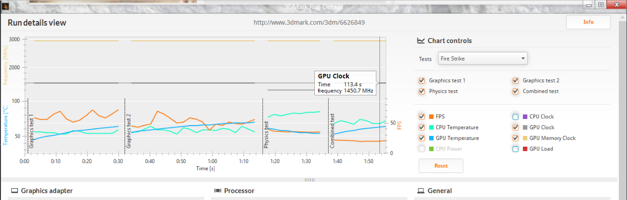

Closer...;) Optimus...hmmmm. To avoid that 'first second' run Valley stock clocks, wait a minute and set clocks/NV Inspector, then run 3DMark FS a couple of minutes later...;)
View run details
