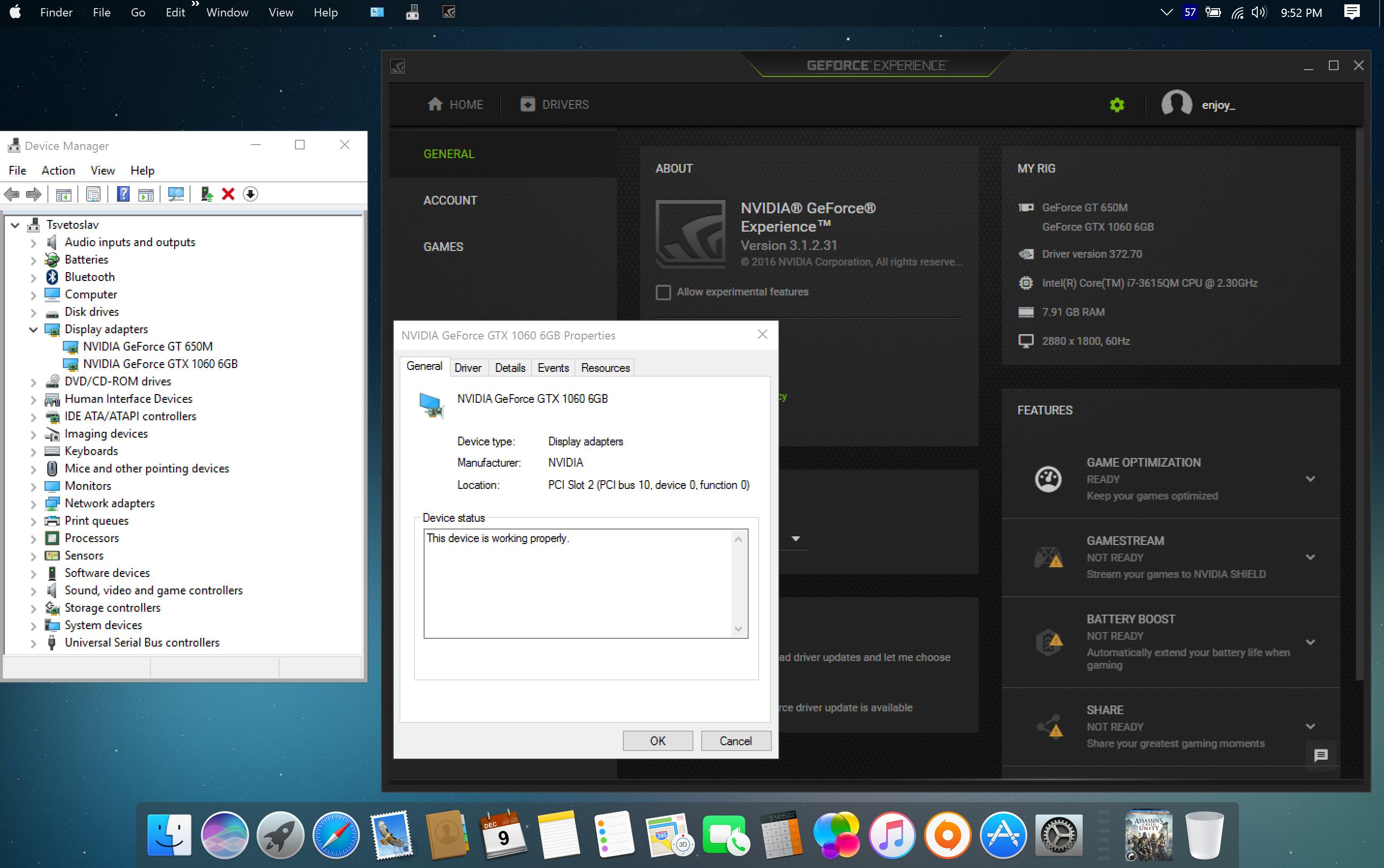

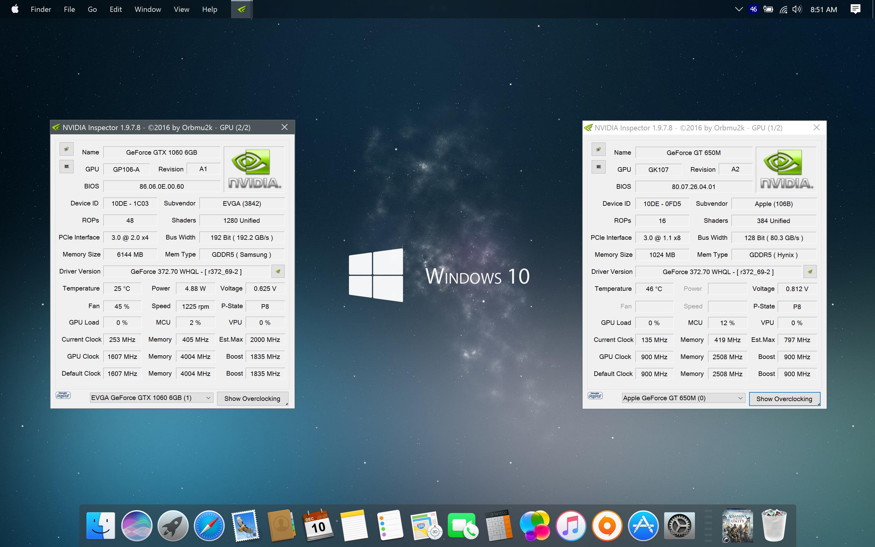

I have Windows 10 64 bit (BIOS) via Bootcamp on my SSD and eGPU-Setup-1.20 ready.
III. Uninstall GT650M Drivers from Device Manager and Download and install 327.70 NVIDIA Drivers - http://www.nvidia.com/download/driverResults.aspx/107012/en-us
IV. ERROR 12 FIX
  • Unzip eGPU Setup 1.2 to c:\eGPU
  • run setup-disk-image (as admin user)
  • Restart and load eGPU Setup 1.2 and select 2 with your keyboard
  • Then:
Spoiler
1.
2.
3.
V. Install again 327.70 NVIDIA Driver when you with the two GPU's in Windows
VI. DONE

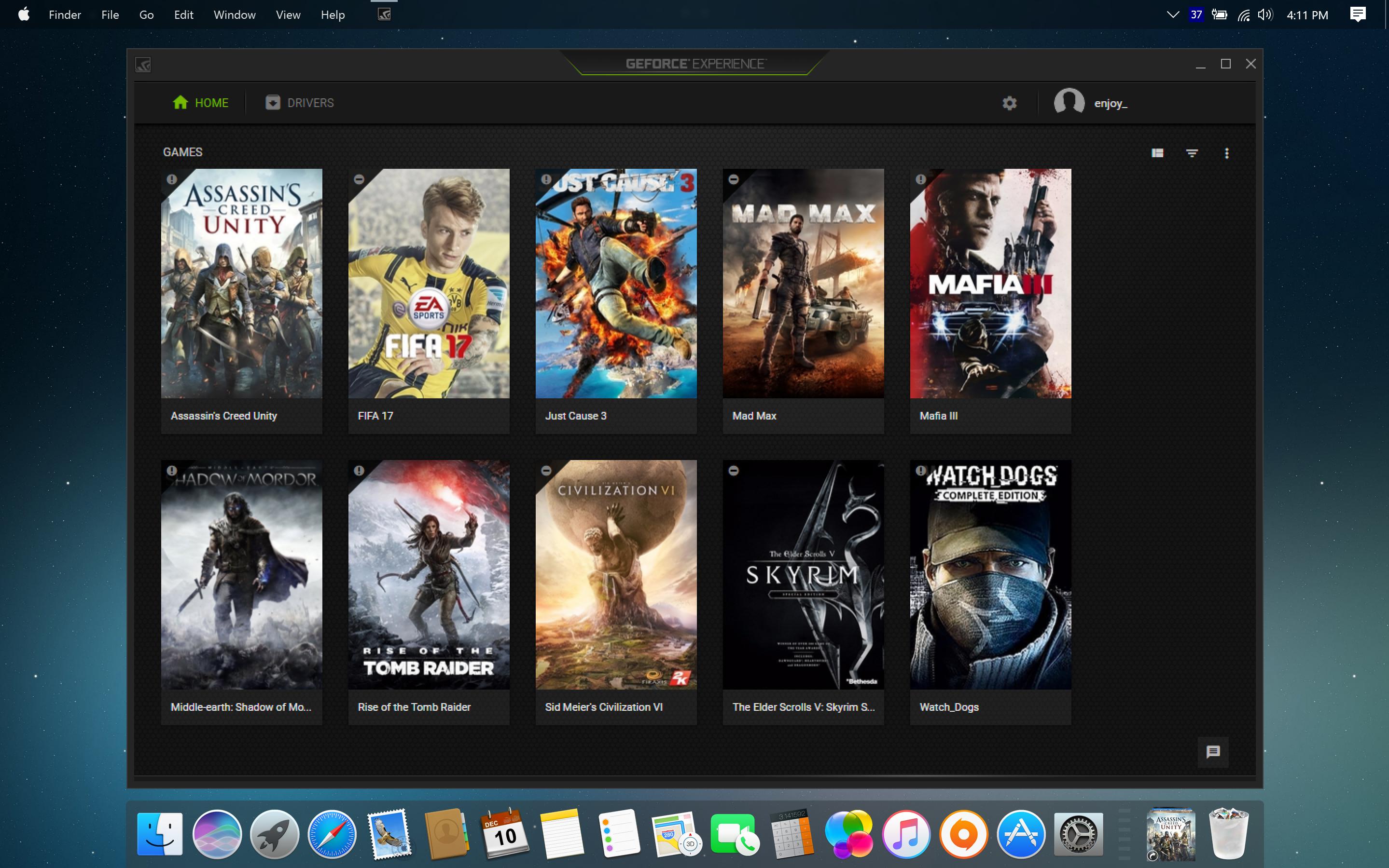

VII. GAMES - I can play all games i have with 60FPS with High/Ultra setings FULL HD 1920x1080 - Before that i can play only on lowest settings with my GT 650M 1GB with 1280x800
VI. UPDATE NVIDIA DRIVER via GEFORCE EXPERIENCE TO LATEST DRIVERS - 378.66
VII. DONE
I can play all games - FULL HD / 60 FPS (all to MAX + AA) on External Display
I can play all games - 1680x1050 / 30-40 FPS (all to MAX + AA) on my Internal Reitna Display

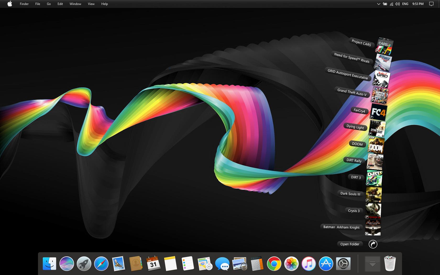

 I also made a custom Windows 10 theme aka macOS Gaming 10.10.10

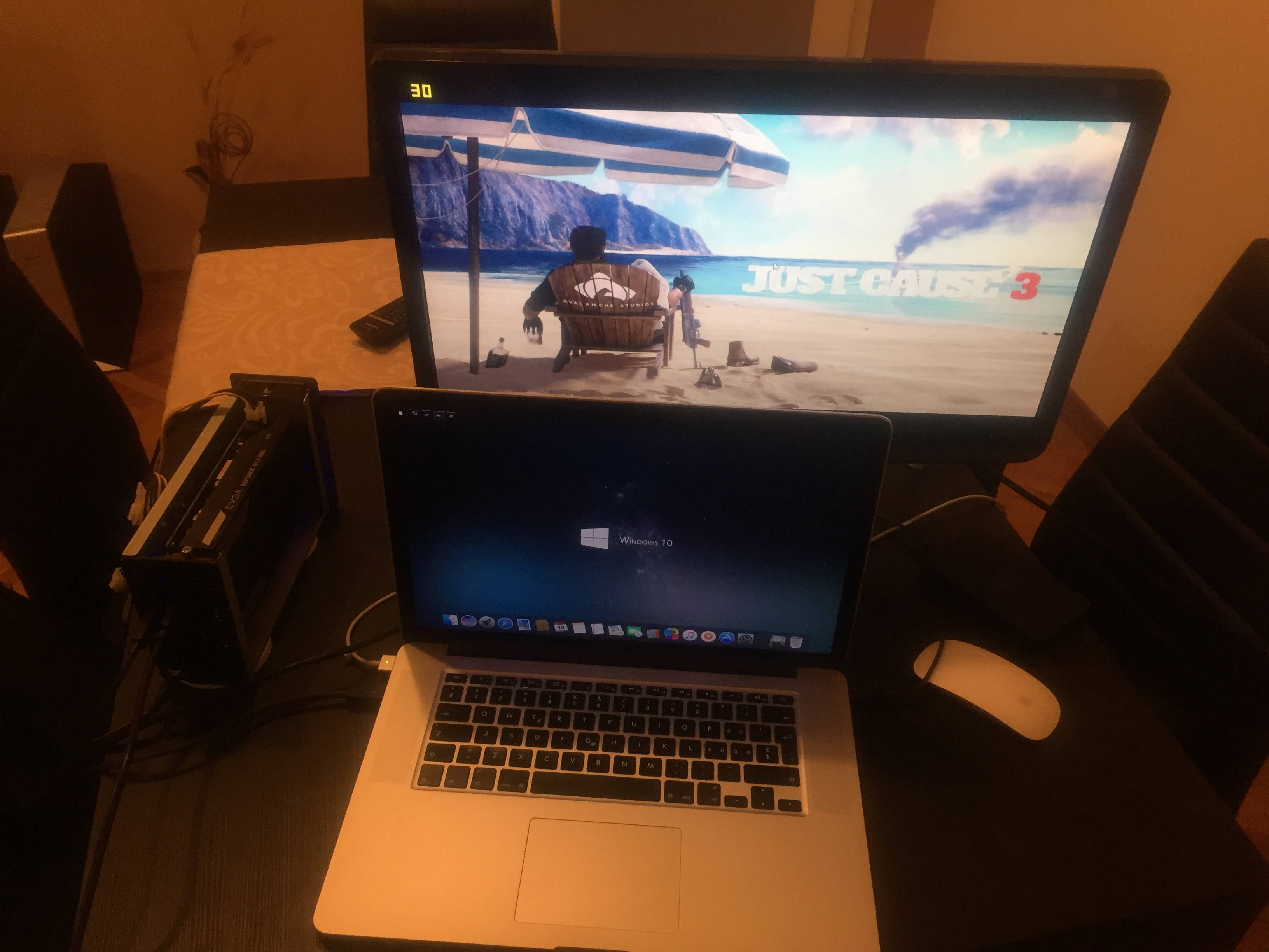

VIII. PLAY ON INTERNAL RETINA MONITOR @LukeHero MOD:
So the main limitations with this model of Macbook is the fact that you need an external display. So @LukeHero got around this limitation with this little device and three resistors:
It's a HDMI to VGA adapter.
All you need to do is put 3x 100ohm resistors inside the VGA port to create a fake external display. You can see where the resistors need to go with this image:
So the deal with this is, any program started on the 'external screen' (being powered by the eGPU) will use the eGPU. So what you'll want to do is set the fake display as your main display. Then anything started on that display will be running from the eGPU. Now there is a little limitation here; only games that run in windowed mode will work (which is most). You'll want to start the game on the fake screen in windowed mode and then drag it over to your internal display.
So how do you grab from a display you can't see? Well, I found this free program called Dual Monitor Tools (it's free right here: Dual Monitor Tools - Home )
and what you can do in this program is set a keyboard shortcut to move the selected window over to the other display. So you click on the game in the task bar, and hit the shortcut you assigned and it'll pop over to the internal screen, but because it was launched on the fake screen, it'll be powered by the eGPU.
Simple as that, there's no performance hit either as you're just dragging the game to the other screen.
A good tip is to have the internal display set as default first, launch the game, go to options and set the game to windowed mode now, then quit and relaunch after you've changed the fake screen as your primary. Otherwise you might not be able to switch it with the shortcut while it's in full screen.

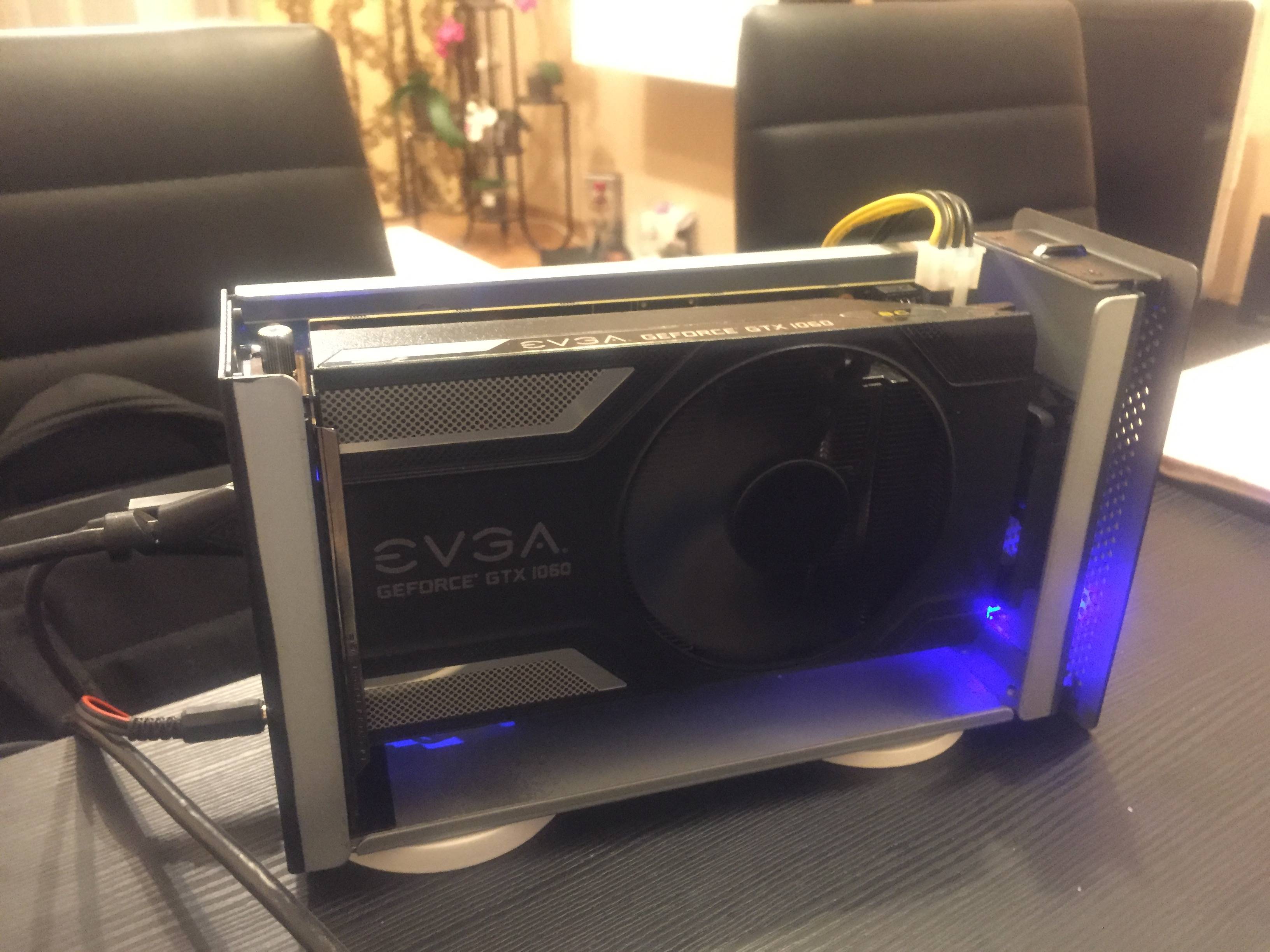

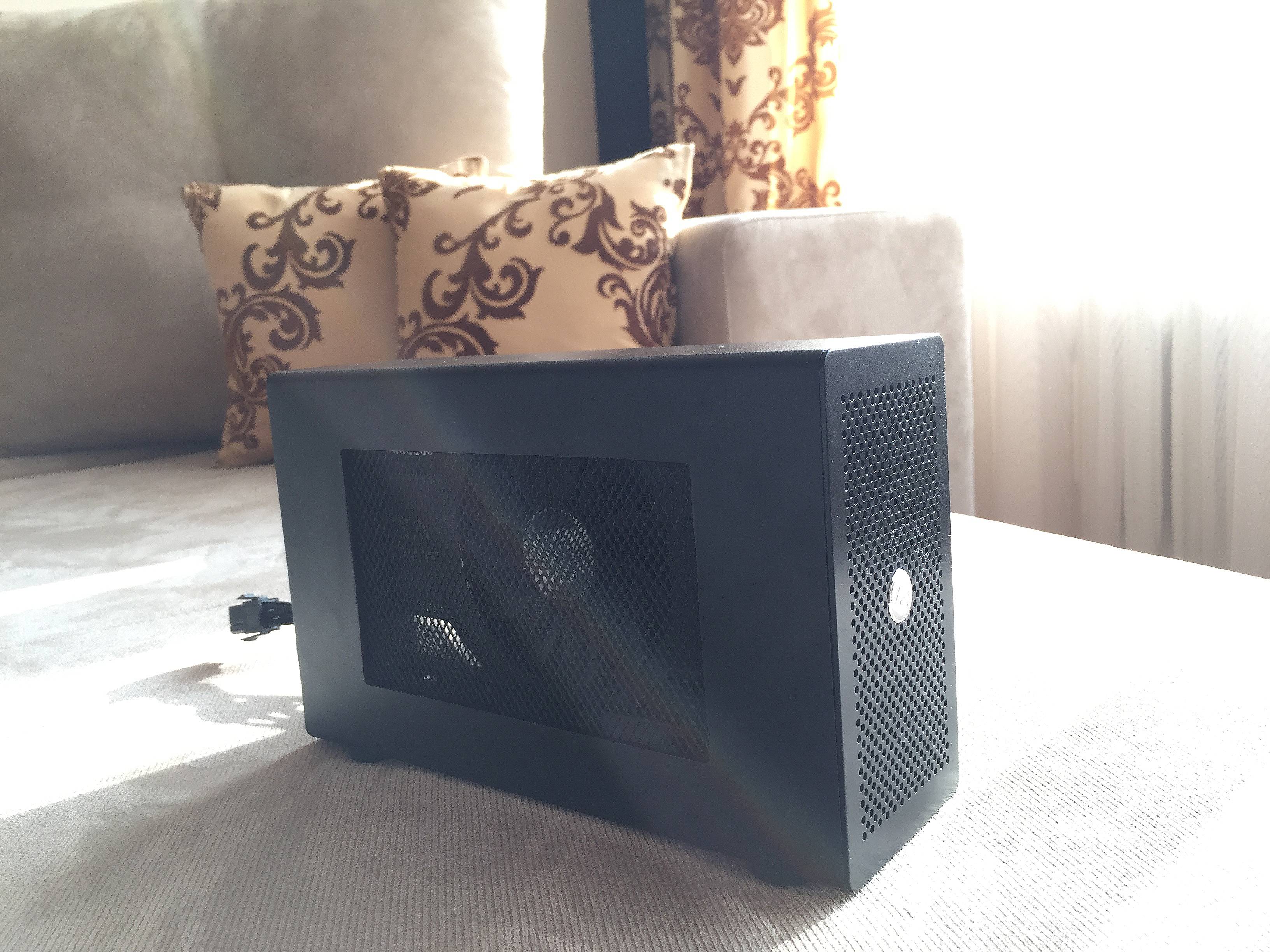

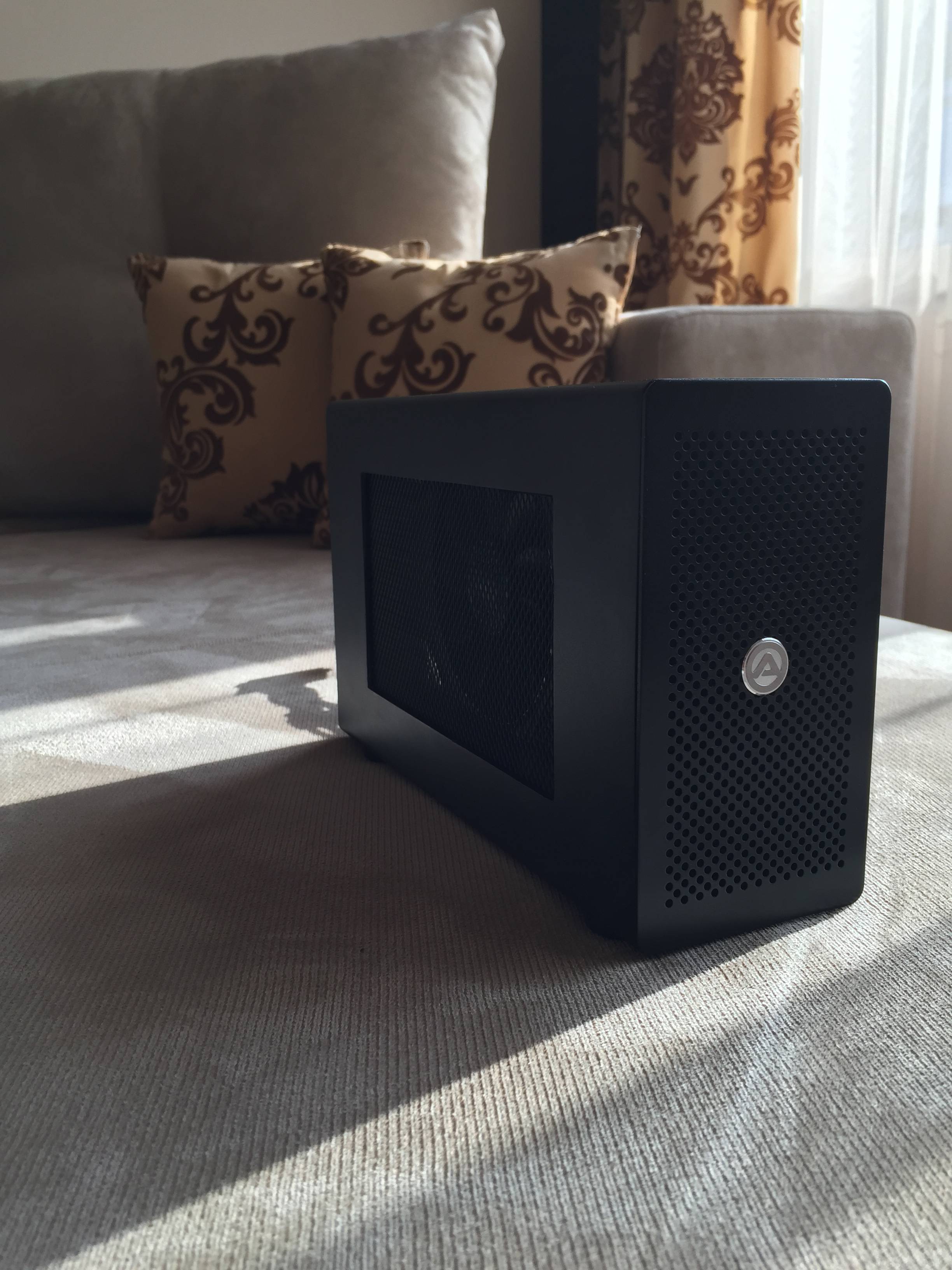

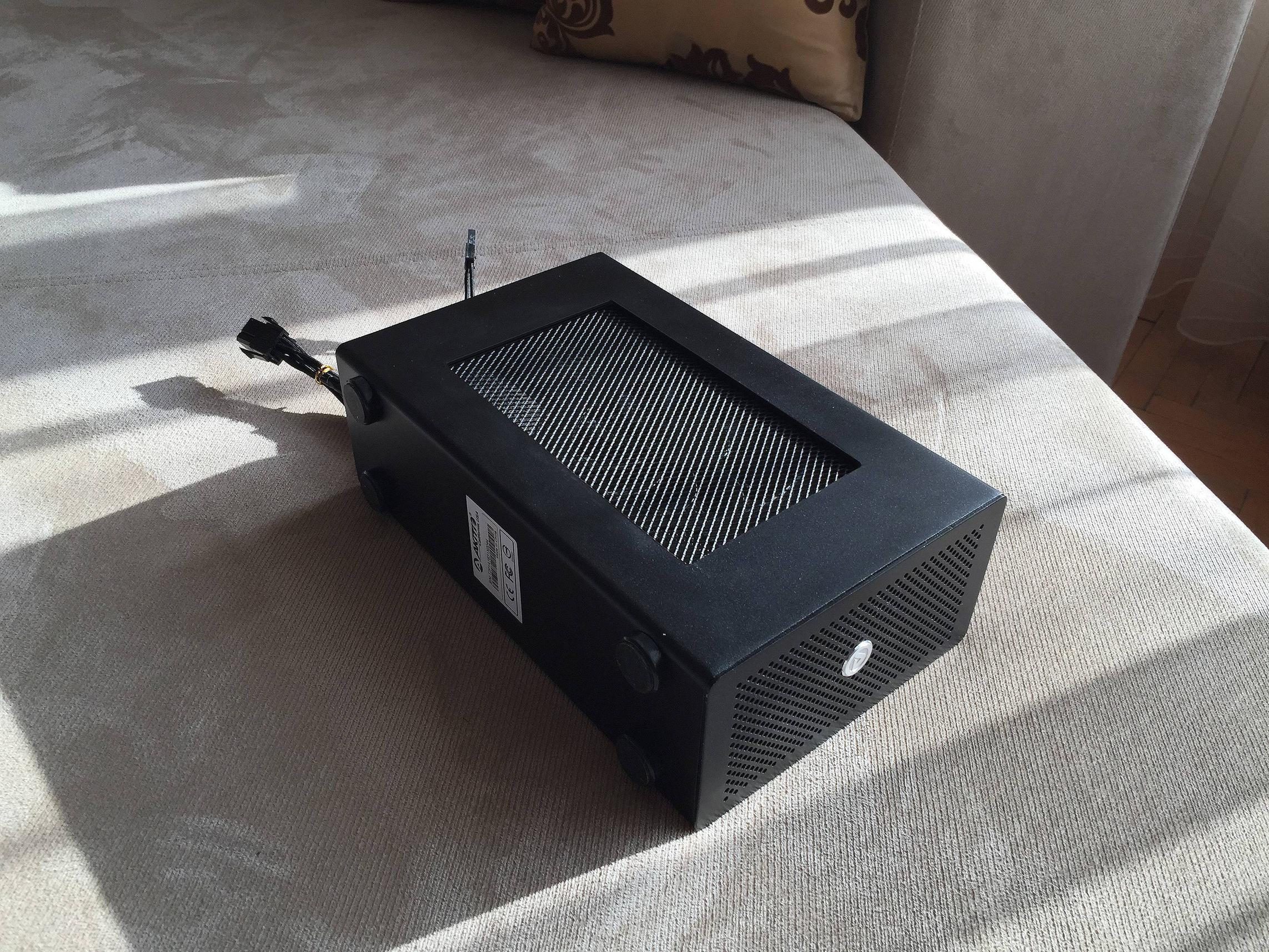

HOW TO CLOSE THE AKITIO CASE:
Spoiler

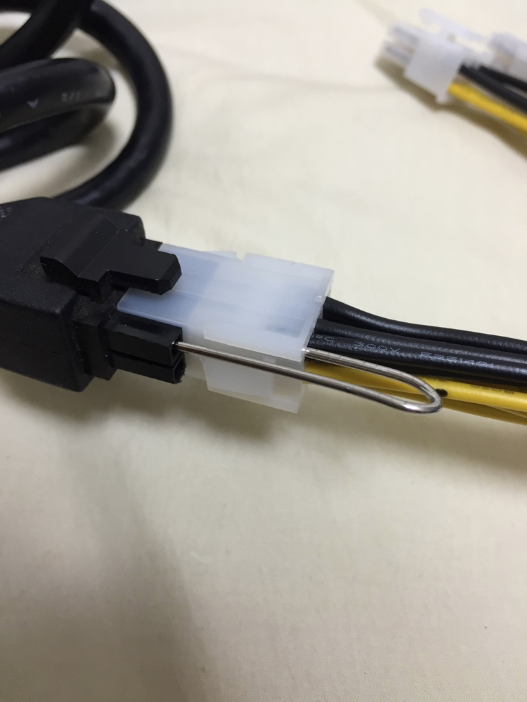

1, I made by myself 90 degrees 6 pin i use one of my  Startech.com 6 inch PCI Express Power Splitter Cable to close the Akitio
2. I buy 6-pin to 6+2-pin PCI-E power cable (you can use 6pin to 6 pin but i cant find here in Bulgaria), cut him and put him in the Akitio original hole close to Akitio Barell plug
3. I remove the Akitio back panel (also help for the Air)
HOW TO START THE SETUP (when i want to play games):
1. choose eGPU Setup 1.2 from boot menu and select 1 with your keyboard
2. choose again Windows 10 from boot menu
3. Start the game i want
4. Press the combination for Dual Monitor Tools to show the game on my internal display (i use Borderless Gaming so i run my games fullscreen on my retina display)
5. Done - my old rMBP 2012 can run all new games - 30-60FPS (1680x1050) on Very High/Ultra settings on my retina display Borderless like Fullscreen!

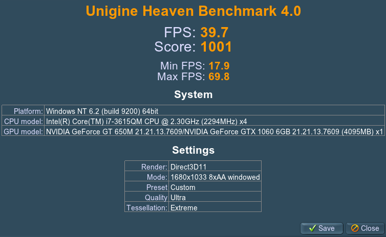

Unigine Heaven 4.0 Benchmark Score EXTERNAL DISPLAY 1920x1080:
Unigine Heaven 4.0 Benchmark Score INTERNAL RETINA DISPLAY 1680x1050:

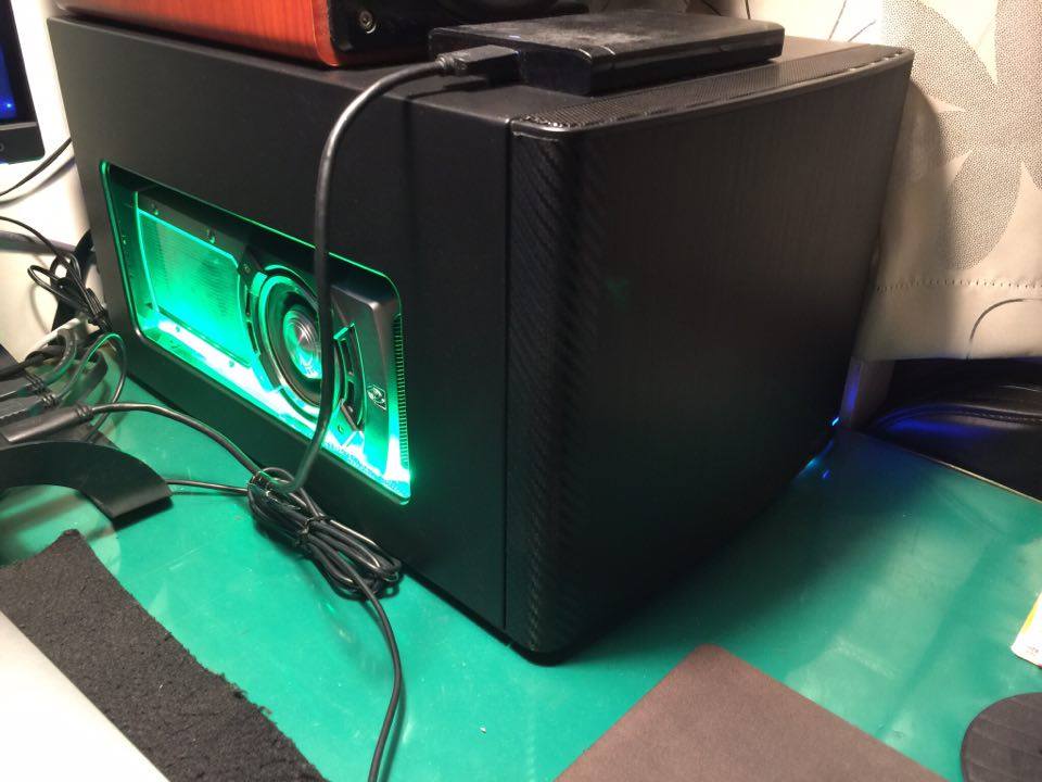

AKITIO TB2 CASE MOD - by enjoy ;)

Never, its very stable, i never have any problems, i will update tomorrow with more pictures ;) i made the best Akitio case mod - its looks better then Razer Core :)
On 2017年1月4日 at 8:02 PM, enjoy said:
Big update i made the best Akitio Case Mod Ever :) no overheating - max 55-60 degrees on heavy games.
Your case look amazing! I used Fractal Design Node 304 as my eGPU case, and I added LED lights in it. Btw why did you check "closeunsedbridges" ? Does it made any difference?
Edited by simon753

Thanks for the words, i really love my case mod, its look amazing and clear ;)

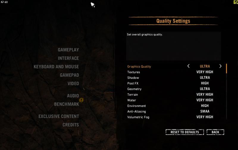

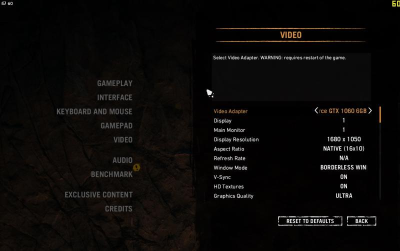

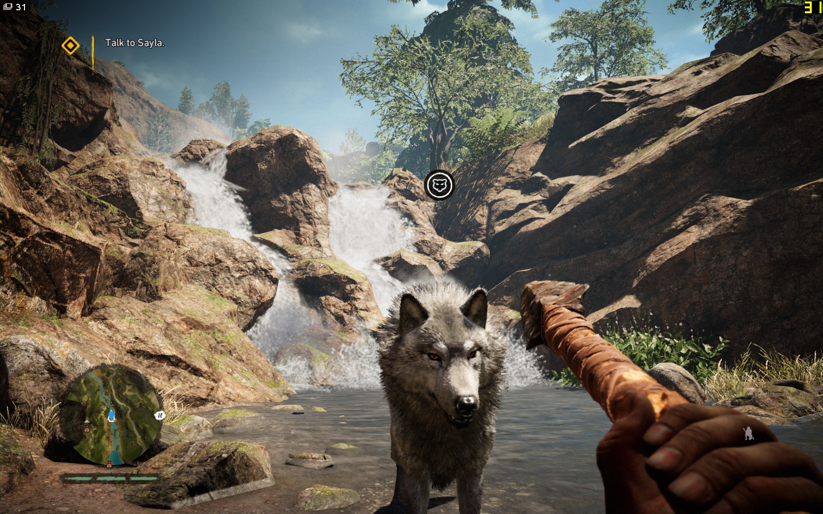

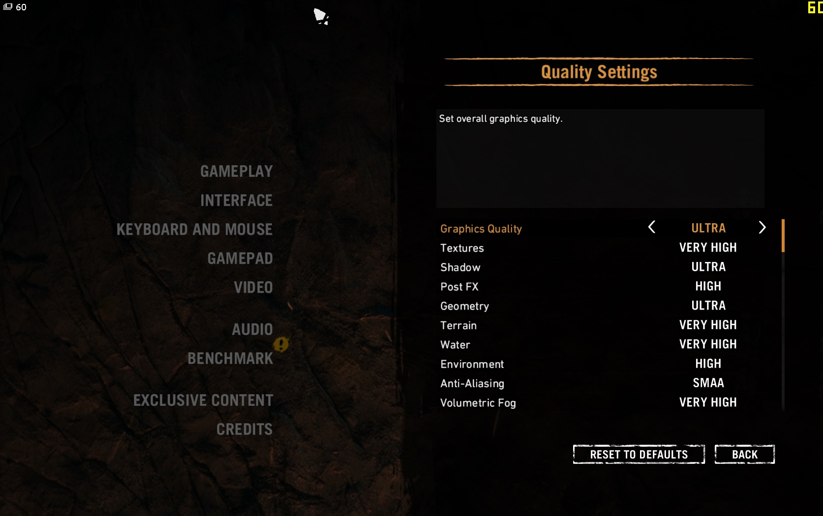

Between i just buy Far Cry Primal, and this is the first game that have a menu to choose the video card you want to play!
1. So to play the game I made my Retina display as my main display
2. Start the game
3. Choose GTX 1060 6GB
4. set Borderless Windowed
5. Restart the game
6. DONE, i can play without   Borderless Gaming and  Dual Monitor Tools - Home
If in future more games have that options, it will be easy for us, because Retina display will be Primary always,
Not big problem for me now because i drag the taskbar from primary display (fake display) to my Retina display and i have fake main display but i must use Dual Monitor Tool or Shift + Left + CMD to move programs to my Retina display and Borderless Gaming app :)
And again Far Cry Primal with Far Cry Primal HD Texture Pack and all set to ULTRA Setting with 1680x1050 I can play the game with 30-50 FPS on my retina display ;) Its look amazing!
