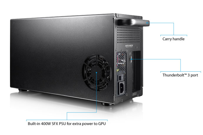

rene_canlas Posted September 23, 2016 Author Share Posted September 23, 2016 (edited) Cool! Would be nice if you had a variant with a handle on top Sent from my SM-G935F using Tapatalk Edited September 24, 2016 by rene_canlas 1 Quote Link to comment Share on other sites More sharing options...
Dschijn Posted September 23, 2016 Share Posted September 23, 2016 Good job AKiTiO! Looks way better than the pink/purple thing you did show before ^^ Quote Link to comment Share on other sites More sharing options...
DanKnight Posted September 23, 2016 Share Posted September 23, 2016 9 hours ago, rene_canlas said: Cool! Would be nice ifvyou had a variant with a handle on top Sent from my SM-G935F using Tapatalk Noted! It has been on our lists of features. 1 hour ago, Dschijn said: Good job AKiTiO! Looks way better than the pink/purple thing you did show before ^^ Thanks! Ahaha. The purple unit was a showfloor demo unit. We just wanted to be out of the ordinary and attract people! Quote Link to comment Share on other sites More sharing options...

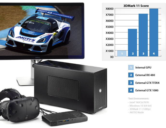

Ness Posted September 26, 2016 Share Posted September 26, 2016 So you're testing it with different gpus from amd and nvidia. That's great but what about different devices? Is it only skull canyon? Wondering about compatibility with the upcoming mb pro. Can it be tested now using tb3 to tb2 adapter? Quote Link to comment Share on other sites More sharing options...

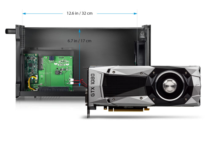

rene_canlas Posted September 27, 2016 Author Share Posted September 27, 2016 DanKnight, Can you release info on the maximum dimensions for a GPU that it can accommodate? What's the wattage of the PSU that it will be coming with? Dual PCIE 6+2? Price? Sorry for the bunch of questions! Cheers! Rene Quote Link to comment Share on other sites More sharing options...
Dschijn Posted September 27, 2016 Share Posted September 27, 2016 15 hours ago, DanKnight said: We shrunk it enough that there is still enough room for the pipes and a radiator in the front. That sounds interesting. Are talking about radiators for watercooled GPUs? Quote Link to comment Share on other sites More sharing options...
DanKnight Posted September 27, 2016 Share Posted September 27, 2016 22 hours ago, rene_canlas said: DanKnight, Can you release info on the maximum dimensions for a GPU that it can accommodate? What's the wattage of the PSU that it will be coming with? Dual PCIE 6+2? Price? Sorry for the bunch of questions! Cheers! Rene Currently cannot release any info because the specs may change a bit by release. Don't want to mislead anyone! 9 hours ago, Dschijn said: That sounds interesting. Are talking about radiators for watercooled GPUs? Yes, radiators for watercooling! Did I get that term correctly? That's what we've been calling them. Ahaha. 1 Quote Link to comment Share on other sites More sharing options...
