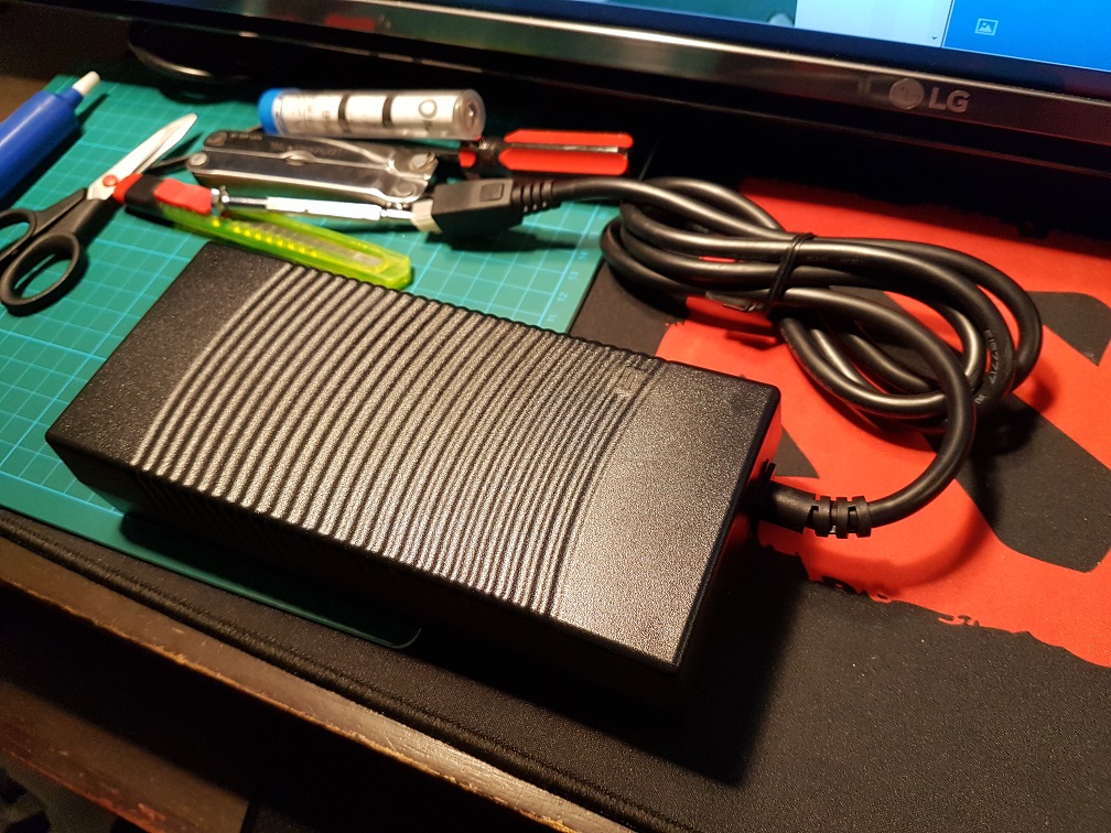

Update: Stressed tested the PSU with the Akitio Thunder2 and the GTX 1060 using Heaven for 5 hours. The power supply's cable with the barrel plug didn't even get warm -

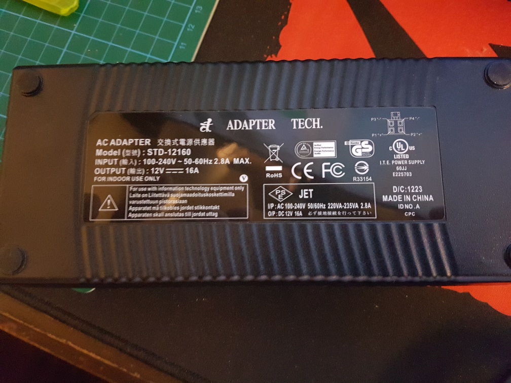

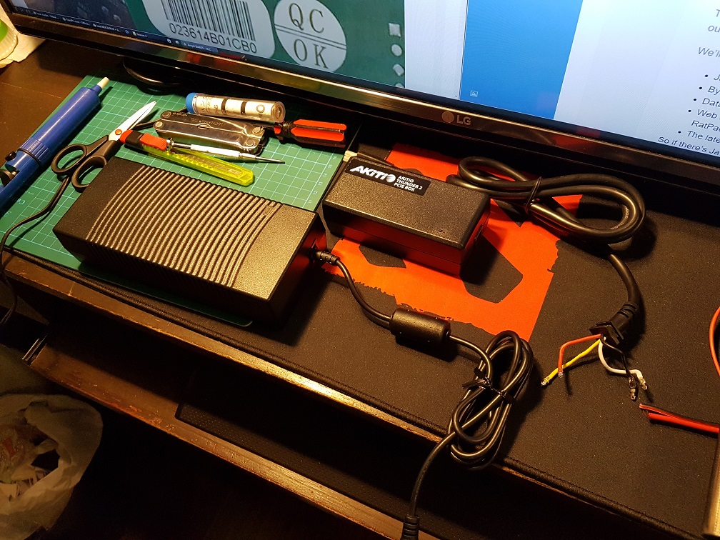

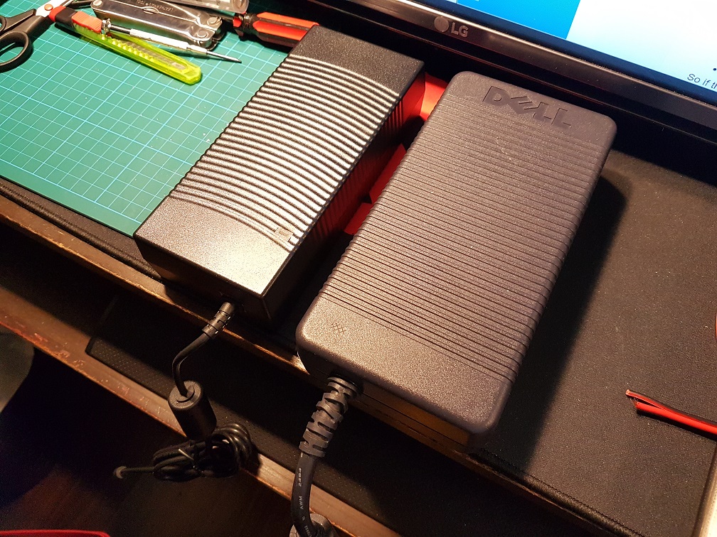

So, the STD-12160 power brick arrived today. It is a bit smaller compared to the Dell [email protected] power brick but the weight difference is almost half! I decided to replace the default cable on the power brick with the one from the original Akitio power brick. The Akitio cable is a lot thinner than the original, so I need to monitor the temps at full load to determine how hot the cables will get. Hopefully they won't melt -
