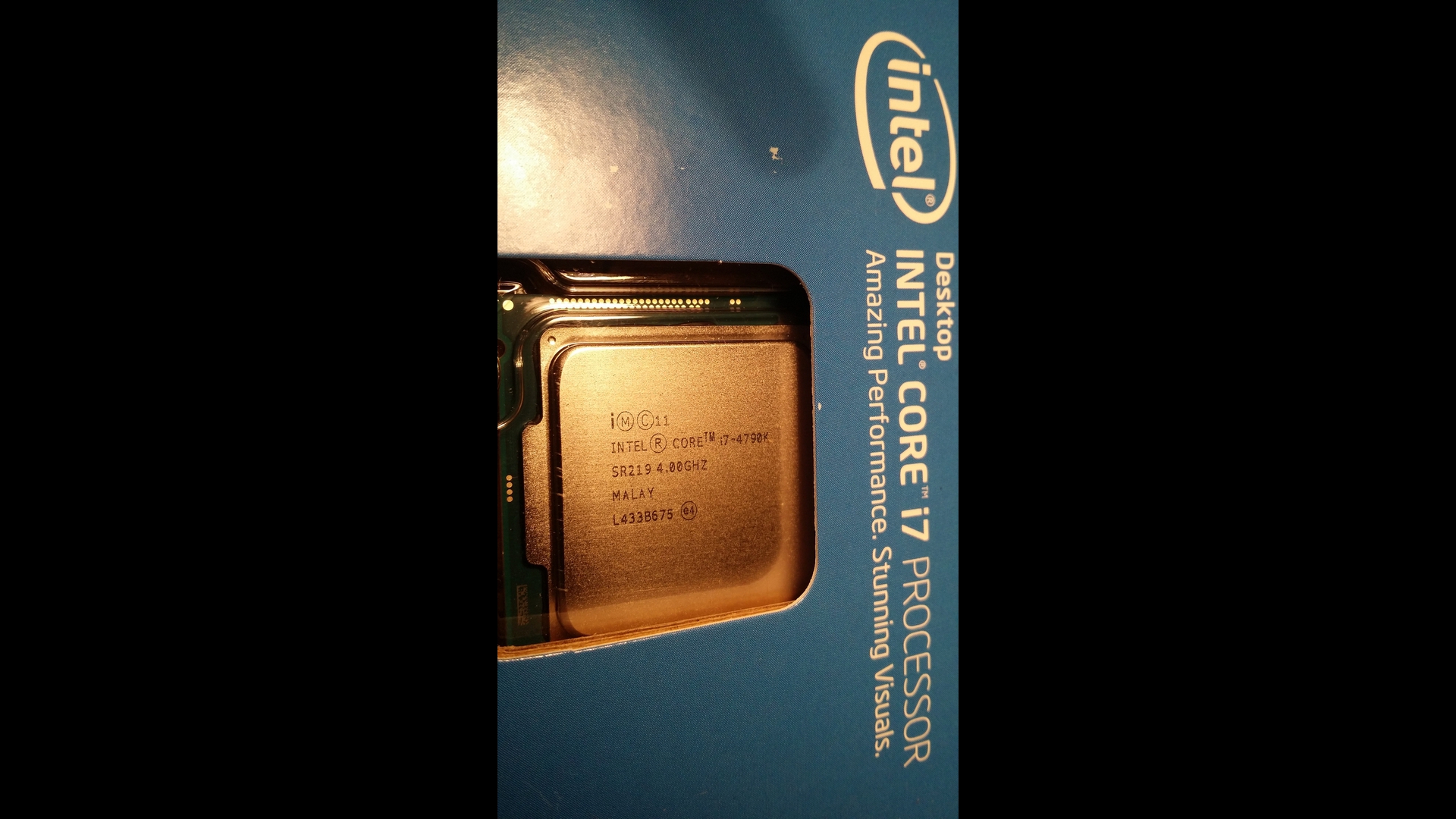

Yeah they really put off a lot of heat. Selling to someone close to me for almost nothing my Alien 18 want this person to have a nice premium system. Ill be keeping busy on a desktop from the parts I won and a 4790k for some nice fun. See what Devils Canyon is all about then give that to my mother so she has a newer system probably not need one for years to come. Think Ill get a Clevo type build if they ever succeed at putting the crazy 5960x with DDR4 in one. I definitely found you can do more at less mhz Louis, try a baseclock overlock on stock ram timings for faster ram and drop your multiplier to hit your target mhz. example 102.2or higherbaseclock and 44x for 4.5ghz around or 104.3baseclock at 43x for 4.5ghz. or target 4.4ghz or 4.6ghz but you may not need a high mhz if you can get your ram around 2200mhz baseclocking and wouldnt need to raise mhz or volts to gain more cpu performance. check on physics score improves dramatically at the same cpu speed compared.
