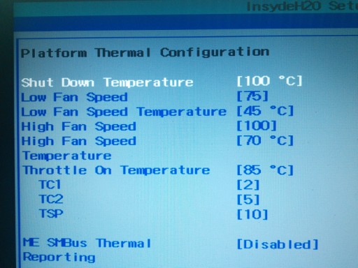

  11. Can't take screenshots in BIOS, so had to make a photo of the screen... Maybe it's different in Y500?

  13. You can override the fan speed and temperature thresholds with modified BIOS, i.e. there are 2 levels of fan speed and you can set the temperature when fan should kick in and with which speed.
