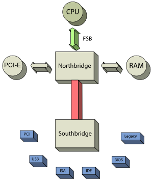

@ManyStrongWords me either, i dont think slv7 mod will work because basically his mod works with mpcie which is connected to the south bridge, while the PCI-E interface on the ultrabay is connected directly to the north bridge.

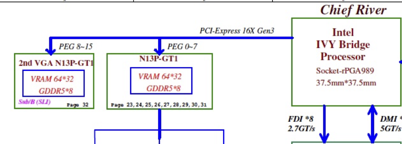

@Tesla: I have checked the schematics of the mainboard. All PCIe lanes are connected directly from the main processor to the mGPU (GTX) and to the Ultrabay adapter. So there is no reason why the external GPU should not work. It must be a BIOS whitelist which blocks nvidia cards.
