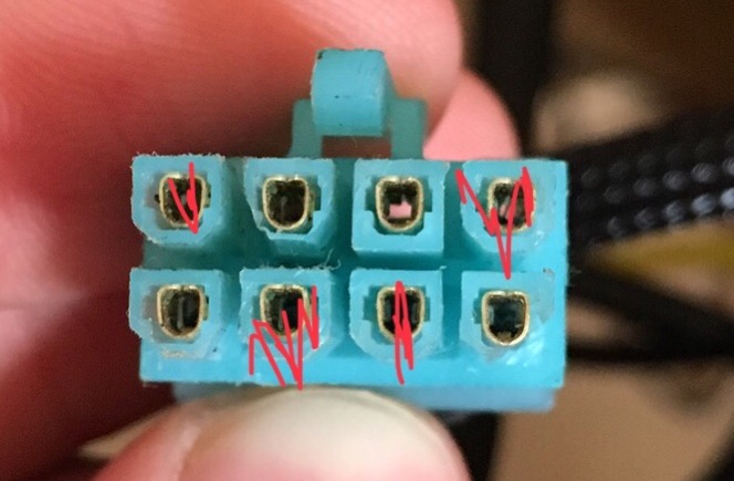

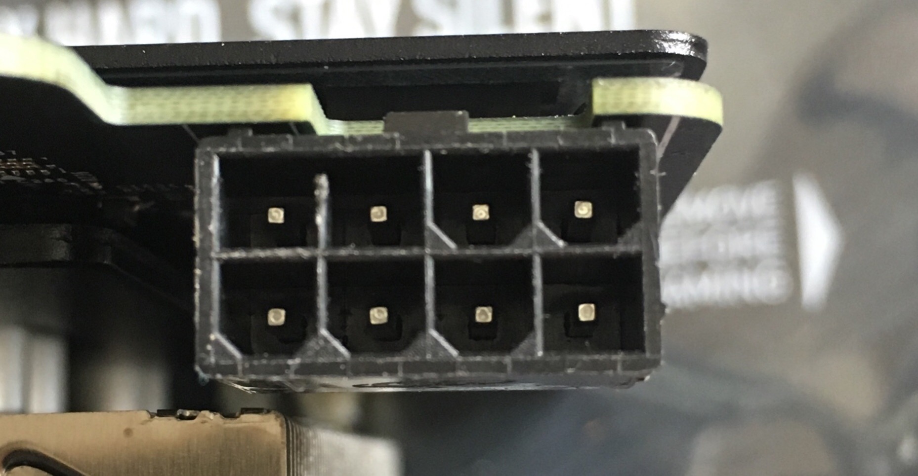

1 hour ago, rusTORK said:
@balint234If you cut connectors - it’s probably wrong move. Provide more data about you PSU (manufacturer, model). There few options possible with that connectors, like 6+2 pins and solid 8-pin. I didn’t hear anything about “another 8-pin” connector. Connectors in general designed to be “fool proof”, it’s mean it will be connected or will not fit.
I swear this thing wasnt even close to fit
the ones i marked with red were the 4 pins that wasnt square by default all the others were squares.

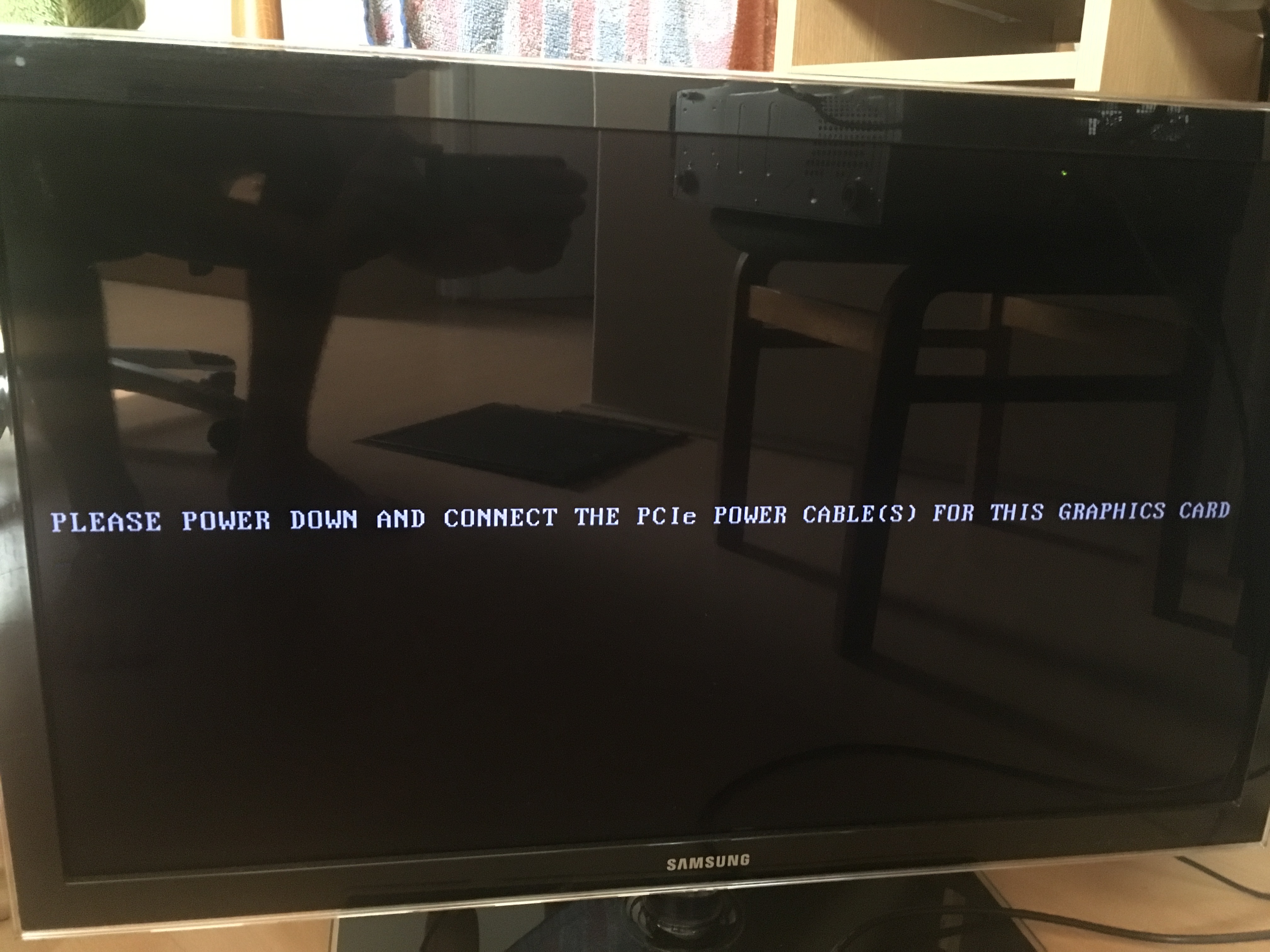

Looks like you are right because i tested the gpu in a pc that has no integrated graphics in it and it is obvious now that it needs the 8 pin
This has been the EPS 12V 8 pin connector, used for supplying power to CPU VRMs on some motherboards. You are really lucky it didn't burn your card, as voltages in this connector have the opposite polarity to the PCI-e one.
Yeah, that screenshot is exactly what was happening back then with my friend's MSI R9 280. Looks like you do need an 8-pin then...
Yeah, something REALLY wrong with this connector.
I founded similar problem with this connectors with scheme:
https://superuser.com/questions/1000679/i-plugged-an-8-pin-eps-cpu-cable-into-the-gpus-pci-e-port-is-it-damaged
Well nor the psu or the gpu started when this cable was pluged in so i really hope that it didnt cause damage to the card since its still looks like its working. Im on the way to get a 8 pin pci and i will report my experience

It is official now, the 6 pin connector was the problem.
Everything is fine now with the 8pin.
I want to say thank you to everyone who helped me, you guys are awesome. :)

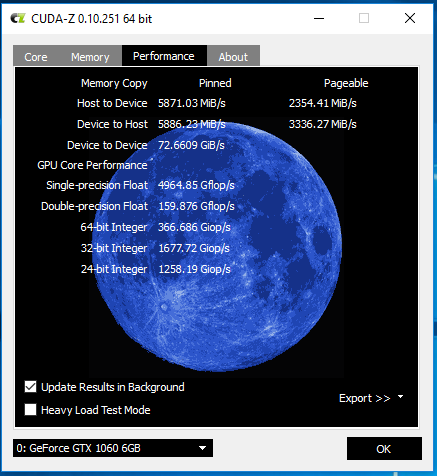

2 hours ago, intruder said:
@balint234 Glad that it worked out for you.
If possible do post some benchmark scores with that card. I'd love to see those scores with or without external screen.
Can you also show the bandwidth with CUDA-Z (performance tab)? Thanks!

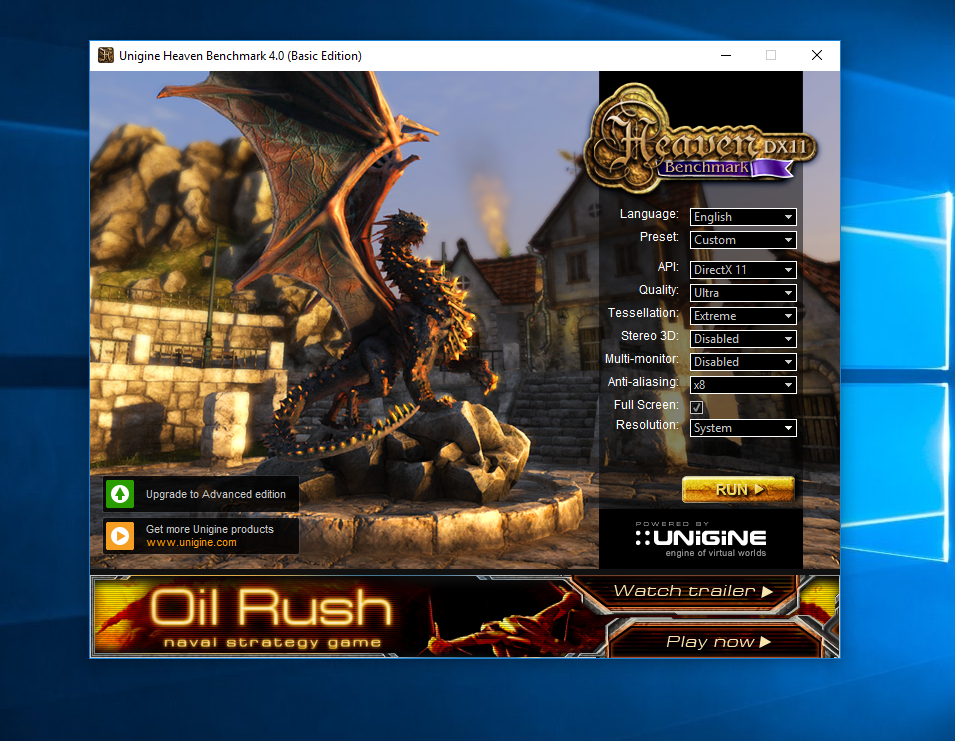

I ran heaven on the external screen.
CPU underclocked to 3.0GHz to reduce temps. since this gpu is too big and heavy to have a laptop cooler and have the ultrabay adapter stand supported with something in the air.
I will get a PCI-e extension cable so i can place the gpu somewhere further from the laptop on something stable.
Couldnt do screenshot because heaven was running in fullscreen so i had to make a pic with my phone. Its size is bigger than 2MB so here is a link where u can watch.
https://prntscr.com/keew9y
Nice. Thanks.
I was also planning to buy a riser cable to put gpu away from laptop but first i need to buy a gfx card :D
If you ever use a pcie extension cable do let us know which one you used. Some of them does not work as posted in this thread. It would be good to have an idea on which cables work.

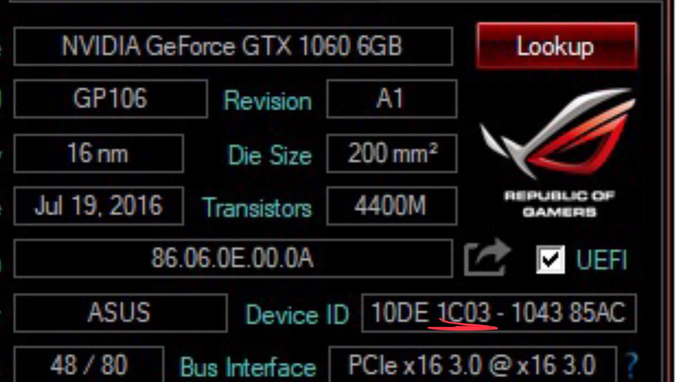

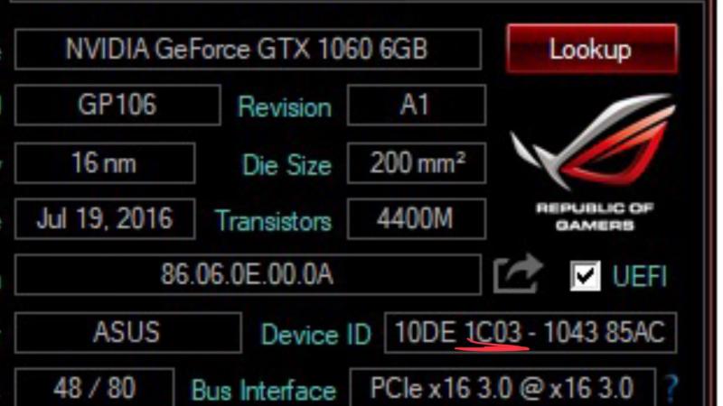

1.Install the card
2.download gpu z and identify your device id (if its not like on the pic i added then you need to edit the 361.88 driver)
3. Use the egpu error 43 solving method
as far as i know its not needed to clear the drivers beforehand because ddu will do it anyways
Kivancsian varom hogy sikerul ;)
Edited by balint234

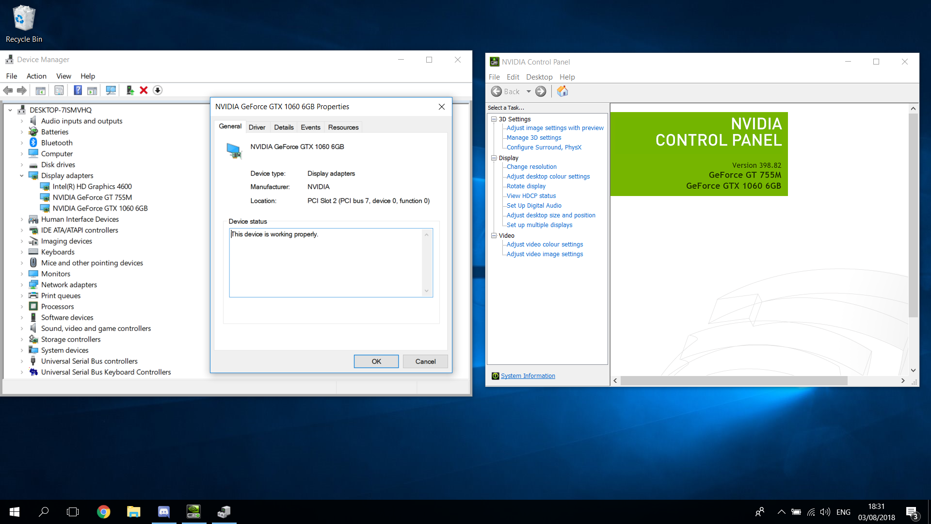

Hi Balint,
I am happy to report that everything went well!
(Köszönöm a segítséget! :-) )
First I flashed the modded y510p V3.08 BIOS for NVIDIA eGPUs -  thanks @High_Voltage
Then I did all the steps you quoted. I was lucky, my card's device id was also 1C03,
so I did not need to modify the 361.88 driver.
I tested my new setup with 3dmark then with the games Tomb Raider and Fallout 4 using
ultra/ultimate setting. I had no problem, the card performed very well.
(Need to buy more games. :-) )

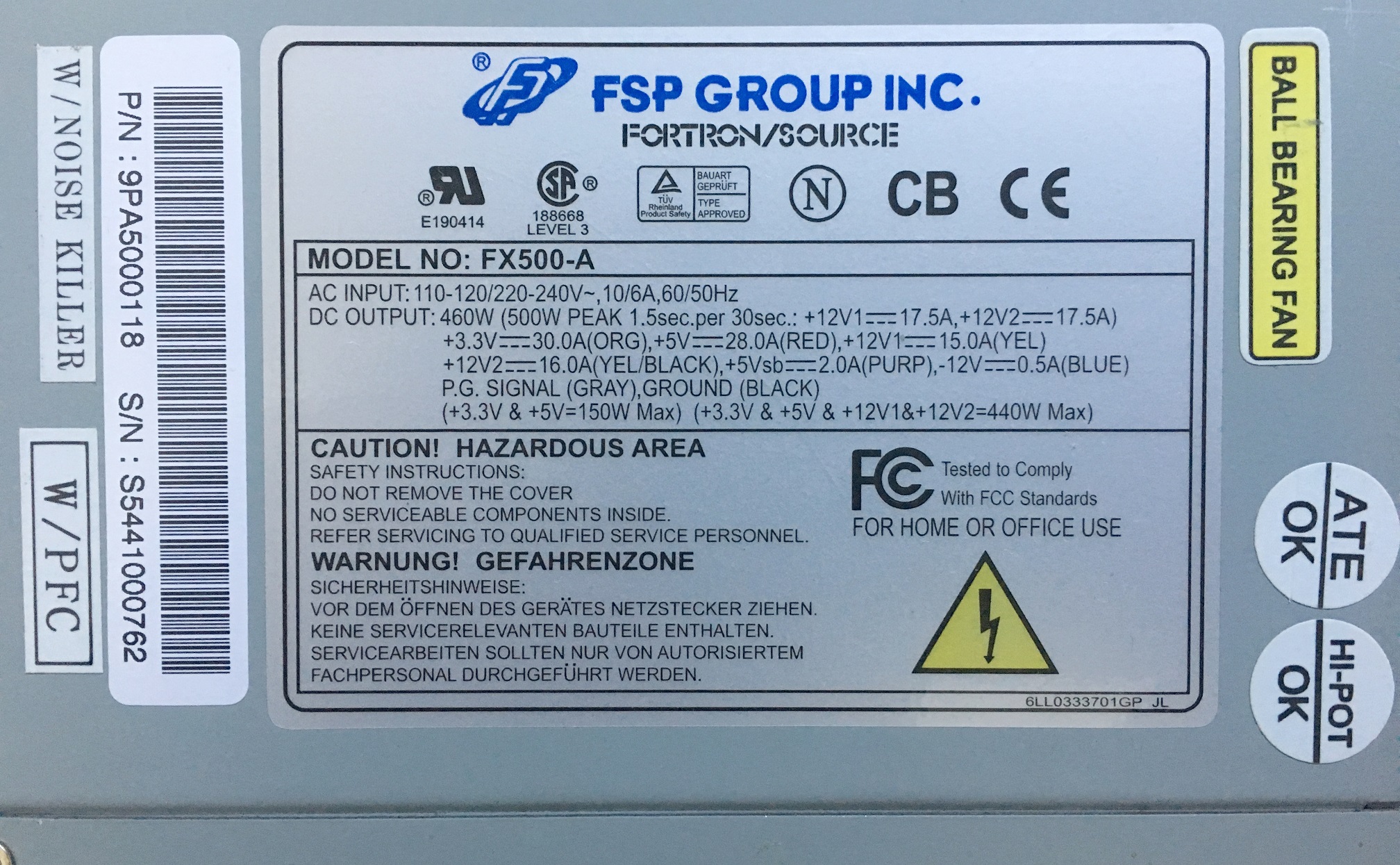

My adapter is still on the way to me, but i already collected some "hardware" to test it:
GPUs
1. Palit Radeon X700 (PCI-E, 128Mb, AE/X7000+TD11-PM9970) - Just to test how adapter may run Radeon card;
2. Zotac nVidia GeForce GTX 660 (PCI-E, 2048Mb, ZT-60901) - card i took at job;
PSU
1. 460W FSP FX500-A (very old PSU) - i think i can only run GTX 660 with it, but not test it. This PSU have two +12V lines, but each may provide only 17.5A. I even think that only fans will spin, but card can't run.
@rusTORK Gtx 660 needs about 140watts also 17.5A on a line is enough, you ar only powering a graphic card not an entire system, so technically it should handle something far more powerful. But i wouldent trust it for longer period of time, its old and of questionable quality.
