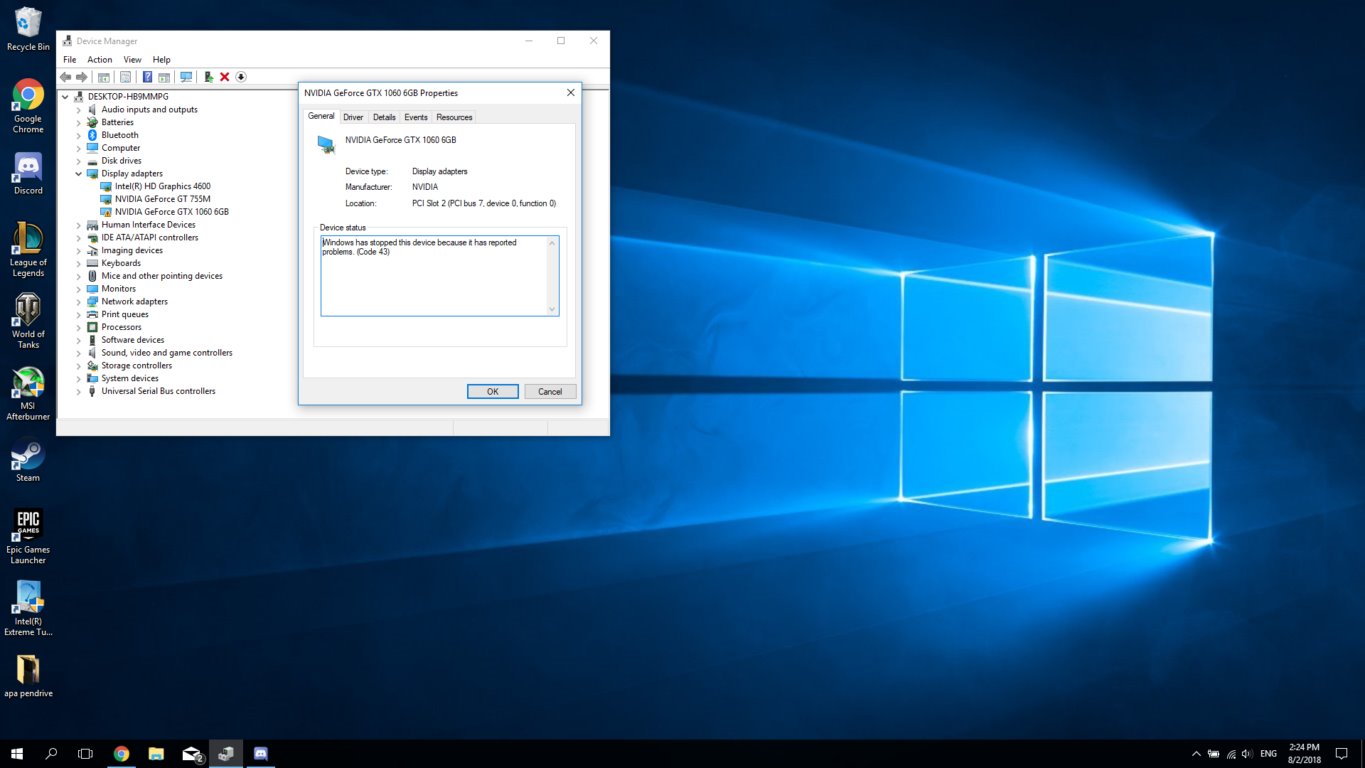

Hello People,
My problem is that the other day i got a MSI GTX OCV1 1060 6gb, successfully solved error 43 in device manager via the 1050Ti guide on the egpu forum.
I had to send back that card to the shop because it had issue with one of its fans. It was working tho but i didnt want to use a kinda broken card.
Today i just recieved my new card which is a MSI GTX 1060 6gb Gaming X. (This new card is way beefier and also has a 8pin connector instead of the 6pin the previous had. Unfortunately i only have 6pin connector but it seems to me that it is not the problem in this case because windows detects it, also fans and leds turn on when laptop turned on.)

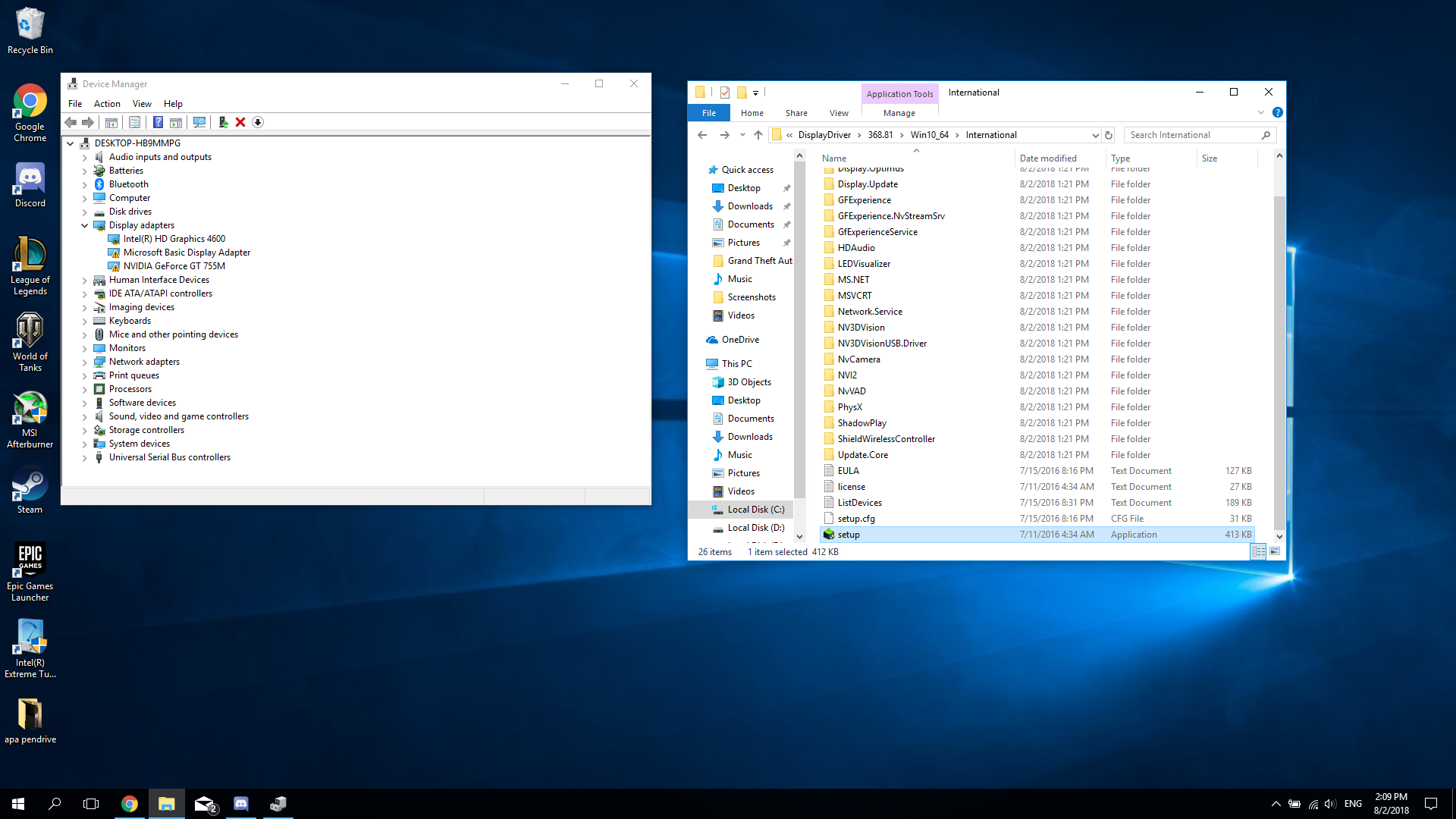

So the deal is that i pluged it in and i got error 43 again. I said well its fine i will do the trick again then. Unfortunately it doesnt seem to work now for whatever reason. I tried it 2 times already but no luck, it still says error 43 when im done with the method. Now i noticed that after i cleared my drivers with DDU and done installing 368.81 stock driver (it has the 1060 6gb included by default) in Disable driver signature enforcement mode, it only recognises the 755m right away and the GTX 1060 only gets recognised after the second (newer driver install).
Anyways i still get error 43.
Any ideas?

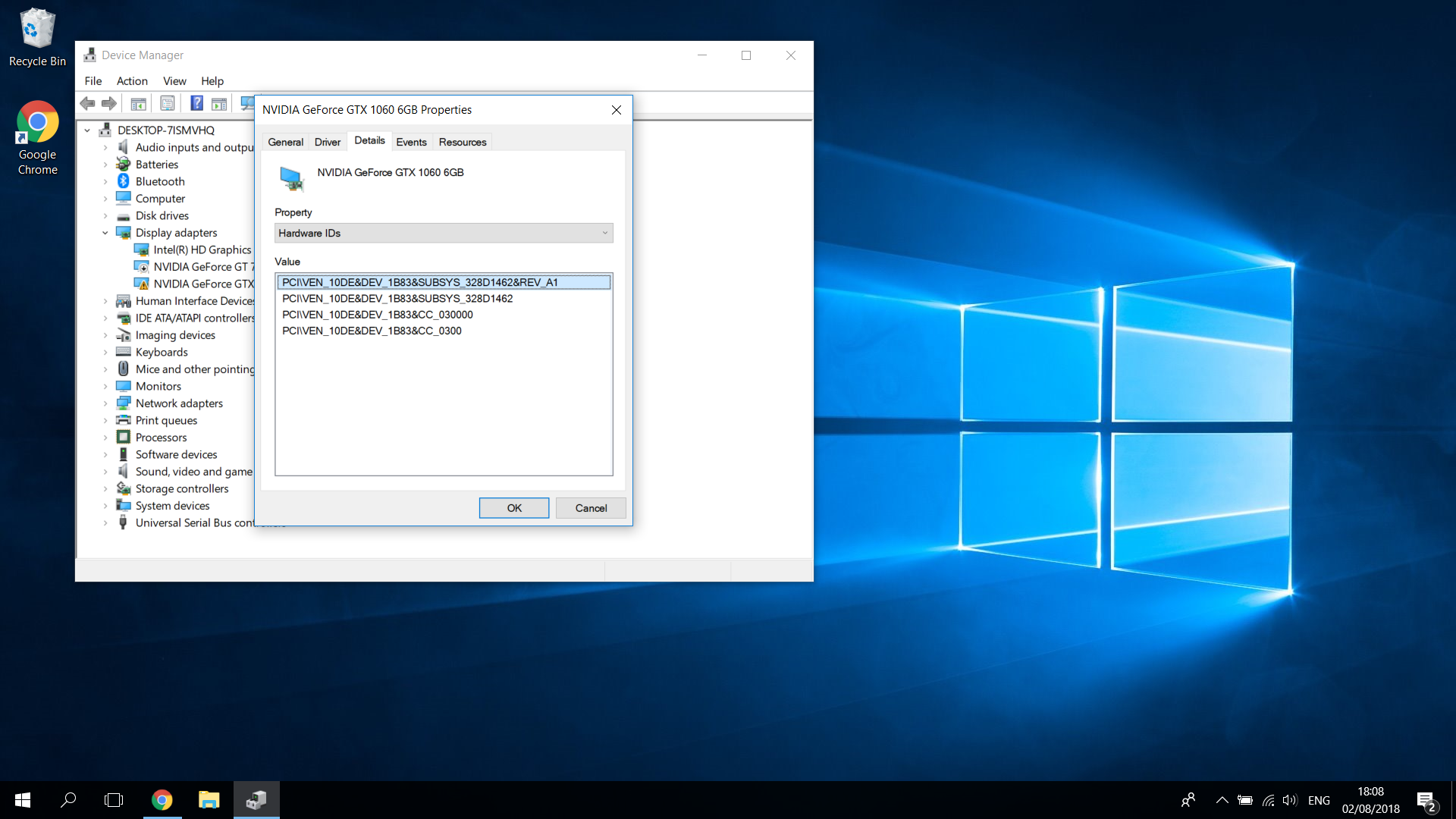

How do i check my card id?
Edited by balint234
ehhh...I can't remember that clearly.but as far as I can tell you can refer to the guide to modify the driver.
it's somewhere in the device manager.
right click on your gpu-properties-details tab? It's likely to be there. I dunno.

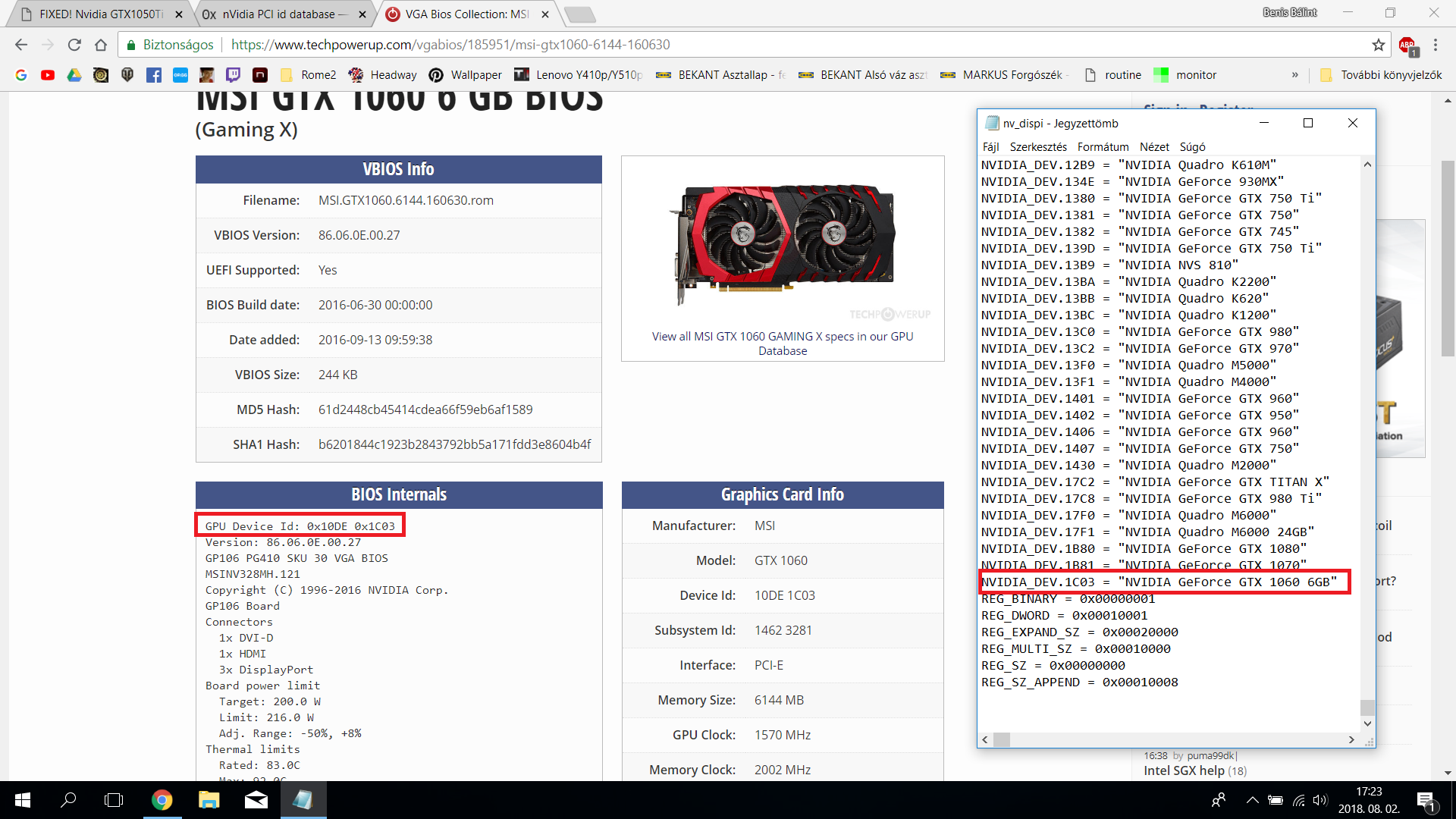

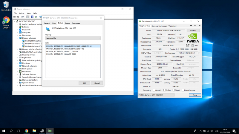

i only found this
27 minutes ago, Swung Huang said:
yep. That's the problem. You should add that Id to the driver and install the modified driver.
By the time i read your reply i already started doing it, i didnt add it but replaced the original 1060 id to this one.
