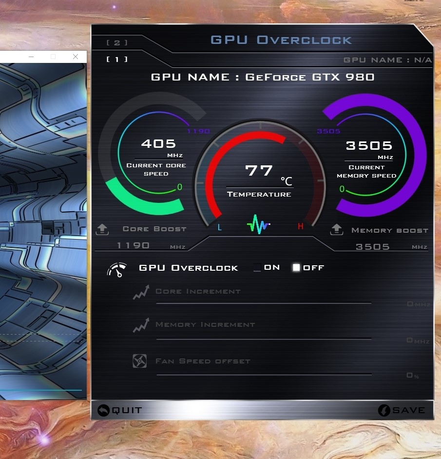

hi,
i brought my P775DM1 a couple of months ago and i decided to see if i could overclock my GPU at all. but after testing it on stock speeds my GPU clock speeds drops to 405Mhz when running furrmark and never picks up from here
is this normal?
+ if everything is fine control center wise judt try replug the power cable in windows, seldom the power delivery gets bugged and thinks you still use battery even when using otherwise.
Gesendet von meinem Nexus 6P mit Tapatalk
