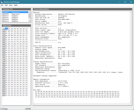

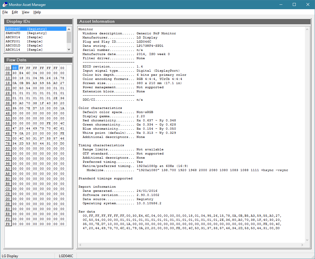

  3. In lieu of Prema's modified version, I have just dumped my current SPF1 EDID using moninfo, currently working with G-Sync LP173WF4-SPF1.bin
  4. My original screen was swapped back in, and G-Sync was restored. Been waiting since then to get a replacement screen of the same panel. Edit: Originally had SPF1, after a dead pixel repair I was given SPD1 that didn't function with G-Sync with my laptop, so I sent laptop back and original SPF1 was refitted to get G-Sync back

  10. Dumped and attached to this post in case you find anything of interest dspinfo.bin
