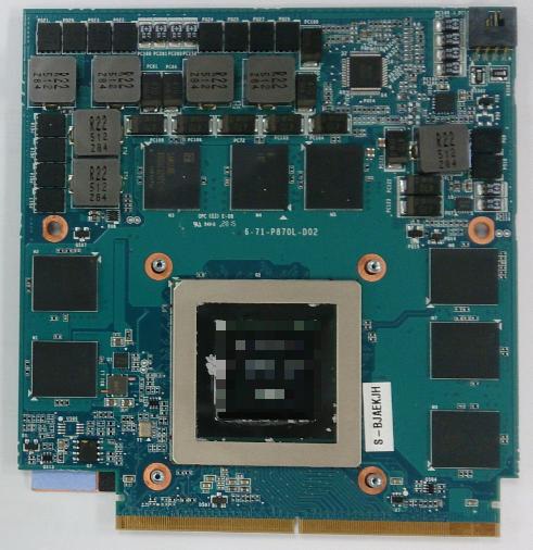

I. CLEVO P870DM-(G) - 200W / 8GB / 1190Mhz Base / 1190-1228Mhz Turbo / 3500Mhz vRAM / (115x108mm)

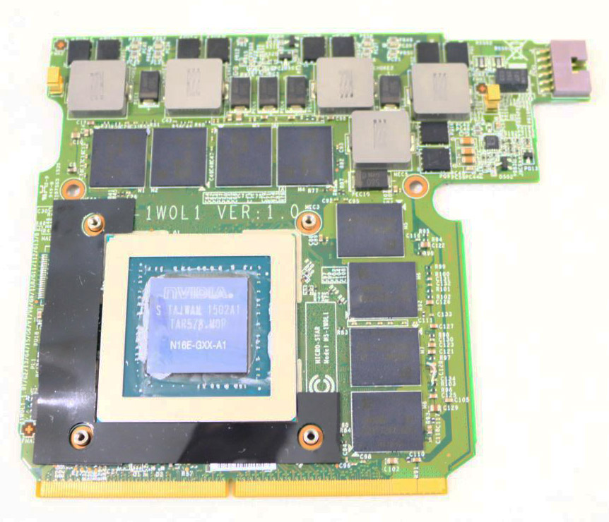

III. MSI GT72S - 150W - 8GB / 1140Mhz Base / 1190-1228Mhz Turbo / 3500Mhz vRAM
IV. MSI WT72 6QN - 150W - 8GB / 1040Mhz Base / 1165-1228Mhz Turbo / 3300Mhz vRAM (M5500)

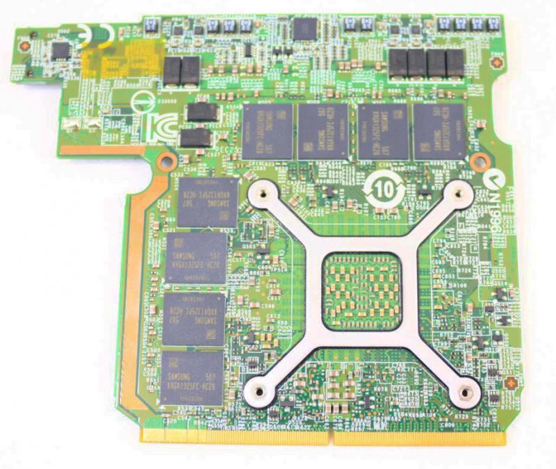

V. ASUS GX700VO - 1x0W - 8GB / 1190Mhz Base / 2500Mhz vRAM

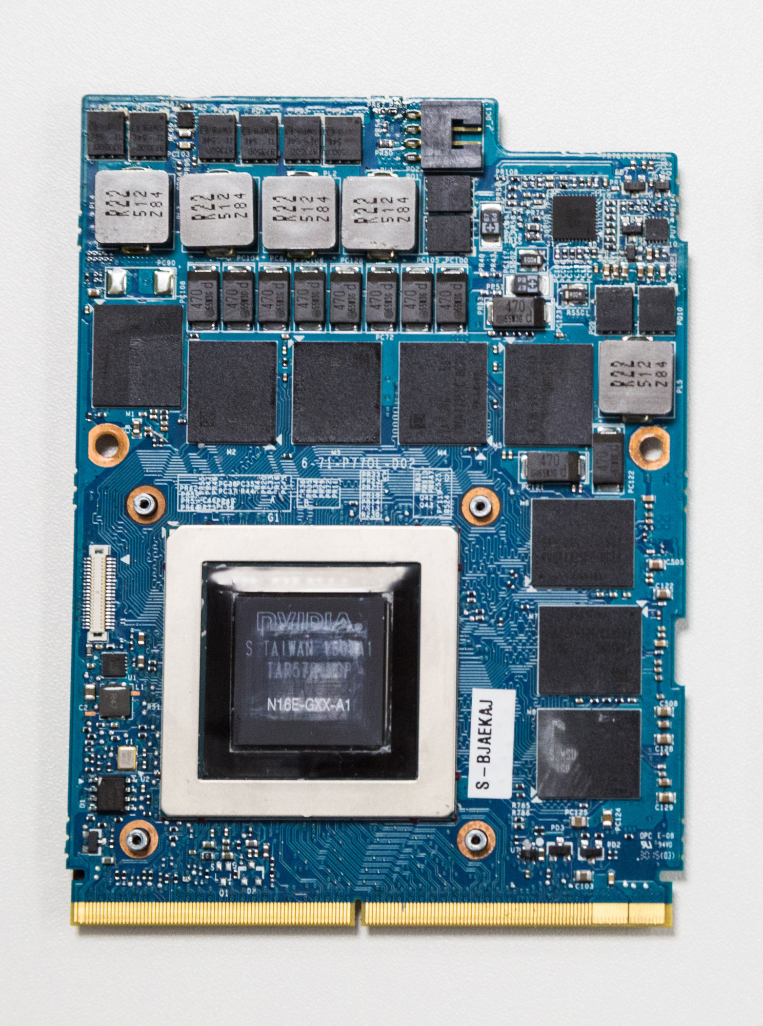

Yep, that is very much "it"! It's a Clevo card as used in the P775DMx...
They will need a bit of extra juice through that power connector, so its modding time on non-officially supported systems (also because of their additional length).
Clevo has been testing them since Q1, but has not published any SLI release plans, yet.
GTX 980 SLI here we come! D
hmmm, i wonder if itll also do without the extra power connector...i guess itll depend on the clocks one is gonna be applying. and the only downside to that would be burning through the mobo cuz its not able to pass thru so many amps :D
Sent from my Nexus 5 using Tapatalk
Also depends on the vBIOS if it would fire up without the extra juice connected...plus we may need to mod the heatsinks and also accommodate the extra cm length.
Do-able for sure but not Plug'n'Play...

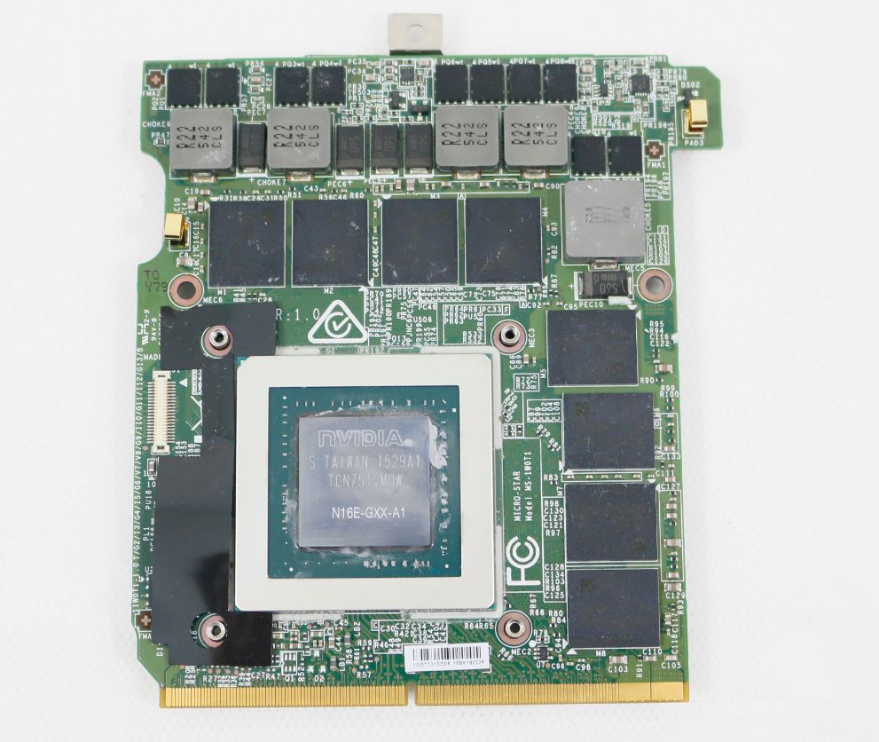

Unless they put inductors on the backside, that rightmost inductor is for the memory phase. What's weird though is it is only .22uH. Usually the memory has .56uH inductors, and the 680m had a 1uH. This will hurt memory clocks. Switching this out for a .56uH and piggybacking memory caps will be one of my first mods, assuming I can find this card for something < $800. Otherwise I will likely be getting a used 980m.

Nice. How much did those extra caps help with overclocks btw? I got an extra 26MHz doing that to a 680m.
In regards to the SATA slot, I think I would skip the caddy and replace the slot with a hacked desktop cable so that the SATA is still usable. Saves money, the optical bay, and 2x as fast.
