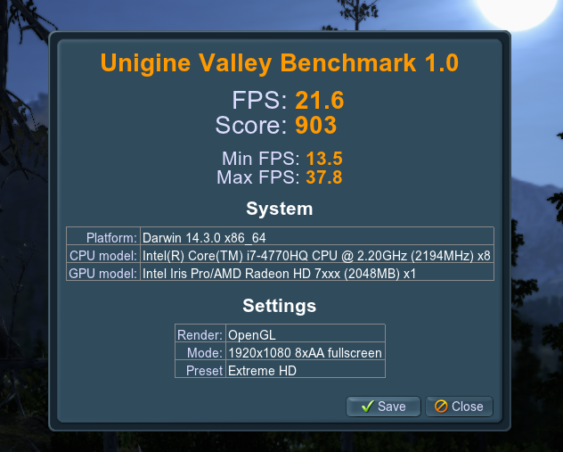

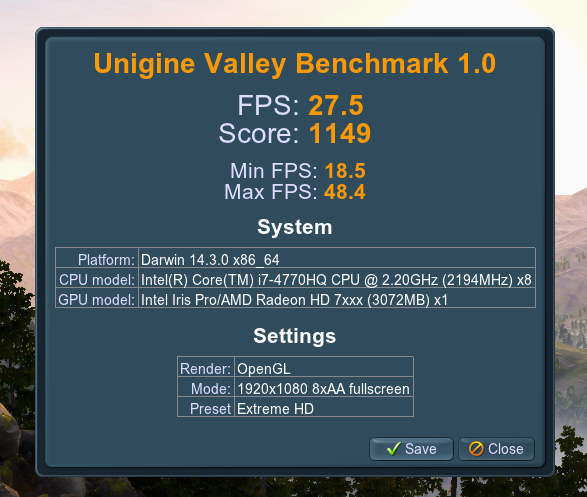

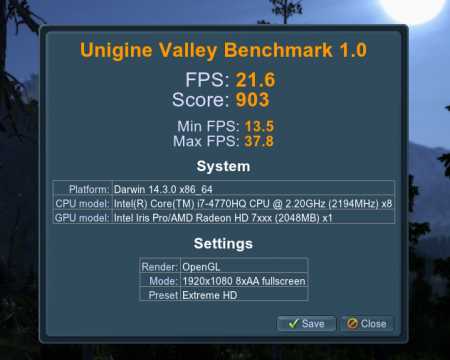

These are some shots of extensions loaded and some basic benches.
Should get 35fps in Valley.
Here is my screenshot with the 2014 15” rMBP Iris Pro + AKiTiO + HD 7970:
As said, OpenGL performance is not optimized for OS X, R9 280X should give similar results, maybe a bit better because of higher clock speed.
I got a 7870 under 100€ and considering that, not many frames away from HD 7970:
Obviously OS X bottlenecks the pixel rendering speed with high-end AMDs. Windows is much better gaming platform. OpenCL computing is that where AMD rules, but Maxwell cards have catched up somewhat. I am waiting for the new R9 380X. Competition develops technology.
