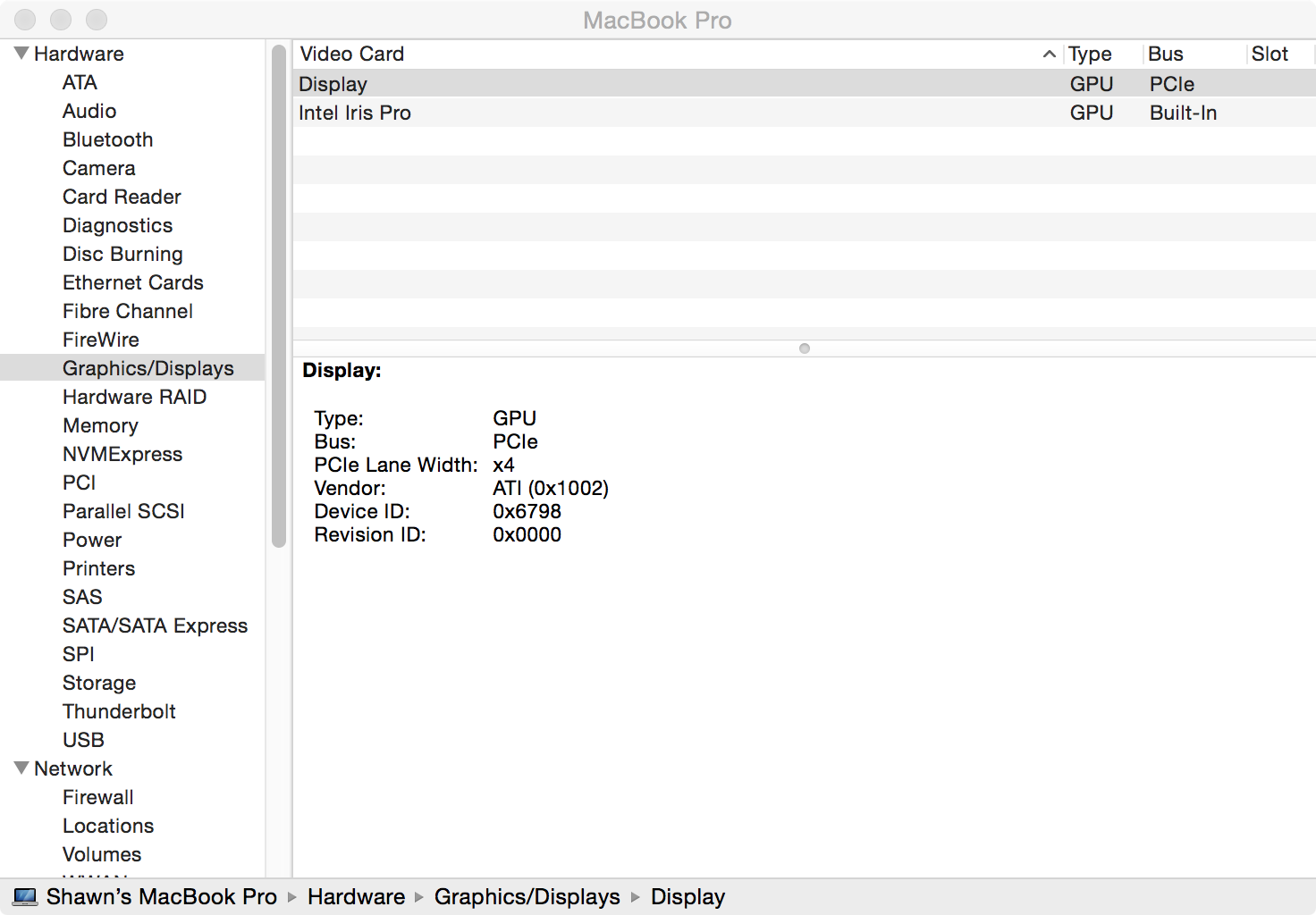

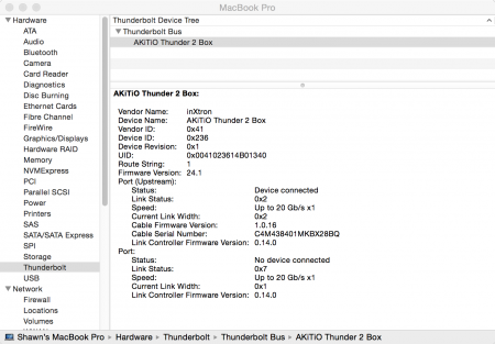

Been lurking for a while. I wanted to share some of my experience with the AKiTiO enclosure.
I am specifically trying to make AMD cards work with Yosemite, as I have a Iris Pro only mid 2014 rMBP, and cannot get external displays working with my GTX 750Ti...
I have only been able to get a couple of cards to work (Microcenter is starting to get tired of me exchanging cards every other day.). Finally, decided I am going to fight to get the R9 280X to work with Yosemite, even though it's larger and more expensive than I originally wanted. While I;m having trouble with Yosemite, I decided I would try Win8.1/BootCamp and see if at least the hardware worked.
First I bought a larger 10A(120W) power brick, did the tape trick and soldered power to the PCIe slot to support 75W to the slot. I used a Corsair CS650M ATX power supply for the 6 and 8 pin power to the XFX R9 280X DD 3GB card. Not wanting to mess with the enclosure yet (in hopes someone will figure out the nvidia output on the iris pro rMBP), I have the PCB naked on my desk.

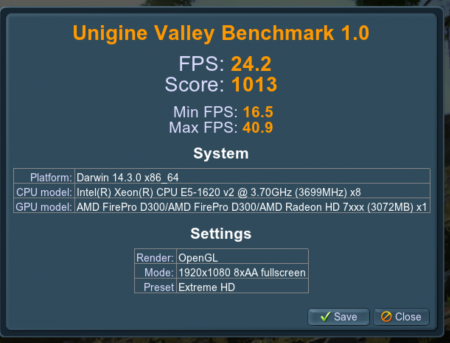

First boots into windows, were ok at the desktop, but unique heaven at anything above 1280x720, or using full-screen caused failure (blinking screens, crashes, or snowy)... I thought maybe it was the two different power supplies, I went ahead and soldered 2 x 18g yellow and black wires to the CPU 8pin connector on the Corsair ATX PS. Making the ATiKiO completely running off of the Corsair PSU.
Immediately saw improvement in Windows 8.1, boots perfectly, and runs Heaven at full screen @1080p, with HIGH settings, and 2X AA, it ran smoothly and perfectly. AVG FPS was somewhere around 50FPS (can't remember off the top).
So the dual power supplies were causing some instability.
Now if I can figure out how to get Yosemite to boot fully with the IOPCITunnelCompatible injected into kexts, I would be happy...

I performed some more tests, under clocking the card. something came to light while i was testing... The CPU fans were never spinning up, and the rMBP was getting very warm, so I installed fan control for bootcamp, and cranked up the fans... It got a little more stable...
I managed to get thru the full test at 850mhz, one time, then crash, same at 800mhz, and again at 775mhz... It only seems to like the test once, before crashing. will not run a second time. this is a little more positive, based on the fact that it wouldn't get but 2 or 3 seconds into the physics test... now it completes the test once...
and on the second time thru, it's 10-15 seconds into the physics test before it crashes.
however... I'm still stuck with Yosemite... just won't boot... I could create a provisional guide on this, but I certainly wouldn't call it successful yet.

Hi all...
Let me start by saying, I'm not a gamer... like my experience with gaming is BlackOps 2 with my son on the PS3... (when he was in high school, a few years ago), or PC gaming, I played Quake 3 arena, and got talked into Tribes for a while... anyway... Not a Gamer...
I set out on this eGPU quest, because when i got rid of my Mac Pro2,1 I decided to build a hackintosh... After a couple years of on Ivy bridge, I upgraded to Haswell, and the futzing around with the nuances of getting sleep working after upgrading to Yosemite, i gave up and bought the rMBP.
So I'm used to 3 1080p monitors, and using every port on this mac to get 3 monitors, external gigabit, wireless key/mouse, external raid array, speakers, time capsule, printer, etc... I decided, ok, I need a way to dock this thing, and allow portability... Also I want to offload the video for audio/video projects to an external GPU instead of heating up the macbook.
Long intro, but wanted you to have the background.
Out of the gate i determined GTX750Ti was the way to go, no external PSU needed, if i upgrade the power brick for the AKiTiO...
Got it working in Yosemite, with very little fuss, only one problem (which i found after i set it up) -- NO external video for Iris Only rMBP...
So I set out on a quest to get similar AMD card... Tried the following cards:
XFX R7 250X 2GB
Saphire R7 260 2GB
Saphire R7 270 2GB
XFX R9 280 2GB
XFX R9 280X 3GB
The only one to completely boot in Yosemite was the 260, but it had no acceleration... the rest will not finish boot cycle once I either added their Device Ids to the appropriate section of X3000 or X4000 kexts and added the PCI Tunneling to the 7000 or 8000 kext files.
So since I know that the R9 280X is a rebranded 7970 and the Hackintosh community has had great success with it, I am planning to stick with it for now...
Setup...
mid-2014 15" Retina MBP Iris Pro 16GB, 256GB SSD
AKiTiO TB2 Enclosure that I have modded in the following ways:
  • Corsair CS650M ATX power supply (474 watt 12V rail)
  • soldered power to PCIe slot from main power (per Tech Inferno Fan's guide)
  • taped off pins 1-6 on thunderbolt to PCIe connector
  • I added C3 and C4 capacitors (same guide)
  • I added soldered connections ( 2 x 18gauge wires 2 yellow/2 black) to the ATX power supply (CPU) for the main power connector to ATiKiO.
  • Removed PCB from chassis, naked on the desk...
XFX R9 280X DD 3GB (rebranded AMD 7970 (clocked at 850Mhz / can be boosted to 1000Mhz))

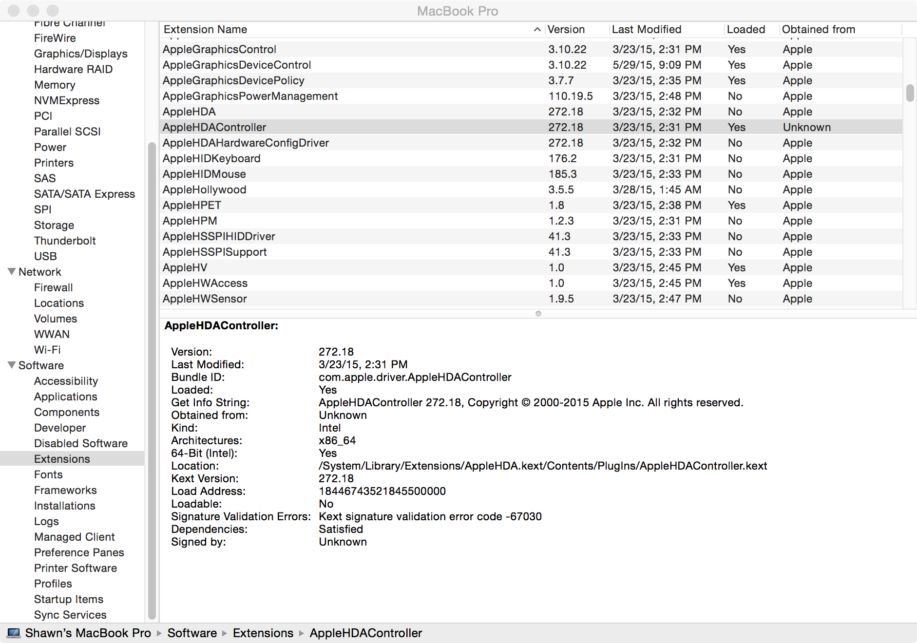

I tired kext edits in both Mavericks and Yosemite, before i add the IOPCITunnelCompatible line to the AMD7000 kext, the computer boots and the other AMD kexts are loaded... and shows the device in System Profiler, as soon as I add the kext change to AMD7000, it will not finish booting.

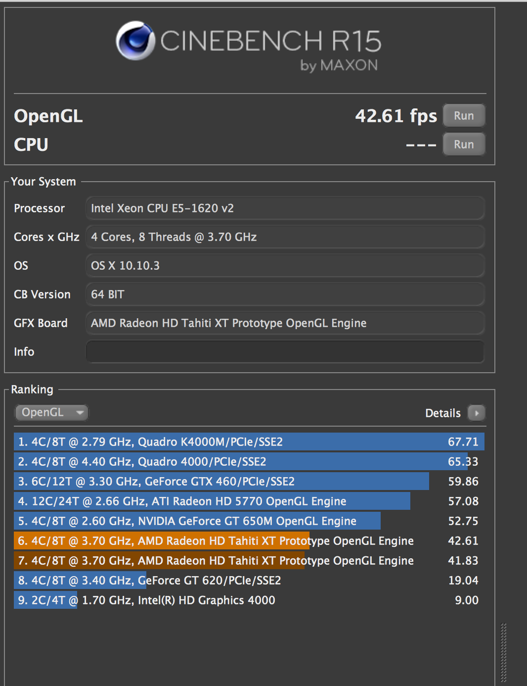

So, I decided to install windows to test the hardware setup under bootcamp. installed win8.1 on a partition, and card boots like a champ.
It does fail to complete 3DMark11 Physics test, unless I underclock it. If I under clock the CPU, it will complete the benchmark test, once, upon second attempt, it will fail the physics test.
Now keeping in mind, I'm not a gamer, I don't really care about 3d benchmarks personally... but... i do want the offloaded graphics...
So I would like to get Yosemite working.

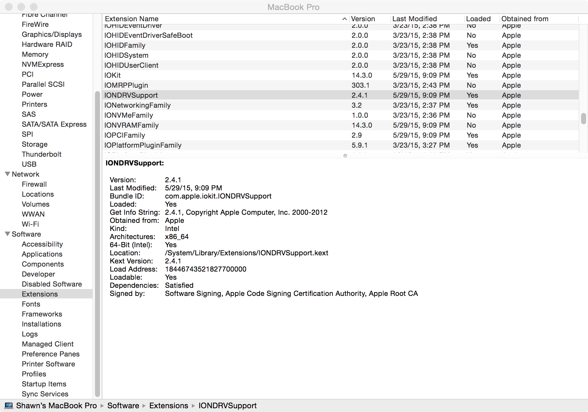

Here's what I did to fresh Yosemite install:
added IOPCITunnelCompatible to IONDRVsupport, AMD7000Controller, AMDSupport, AppleHDAControler
boot args = kext-dev-mode=1 -v (even tried dart=0, nv_disable=1)
no peripherals attached (except the USB SSD with fresh Yosemite install).
Symptom:
gets thru loading the OS and the last step before it loads the GUI, then freezes.
It appears to me either an issue with Power Management kext or AMDFramebuffer kext, based on what the Hackintosh community has to say about getting this card to boot. Since we don't use Clover, i don't know the best way to inject frame buffer changes, or how to use some of those fixes.
I've thought about modding the ROM on the card (either using netkas tutorial or sending to MVC) adding AMD apple EFI to the ROM, but not sure that will do any good, or harm.
Any experience you all have that might help would be appreciated.
TIA
--BrayNShocK
@goalque, I used your guide :)
One thing I noted, I think since you had probably done some work with Nvidia cards, you had already modded the IONDRVSupport kext, it was missing from your guide for the 280x, but system logs had the "missing IOPCITunnelCompatible" line for that kext, so I added them it there as well.
Understood on the low power situation, thanks for the explanation.
It looks like i either need to go on a quest to figure out how to make Nvidia cards produce external output on my rMBP or buy a Nestor to make my AMD stable. hmmm what to do, what to do :)
@Tech Inferno Fan, I did add C3 and C4 caps to my AKiTiO... didn't seem to make any change in stability for the AMD card. (Using the ATX PS as only power source and ditching the 120W power brick did however.)
Since I'm only using the ATX PSU for all power, I'm just using the built-in power switch on the PSU. (of course I have the green wire bridged to permanently ground)
I'm wondering if I need to wipe my internal Yosemite install and start from scratch again...
Do you think using an apple EFI would help, or unnecessary, it's something else?

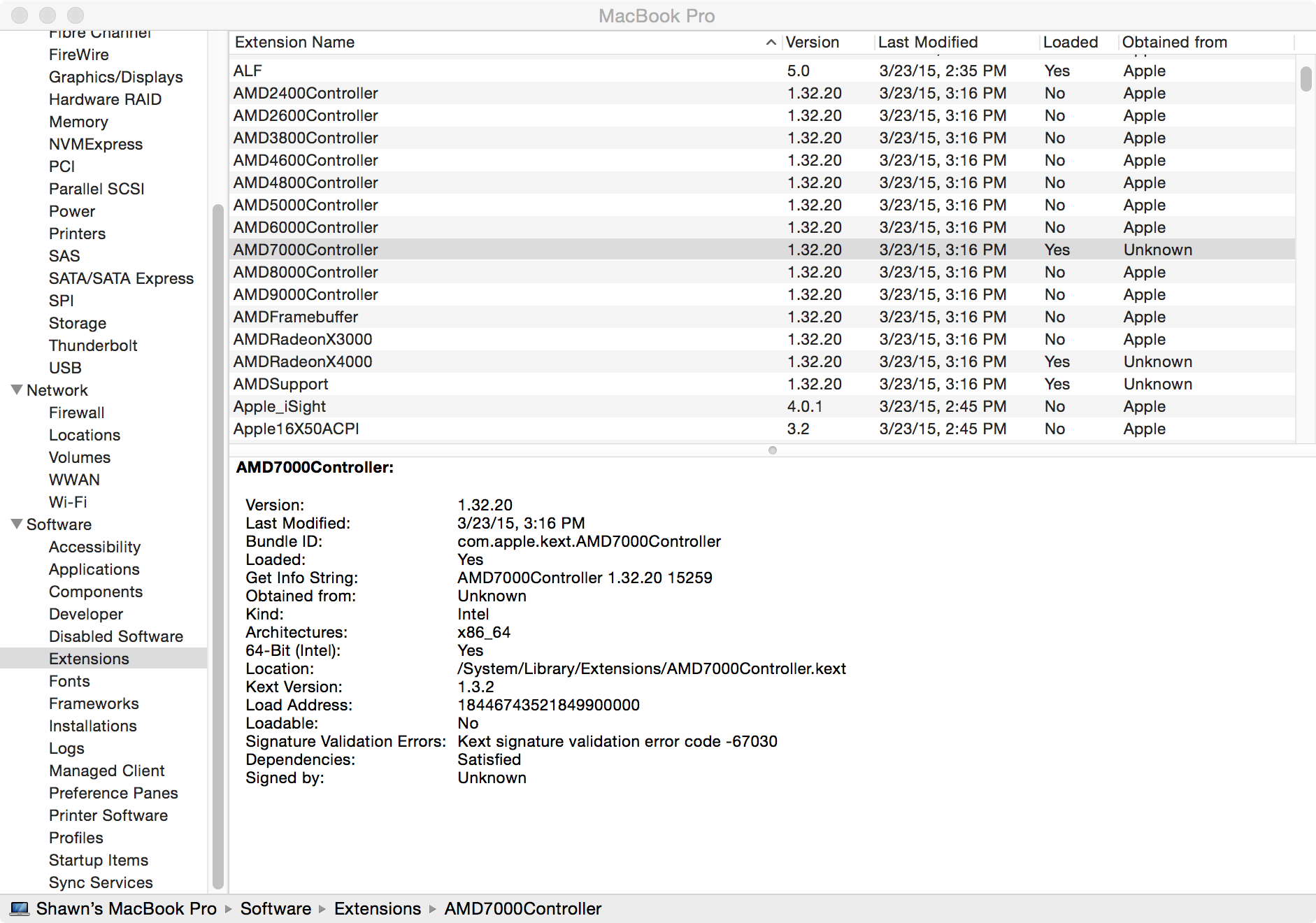

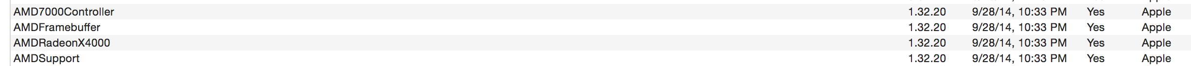

That’s quite a bunch of AMDs! :D
Did you add IOPCITunnelCompatible true value for AMDTahitiGraphicsAccelerator block in AMDRadeonX4000.kext when tried 280X?
I have a plan to make the process fully automatic by using regular expression patterns in kext mods instead of XML structure looping or query.
No need for ROM flashing if you use AMDs. I have tested newer and older AMDs on Yosemite with the AKiTIO and Netstor, they work out of the box, giving 100% external screen output, blow away Nvidia in OpenCL performance. OpenGL is notably slower with AMDs. The only issue is R9 + AKiTiO combination in low power conditions, and it likely has nothing to do with your boot problem.
I made some progress with the Nvidia eGPU screen output, found the Iris Pro device ids from the frame buffer binary data. If I am able to accelerate the internal retina screen as well, I will let you know. For free and open source.
Send PM and I am happy to check if the kexts are ok. I have the same Mac.
Thanks :)
Yes I added the IOPCITunnelCompatible true value to Tahiti section of X4000 kext.
The only two AMD cards that I've been able to boot are a lowly 6450 and the XFX R7 250X, but neither had acceleration. They ran unique heaven at 3-5 FPS.
The rest would not boot. Even adding device IDs and the IOCPITunnelCompatible=true to the kexts (each card of course required different edits).
My guess is I've done too many kext edits and something is causing the problem, so I'm running a backup, and I'll blow Yosemite away and try a fresh install on the internal SSD. Maybe I'll try clearing the PRAM and SMC reset first...
I'll keep at it, once I've done the fresh install, I'll send you the kexts so you can double check if I still have the problem.

Hmm.. the external SSD may have an influence. I just bought Samsung SSD T1 250GB, up to 450MB/s reading speeds via USB3, that’s amazing.
And yes, IONDRVSupport + AppleHDAController kext mods are recommended, but I remember that they were not necessary - even though system log showed missing IOPCITunnelCompatible rows for them. kext-dev-mode=1 only, no other boot arguments.
The device id for 280X is 0x67981002, should be ready in the kexts.
Good luck with the fresh install! By the way, some AMD vendors offer UEFI compatible VBIOS, I think that's the reason why my Asus AMDs show smaller boot screens icons in retina screen, but some other show the normal icon size.

We have found that Tahiti cards on 2014 Mini run at approx 2/3 speed. They get 22FPS in Uningine Valley Extreme HD preset while same card in cMP would get 35fps. Likely similar to the bug they have in 3,1 MP.

Goalque, do you still have a R9 280x in a eGPU setup? Curious how they did in Uningine Valley.
When we tried in 2014 Mini the 7970 would have same speed issue as in 3,1. It ran Uningine Valley in Extreme Preset at around 22FPS. Should be around 35FPS.
So it has some power management issue. I will try with the nMP and see if it is same. I may try to run the Physics thing, though I haven't put any AMD drivers on my Windows installs and have been trying to avoid it. In brief testing in nMP I had same "error 12" issues as with Nvidia cards so I gave up.

I re-installed Yosemite on primary drive.
Only changed 4 kexts:
AMDSupport
AMD7000Controller
AMDRadeonX4000
AppleHDAController
Then of course ran 'kextcache -system-caches'
It boots on the LCD, System Profiler shows the generic "Display" under graphics/displays, Device ID 6798 as it should.
Does not show it as an AMD 7xxx
Syslog shows "IONDRVFrameBuffer missing IOPCITunnelCompatible"
If I add IOPCITunnelCompatible to IONDRVSupport kext, it does not boot, I have to disconnect the AKiTiO boot.
Any suggestions?
--BrayNShocK
