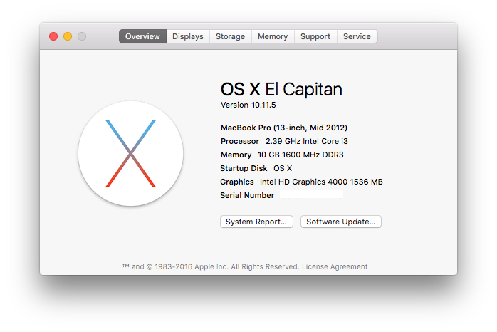

Oleksii_S Posted May 19, 2016 Share Posted May 19, 2016 Hello. Sorry for my english I am new in this topic. I have Dell Latitude E6430 with OS X El Capitan installed. I have managed to work all hardware under OS X. OS updates like real mac ))))) I changed only two things: - I remove stock wifi with BCM94322MC - native OS X support - I remove stock wwan with Huawei EM770 - add one string into info.plist to get it work * Not for OS X, but i changed DVD drive with opty bay - 1Tb HDD inside Here is my full spec: i3-3110M*10GB*HD4000*BCM94322MC*Huawei EM770_WWAN*IDT_92HD93BXX*Intel_82579LM I am planing to change processor with i7-3540M I don't have Optymus, I have only iGPU. So it is principal to me have 2 cores and iGPU with 1.3GHz without any tweaks ))))) I have a few questions. What TPD has my cooling system? Can I remove stock keyboard with lighting keyboard? Can I change screen with full HD resolution? Quote Link to comment Share on other sites More sharing options...

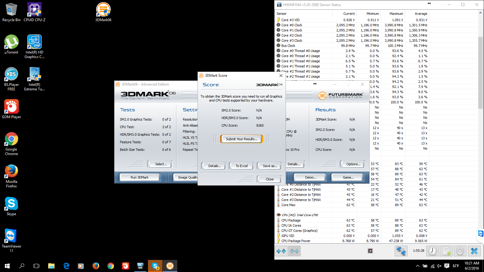

deathwingbg Posted June 1, 2016 Share Posted June 1, 2016 (edited) Hey guys I got 3720QM ES (QBC1) i was able to get it to 4x4.0Ghz (40x/40x/40x/40x ~8200 points in 3dmark2006 processor) setting UEFI variables but anything more than that causes windows to freeze while loading... I tried Intel XTU but the multiplier sliders are gray and if UEFI vars are not set the multipliers are 32/31/30/30 (other people also reported this for this particular CPU. Do you know a way to push that further? I read the whole thread. Big thanks to @badbadbad, @Tech Inferno Fan, @Khenglish, and @timohour I followed some of their guides. Know that i will have throttling issues and so on but could not find if setting higher multis is possible. BTW i have the latest BIOS A18 do you think that will be a problem as well? Will i be able to flash an older "unlocked"/modified bios? Edited June 1, 2016 by deathwingbg Quote Link to comment Share on other sites More sharing options...

deathwingbg Posted June 1, 2016 Share Posted June 1, 2016 Thank you! Actually it uses very low voltage for 40x ~1.09V (will post pictures later as i am at work) and draws ~47W max ... the PSU is 90W (Nvidia model). Already ordered 120W universal PSU to avoid throttling as suggested. I observed erratic throttling using different benchmark tools. Temps were OK ~90c Will experiment more with the UEFI variables. BCLK will be nice if i have the time. I am running the RAM at 1866Mhz (was not able to push it to 2133) 2x8GB Crucial (ct102464bf160b) Quote Link to comment Share on other sites More sharing options...

deathwingbg Posted June 2, 2016 Share Posted June 2, 2016 The 3720QM ES (QBC1) won't go for 41x even for 1 core... at 40x while benching i get hardware errors. Still cannot figure out why... Maybe the power supply is not enough or it does not like the heat. Will test more today. Also i am not quite sure it measures the Voltage correctly as i think 1.09 is too low for 40x. IS there possibility OS/drivers to be the problem since i replaced the working 3720QM ? Here is the SS as promised. Quote Link to comment Share on other sites More sharing options...
deathwingbg Posted June 2, 2016 Share Posted June 2, 2016 (edited) OK found the issue ... I set the multis back to 40x/39x/38x/38x started Intel XTU and measured 110W at the power plug ... which equals ~90W as the PSU is rated. The Benchmark was TDP trottling. The "CPU package power" went up to 53W+ Edited June 2, 2016 by deathwingbg Quote Link to comment Share on other sites More sharing options...
Khenglish Posted June 2, 2016 Share Posted June 2, 2016 (edited) Power supplies don't cause throttling. Your laptop won't sense that it is at the psu power limit and throttle itself. Instead power supplies just turn off if their current rating is exceeded. In the case where the power supply is too weak its not so much as your laptop is throttling but instead that it is running on battery. Some power supplies automatically turn back on after a few seconds, but most stay off until you unplug them from the wall and plug them back in. Your problem is the cpu's low default vid table. You need to set the "additional turbo voltage" in ifr to raise the voltage. I can't remember if latitudes have access to this or not though. Edited June 2, 2016 by Khenglish Quote Link to comment Share on other sites More sharing options...
