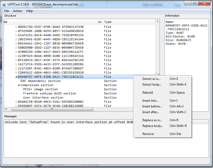

  1. Download the E6530 A.16 bios from Dell's website
  2. Apply python script at http://forums.mydigitallife.info/threads/44785-I-present-you-a-tool-to-decompress-Dell-UEFI-BIOS to generate E6530A16.exe_decompressed.hdr decompressed BIOS file.
  3. Open E6530A16.exe_decompressed.hdr in UEFITool 0.18.8l . Select File->Search and type 'SetupPrep'. Clicked the found string in the messages area will point you to the "User interface" section. Highlight the FILE section above it, right clicking and do a 'Extract as is' . Save it as E6530-setup.bin. This is shown in the image below:s45PANu.png
  4.
  5. Apply donovan6000's Blog: Universal IFR Extractor on E6530-setup.bin which will yield in E6530-A16_IFR.txt containing the UEFI variables.

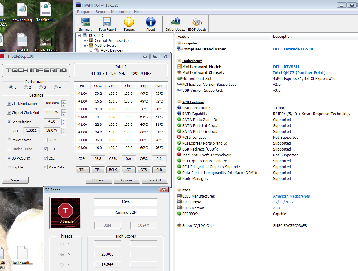

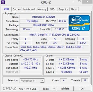

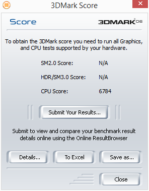

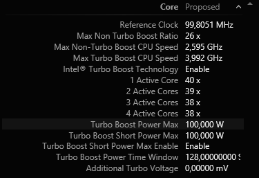

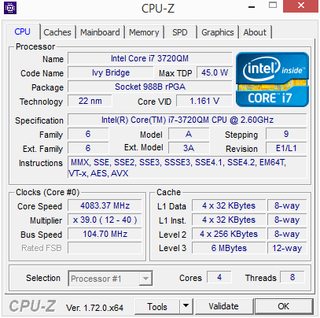

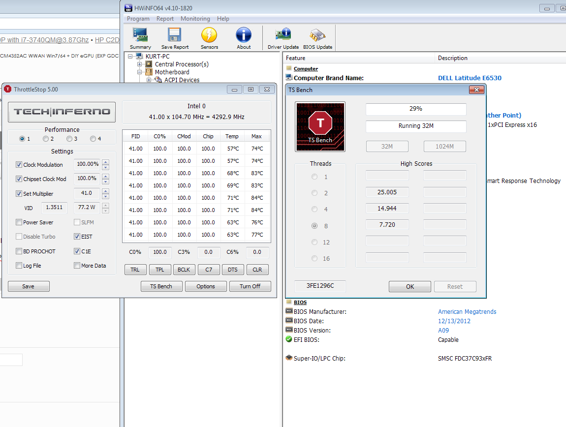

Hey the NVRAM writing tool works, and I just found the turbo ratio limits section of the NVRAM with an xm CPU... brb
Update:
Overclocking this ES 2920xm by writing in the NVRAM has the same problems as it did when this CPU was in my P150EM. It will set, but it doesn't do anything. Both XTU and Throttlestop read the CPU as being set to 4.2ghz, but it doesn't do it. To get the CPU to overclock in my clevo I needed to flash the overclock directly into the BIOS.
It looks like the overclocking would work if it was a non-ES CPU. I suspect my 3920xm would overclock fine, but I don't want to switch the CPUs to find out due to how huge of a PITA it was to mount a e6520 heatsink onto a e6530 motherboard.
Update:
Overclocking is working! The problem seems to be that the primary current power plane is set too low for 4 cores to go over ~3.1ghz. Trying to fix that now.
Update:
OK so I couldn't change the primary plane current because the NVRAM only has 8 bits to store values and it's a 16-bit register, so the highest override I could set in 8 bits was 30W.
Here's 4.3ghz running with the override off. I had hwinfo64 on to prove that this was on a latitude. I ran only 2 threads to keep the current draw down.
NVRAM locations for turbo multipliers were 0x25 through 0x28. I tried overclocking memory too, but it's still walled at 1600MHz. Underclocking memory did work.
Update:
The issue wasn't primary current plane, it was just BDPROCHOT!
Also disabling the TDP lock did not work, but hard setting it to 80W did.
As for the BCLK overclock I modified my ME FW to allow BCLK overclocking.
Quote
WOW!! Fantastic stuff. I see 77.2W and a x41 multi across 4-cores + your 104.7mhz (+4.7%) BCLK overclock, bringing you up to 4.3Ghz. Your temps max at 84 degrees during the TS-bench, incredibly low. Great cooling happening there. Your 22nm IVB i7-3920XM would have more TDP headroom and could go a higher multi than with your currently tested 32nm SB i7-2920xm (ES). Maybe even further than in your P150EM if it was being temp throttled in there.
Any chance you can do some more performance tuning to see how far you can take this beast? When done, attaching a recent eGPU (GTX770+) to the EC slot should see shoot to the top of some leaderboard scores if you wanted to try. Plus it's x2 2.0 eGPU capable using the first 2 mPCIe slots (port1+2).. though as you know a ME FW mod with the Intel fitc tool would be required to set port1 to x2 AND of course, x2 2.0 capable eGPU hardware like the recently released PE4C 2.x.
As this is quite an astonishing development for a business grade notebook, could you pls take some time to write a guide from the fragments we've covered so others can duplicate it? This WILL raise the Latitude/Precision systems' profile amongst it's other business grade peers. Even a i7-3840QM (3.6Ghz/4-cores + 400Mhz) could be hitting over 4.0Ghz with these mods, or 4.2Ghz with the BCLK overclock.
Thank you for being the first to push a IVB Latitude to these unprecedented performance levels 78.gif
LOL at the cooling. The 84C was only around 10 seconds into the test. I hit 100C in about 30 seconds. It what makes matters even worse is that running the 580 on the system the dGPU is "disabled" which means that it is always powered on and cannot be shut down with optimus. The cooling can only sustain around 50W of power draw. Other than overheating the CPU seems to clock just as well as it did in the p150EM, which is ~4.35GHz at 1.351V VID.
I'd do x2 2.0 opt for sure if I had the hardware, but I can't monetarily justify buying the hardware for it with the P150EM as my main laptop. The CPU cooling is literally over twice as effective.

Using the i7-3920XM instead of the i7-2920XM would lower temps too. Eg: consider a IVB uses about 10-14W less than a SB at the x27 4-core multi shown at [url]http://forum.techinferno.com/throttlestop-realtemp-discussion/6958-haswell-step-backwards-ivy-bridge-i-have-some-shocking-tdp-results.html#post95181[/url]
Yes the dGPU is always sucking power and making heat. I'll try what you listed soon to see if it helps.
IVB does use considerably less power than SB at the same clocks and voltage and is slightly cooler overall even with IVB's smaller die size. From my testing it's 100W vs 85W at 4.3ghz and 1.351V in prime95. I think your testing looked even more favorable due to a lower voltage on the IVB.
here's 4.4ghz with the 580. Low cpu score due to overheating and the 80W tdp is too low for that speed.

Unlocking i7-37x0QM/38x0QM extra 4 multipliers on a Dell Latitude E6430
For a full guide on how to do this check the first post.
It works!!
Just used the NVRAM tool to set my core limits x40 (1C), x39(2C), x38(3-4C) and my 3720QM and it works!!!
Only problem is that I have to set my long time TDP a little higher cause after around 40 sec anything above x35 (x36,x37,x38) would throttle down to x34,x35.
(Not because of thermal limitatiofns. I could see that my 3630QM would throttle due to thermal reasons when it reached 105C.)
UPDATE: Regarding my long power limit I set [ Long duration power limit 0xB40], [Short duration power limit 0xB41] at 100W (0x64) and my [ Long duration maintained Variable 0xB42] at 128sec (0xff) (not sure if the last is necessary). But I can tell that there is no more TDP throttling now.
TDP throttling kicks in after ~ 6 minutes OF 100% CPU Utilisation! Only solution as mentioned by Khenglish here is to use an invalid adapter and use Throttle stop to overcome the invalid adapter throttle.
Also seems like max VID for this is CPU is limited to 1,2109V starting @ x37.(check the table on the previous post). This means that there is plenty of room for undervolting here. Any ideas?
Setting single core @ x40 did significally lower my headroom for BCLK OC. It would BSOD if I set anything over 102.4 in XTU. Highest single core OC 4.09GHz!!!
So I decided to limit the CPU up to x39 using XTU for both 1C & 2C, and set my BCLK @ 104.7.
This way I can have a 1C/2C Turbo @ 4.08GHz vs 3.98GHz and a 4C Turbo @ 3.98GHz vs 3.88GHz + I can take advantage of raised BCLK and OC my RAM @2234MHz + I would run similar clocks with lower voltage (BCLK OC does not cause an automatic voltage increase)
3DMark06 CPU score had a great improvement of almost 1100 points compared to the stock chip or an OCed 3630QM and almost 1500 points compared to my 3630QM @ stock.
i7-3720QM stock
i7-3720QM OCed

I never figured out how to undervolt. The best you can do is use BCLK as high as possible, since BCLK overclocking does not cause an automatic voltage increase, which multiplier increases do.
Awesome! What sort of temps are you seeing running say TS bench at full 4C (unlocked) mode (x38)? Are you being temperature throttled there? Based on temps, is there headroom to consider getting a i7-3740QM (x39 4-core unlocked) or even a i7-3840QM (x40 4-core unlocked).
Oh, and can you link the above post in your E6430 thread? I've headlined a E6430 recommendation over the 2570P as the superior performance platform with not much weight/size penalty at http://forum.techinferno.com/hp-business-class-notebooks/2537-12-5-hp-elitebook-2570p-owners-lounge.html#post33901 linking your excellent thread in the process.
