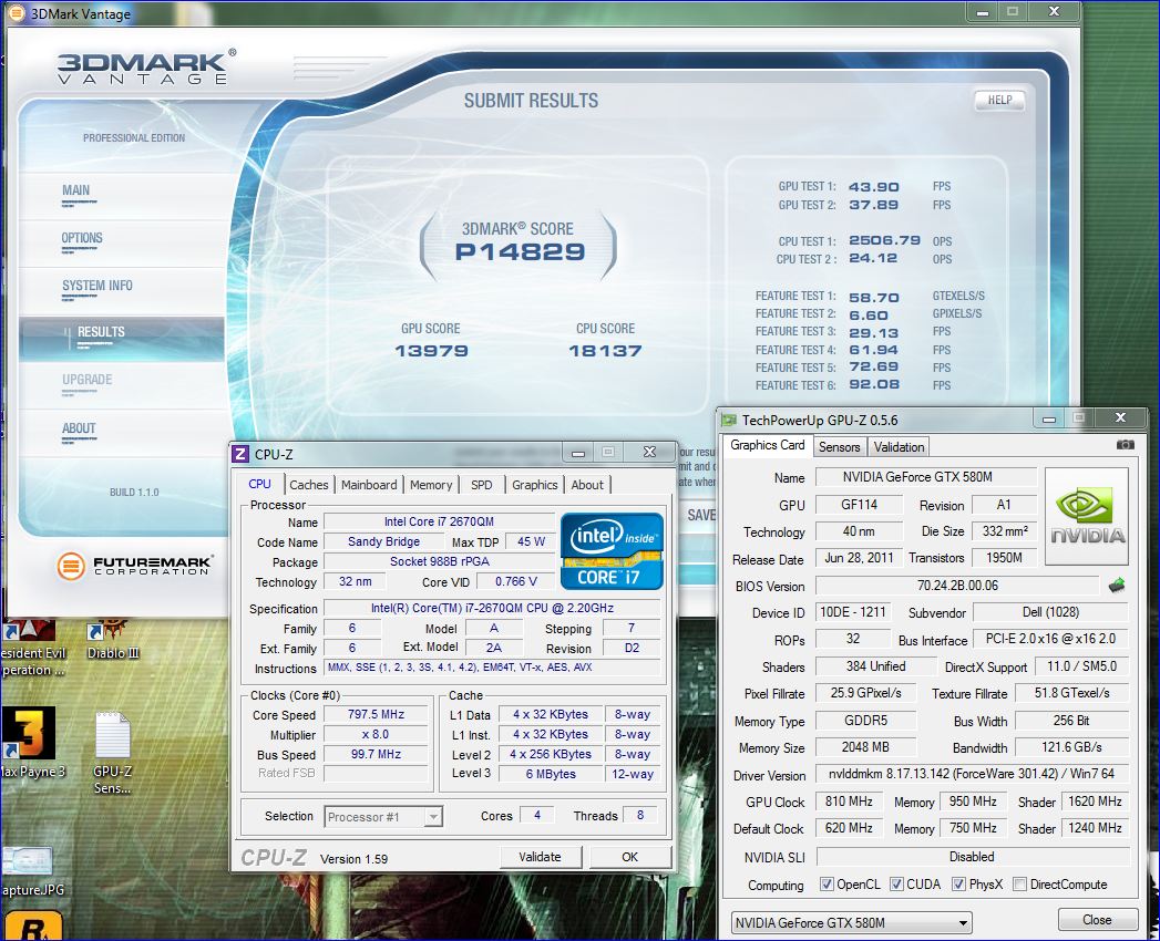

atekk920 Posted June 29, 2012 Share Posted June 29, 2012 Recently grabbed this benchmark on my system...upgraded to the GTX580m and so far I am beyond unhappy with the performance gains over the 560m, does this seem right? I have overclocked as far as I can go and even used the modified VBIOS to eliminate the notorious throttling issue but still just feel disappointed - feedback is appreciated. Quote Link to comment Share on other sites More sharing options...
Jimbo Posted June 29, 2012 Share Posted June 29, 2012 Something is definitely up, this is the score @widezu69 put in the charts - http://forum.techinferno.com/attachments/alienware-m17x/2370d1316477565-capture.jpgGiven your better CPU score, you should have been lineball or slightly ahead. Quote Link to comment Share on other sites More sharing options...
atekk920 Posted June 29, 2012 Share Posted June 29, 2012 Something is definitely up, this is the score @widezu69 put in the charts - http://forum.techinferno.com/attachments/alienware-m17x/2370d1316477565-capture.jpgGiven your better CPU score, you should have been lineball or slightly ahead.anyone out there in T|I land care to lend a hand resolving this I'm assuming drivers is as good a place as any to start? Quote Link to comment Share on other sites More sharing options...
svl7 Posted June 30, 2012 Share Posted June 30, 2012 Drivers definitely is a good place to start. Also check whether you have tons of unnecessary stuff running in the background. Your score is a bit off, but not completely....Can you provide a GPU-Z log of a 3dMark11 or a gaming session? Just attach it to a post. Quote Link to comment Share on other sites More sharing options...
atekk920 Posted June 30, 2012 Share Posted June 30, 2012 Link to log is below, I grabbed it during a vantage run - driver version is 301.42 thanks for the helphttps://www.box.com/s/8fd8214a90ee766fe438 Quote Link to comment Share on other sites More sharing options...
svl7 Posted June 30, 2012 Share Posted June 30, 2012 I guess this must have been a very inconsistent and laggy run... it's weird. I see you overclocked the card to 810MHz and cranked up the mem, but the GPU load drops after a short while, and then is 0 for a long time before the card resets the clocks to stock 3d values. Then everything looks fine, though the overclock isn't anymore... curiously the card changes back to the OCed clocks after a while and then the load drops again.Temps are great... I'm not sure what's causing this issue. You seem to use a modified VBIOS, is that correct? If so, can I take a look at it? Quote Link to comment Share on other sites More sharing options...
mw86 Posted June 30, 2012 Share Posted June 30, 2012 Weird sounds like a throttle and driver issues. Your not reaching 78c right... they seem to drop at that temp no mattter what under load. Light load you can reach 90c plus no drops...Id try the above linked driver. Do a full clean driver install and make sure you didnt tell any options to be turned up on the global 3d settings. Like dont force fxaa for all apps, leave AA and others at application preferences. Is this vboios the right one the goal is to have p0 and p1 state match Quote Link to comment Share on other sites More sharing options...
widezu69 Posted June 30, 2012 Share Posted June 30, 2012 Definitely some kind of CPU throttling I say. Quote Link to comment Share on other sites More sharing options...
atekk920 Posted June 30, 2012 Share Posted June 30, 2012 I guess this must have been a very inconsistent and laggy run... it's weird. I see you overclocked the card to 810MHz and cranked up the mem, but the GPU load drops after a short while, and then is 0 for a long time before the card resets the clocks to stock 3d values. Then everything looks fine, though the overclock isn't anymore... curiously the card changes back to the OCed clocks after a while and then the load drops again.Temps are great... I'm not sure what's causing this issue. You seem to use a modified VBIOS, is that correct? If so, can I take a look at it?Im using the VBIOS that widezu69 made available in another post here:[Guide] 580m GTX throtting fix. No need to modify system Bios.When i installed the card it smelled very badly of burnt electronics but i thought nothing of it....Im going to try and reach Dell for a replacement but anyone who has dealt with their tech support knows that its almost impossible to get good help from them...they will say "its your drivers" or "u need to reinstall windows" to date I have a bluetooth module that has never worked right from delivery and they refuse to replace it pointing to my windows installation as the issue....I'm fairly educated and have over 12 years experience in IT Support - I'm a harware compatibility tech for Western Digital's product testing labs, i know hardware fairly well and can tell when something is behaving oddly.....(sorry about the rant but I've had many many bad experiences with Dell support over the years)Thanks everyone for your input and direction - it is much appreciated.....in the meantime I'm going to roll back to previous drivers. Quote Link to comment Share on other sites More sharing options...
mw86 Posted July 7, 2012 Share Posted July 7, 2012 Im using the VBIOS that widezu69 made available in another post here:[Guide] 580m GTX throtting fix. No need to modify system Bios.When i installed the card it smelled very badly of burnt electronics but i thought nothing of it....Im going to try and reach Dell for a replacement but anyone who has dealt with their tech support knows that its almost impossible to get good help from them...they will say "its your drivers" or "u need to reinstall windows" to date I have a bluetooth module that has never worked right from delivery and they refuse to replace it pointing to my windows installation as the issue....I'm fairly educated and have over 12 years experience in IT Support - I'm a harware compatibility tech for Western Digital's product testing labs, i know hardware fairly well and can tell when something is behaving oddly.....(sorry about the rant but I've had many many bad experiences with Dell support over the years)Thanks everyone for your input and direction - it is much appreciated.....in the meantime I'm going to roll back to previous drivers.I have good news for you. First to relate i have had bad experiences too but over the entire thing in the end Alienware has stood by me 100%. I had a bad set of 580m but due to them grounding out. What i recomend is hold on and stick around. Aienware has made a small division to help on forums. The support started at NBR only but after a talk with the great reps helping over there Mark the lead tech organizing the effort has graciously decided to set up support here to. It may take a little setup but eventually a Alienware rep will be able to assist without any hoop jumping and should see no prob in getting your possibly bad batch of 580m replaced easily. So stay calm hanfg here and hang tight. As soon as this initiative is set up you should be able to get some assistance and even cooler right through the forum. Cheers my friend you are surrounded by friends here and we wknt steer you wrong. Take the calm approach and you will be taken care of im fairly certain. I remember when you posted about the install. Hang in their bro! Quote Link to comment Share on other sites More sharing options...
