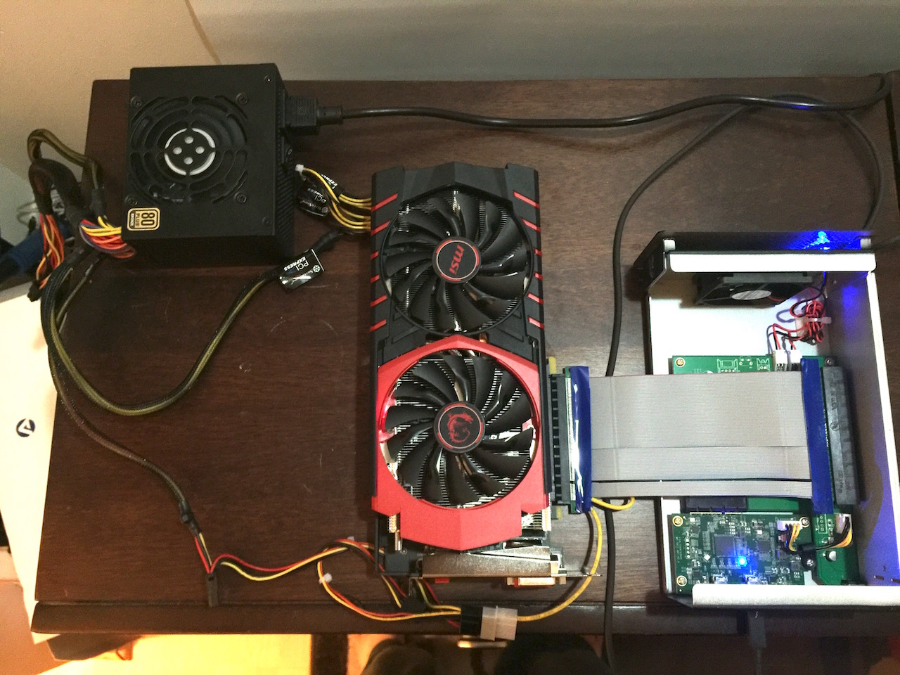

danielsuzuki Posted December 3, 2015 Share Posted December 3, 2015 Hi guys. I followed @goalque R9 390 + Akitio build and connected it to my 2012 MBP (non retina) running 10.11.1. The GPU and Akitio are powered by a 450w Silversstone PSU, and am using a power riser + molex. After using the autoscript (absolutely amazing work @goalque), I gained acceleration in OpenCL and graphics when connected to a secondary monitor. I am however getting a lot of screen flickering. The system also crashes after a few minutes after loading youtube or going into system pref. Oddly, graphically intensive work such as running Valley or FCPX haven't caused crashes. I read AMDs are generally not stable on Akitios, but I was wondering if there is anything I can try with before returning it and purchasing a Nestor NA211TB. Quote Link to comment Share on other sites More sharing options...
Tech Inferno Fan Posted December 3, 2015 Share Posted December 3, 2015 Hi guys. I followed @goalque R9 390 + Akitio build and connected it to my 2012 MBP (non retina) running 10.11.1. The GPU and Akitio are powered by a 450w Silversstone PSU, and am using a power riser + molex. [ATTACH=CONFIG]16729[/ATTACH] After using the autoscript (absolutely amazing work @goalque), I gained acceleration in OpenCL and graphics when connected to a secondary monitor. I am however getting a lot of screen flickering. The system also crashes after a few minutes after loading youtube or going into system pref. Oddly, graphically intensive work such as running Valley or FCPX haven't caused crashes. I read AMDs are generally not stable on Akitios, but I was wondering if there is anything I can try with before returning it and purchasing a Nestor NA211TB. Yes, remove the PCIe riser to ensure best Gen2 signalling. We have many examples of flakey Gen2 signalling as soon as an additional extender board (or socketted cable) is introduce. Easiest way it to remove the the AKiTiO Thunder2 board from the chassis and connect the video card into the board. Then connect your PSU using a molex-to-barrel adapter to supply board+PCIe power and connect the ATX PCIe power connectors to the video card. Quote Link to comment Share on other sites More sharing options...
danielsuzuki Posted December 5, 2015 Share Posted December 5, 2015 Yes, remove the PCIe riser to ensure best Gen2 signalling. We have many examples of flakey Gen2 signalling as soon as an additional extender board (or socketted cable) is introduce.Easiest way it to remove the the AKiTiO Thunder2 board from the chassis and connect the video card into the board. Then connect your PSU using a molex-to-barrel adapter to supply board+PCIe power and connect the ATX PCIe power connectors to the video card.Thanks @Tech Inferno Fan. I gave it a try by connecting the GPU directly to the PCIe and powering the Akitio with 2x Molex to 1x barrel plug but I'm still getting the same results. Screen flicker on the desktop and instability after about 5 minutes. I'm going to try a fresh install of 10.11.1 to see if it helps. Quote Link to comment Share on other sites More sharing options...
