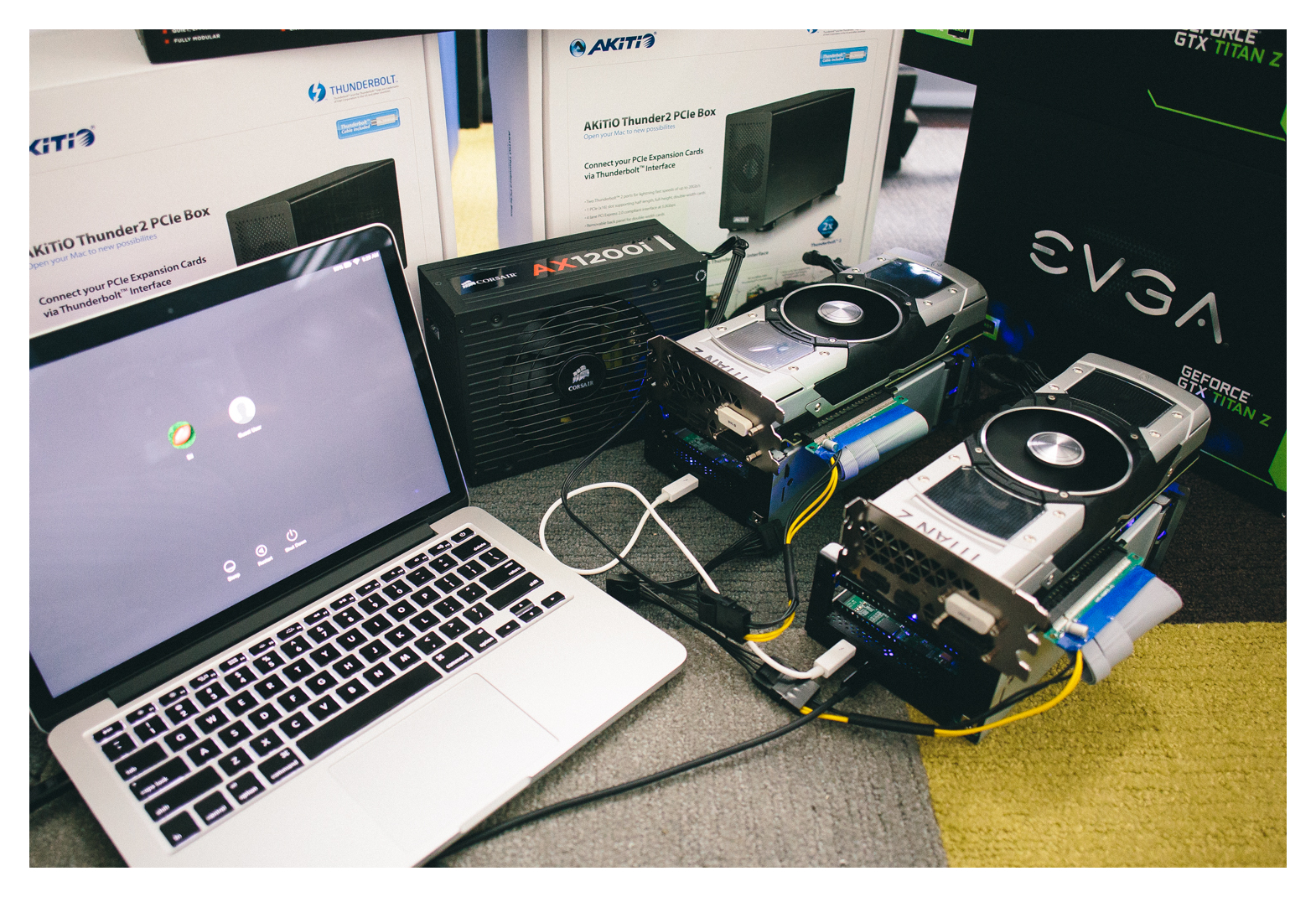

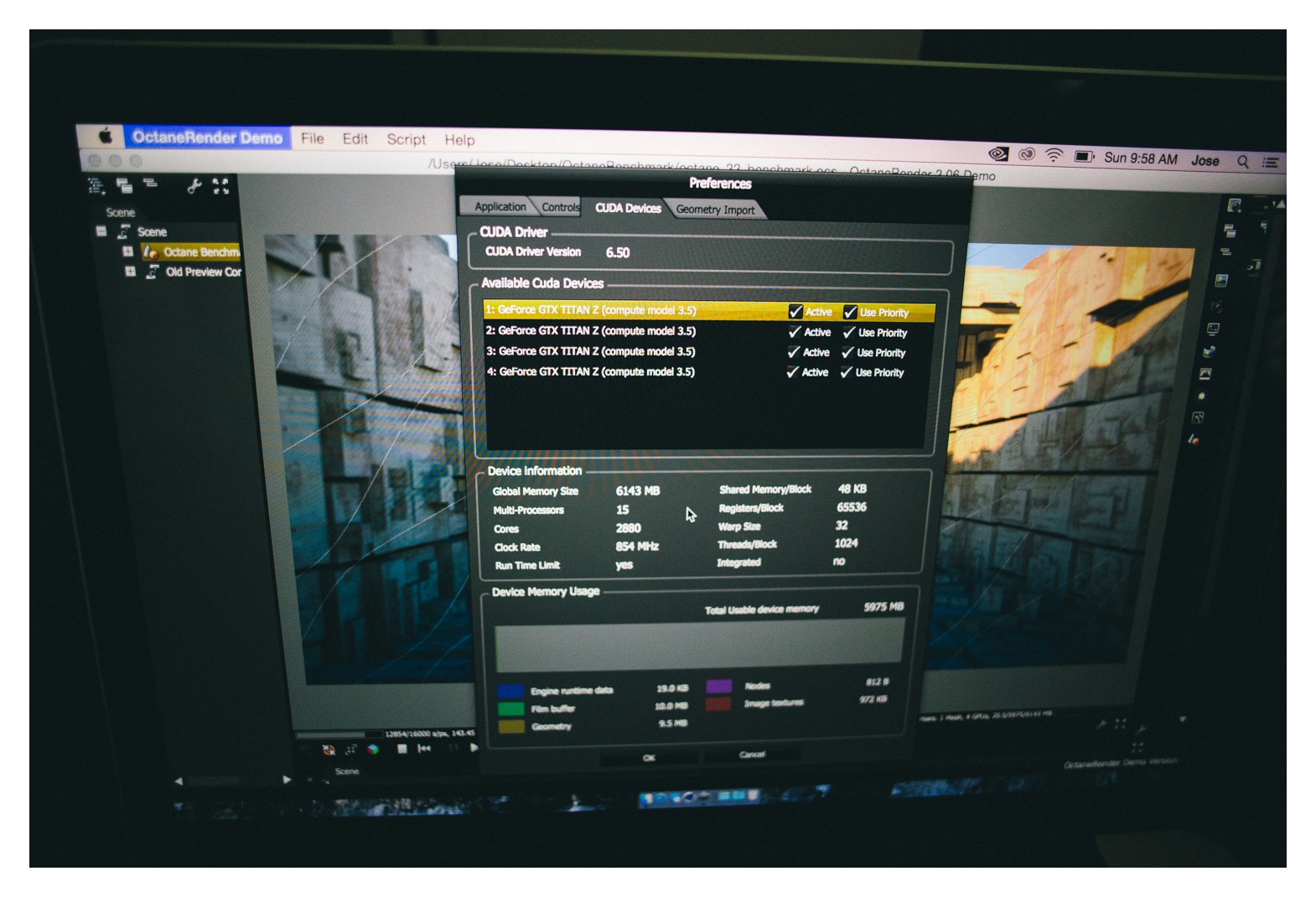

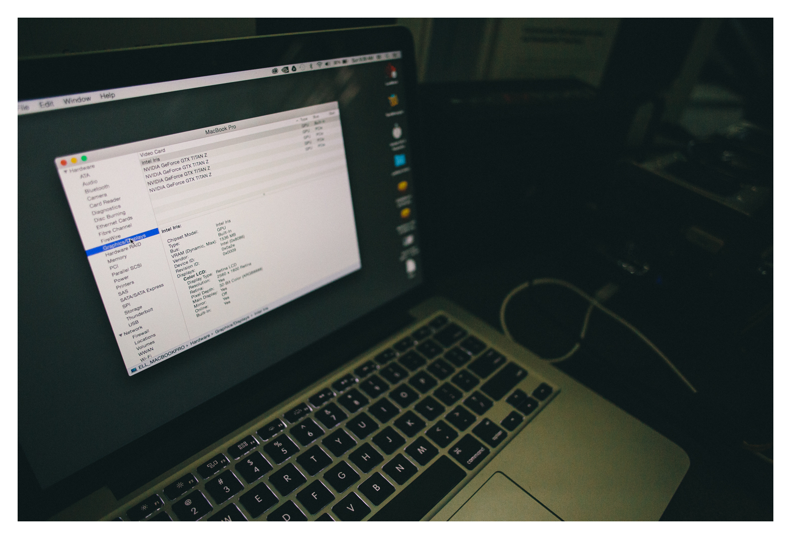

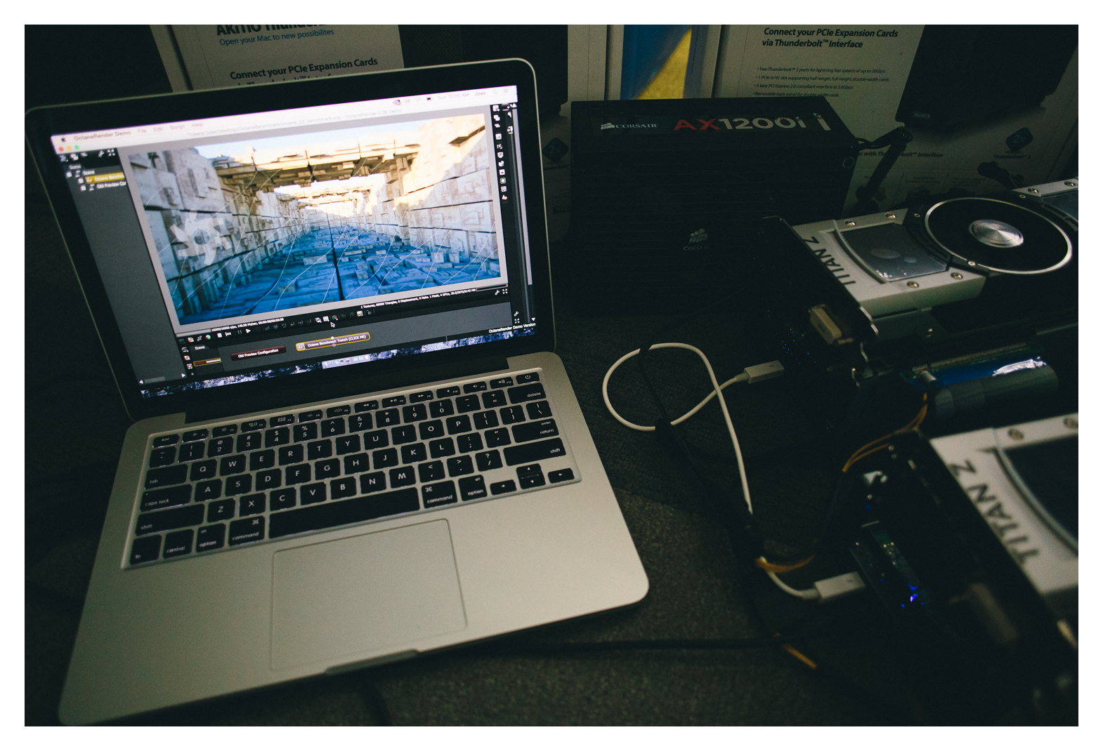

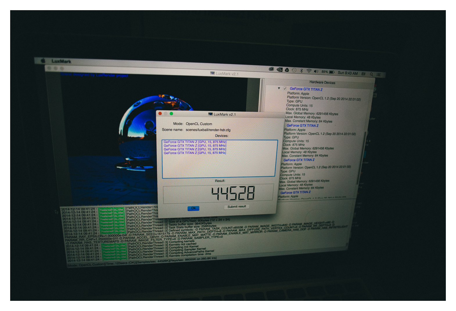

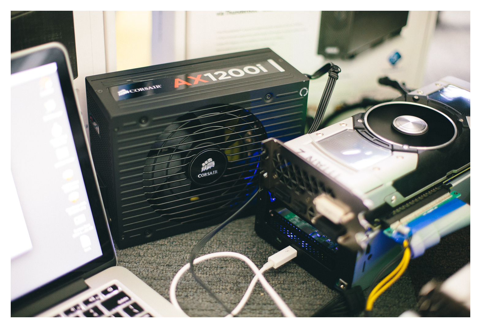

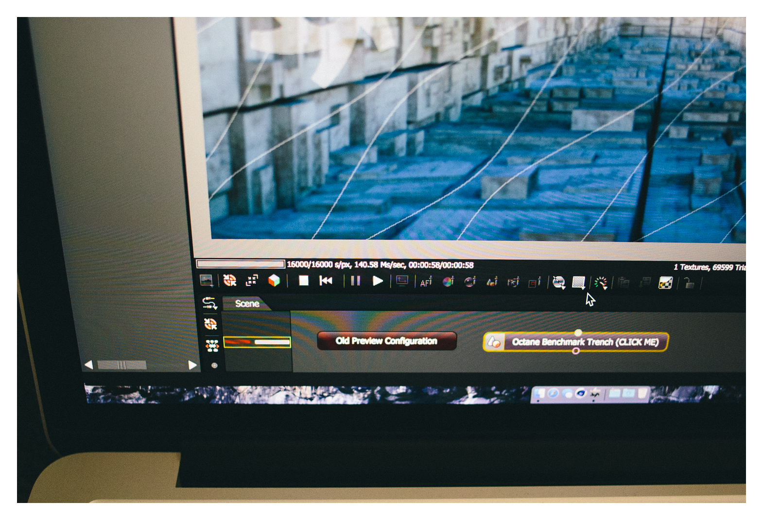

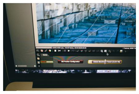

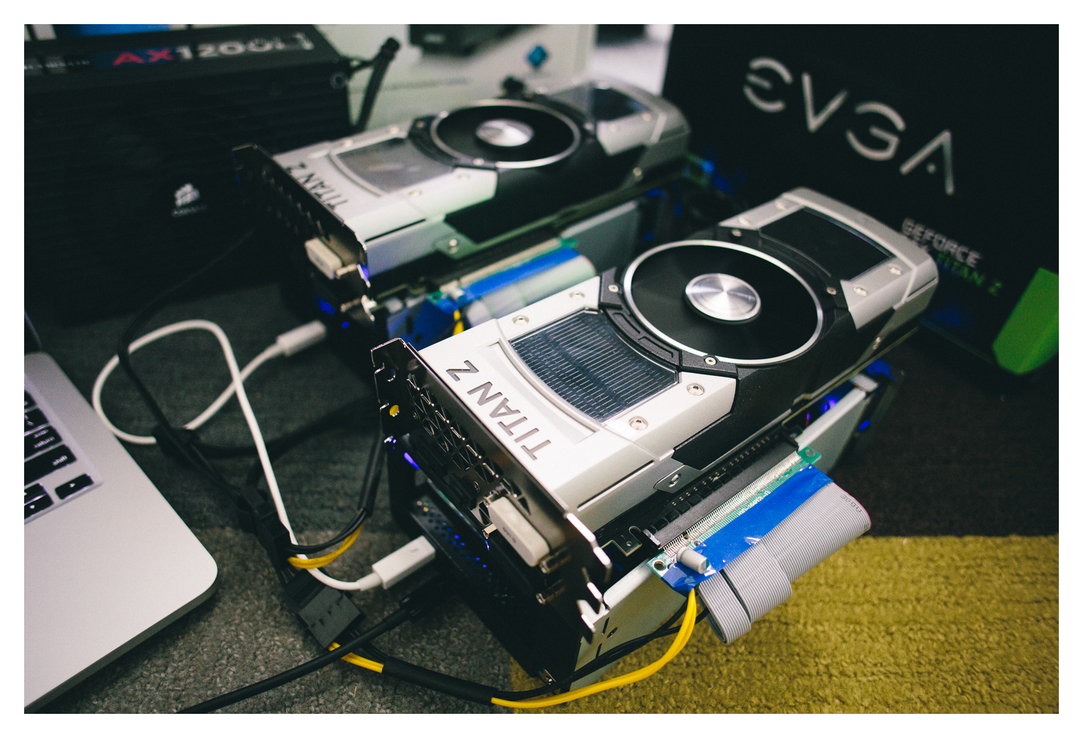

nesone Posted January 4, 2015 Share Posted January 4, 2015 This is my third AKiTiO Thunder2 Setup with 2 x Titan Z and 13'' MacBook Pro TB2. TB2 let me attach 2 Titan Z via daisy chain. Mac Thunderbolt 1 can hold 1 TITAN Z Mac Thunderbolt 2 can hold 2 TITAN Z Two Titans Z setup and Benchmark Pics: Parts: AKiTiO: Amazon.com: Akitio Thunder2 PCIe Box: Computers & Accessories PCI-E 16X to PCI-E 16X Riser: PCI E Express x16 to 16x Molex Powered Riser Adapter Card Safer Version | eBay Corsair AX1200i Amazon.com: Corsair Professional Series AX 1200 Watt Digital ATX/EPS Modular 80 PLUS Platinum (AX1200i): Computers & Accessories Drivers: http://www.nvidia.com/download/driver... https://developer.nvidia.com/cuda-dow... Software: ---textwrangler--- Bare Bones Software | Products... ---PackageMaker--- https://idmsa.apple.com/IDMSWebAuth/l... ---Cuda-Z--- http://cuda-z.sourceforge.net Process for Yosemite - Link: http://youtu.be/cPOB9qmPjaE eGPU parts - Link: http://youtu.be/5BJyf6TSW7M Thanks! 3 Quote Link to comment Share on other sites More sharing options...

Dschijn Posted July 2, 2015 Share Posted July 2, 2015 There is currently no real way to get fullscreen games with eGPU performance on the internal screen in OSX. The pictures from above are apps that can adress the GPU directly for rendering. 2 Quote Link to comment Share on other sites More sharing options...

Dschijn Posted January 12, 2016 Share Posted January 12, 2016 @newontheblock The Titan Z can draw up to 375W of power and needs strong 12V rails on the PSU. Desktop PC PSUs with (at least) 550W or more power should have the necessary plugs (2x8-Pin PCIe) to power the Titan Z. Additionally you would need to make (by yourself) a Molex to barrel plug to power the AKiTiO itself from that same PSU as well. Quote Link to comment Share on other sites More sharing options...
