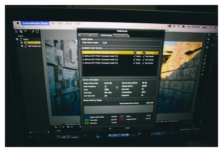

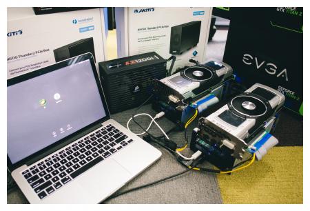

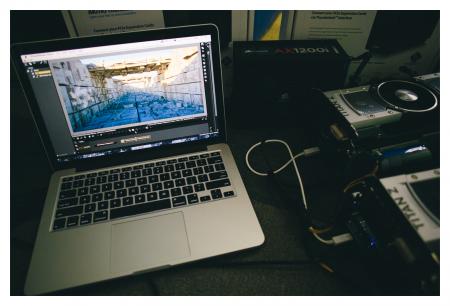

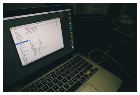

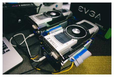

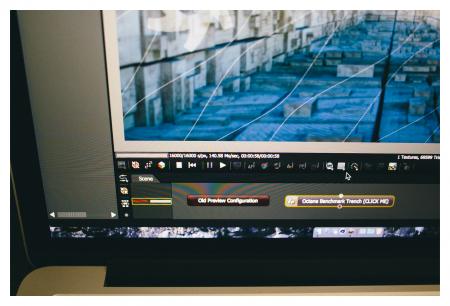

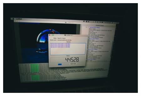

  1. This is my third AKiTiO Thunder2 Setup with 2 x Titan Z and 13'' MacBook Pro TB2. TB2 let me attach 2 Titan Z via daisy chain. Mac Thunderbolt 1 can hold 1 TITAN Z Mac Thunderbolt 2 can hold 2 TITAN Z Two Titans Z setup and Benchmark Pics: Parts: AKiTiO: Amazon.com: Akitio Thunder2 PCIe Box: Computers & Accessories PCI-E 16X to PCI-E 16X Riser: PCI E Express x16 to 16x Molex Powered Riser Adapter Card Safer Version | eBay Corsair AX1200i Amazon.com: Corsair Professional Series AX 1200 Watt Digital ATX/EPS Modular 80 PLUS Platinum (AX1200i): Computers & Accessories Drivers: http://www.nvidia.com/download/driver... https://developer.nvidia.com/cuda-dow... Software: ---textwrangler--- Bare Bones Software | Products... ---PackageMaker--- https://idmsa.apple.com/IDMSWebAuth/l... ---Cuda-Z--- http://cuda-z.sourceforge.net Process for Yosemite - Link: http://youtu.be/cPOB9qmPjaE eGPU parts - Link: http://youtu.be/5BJyf6TSW7M Thanks!

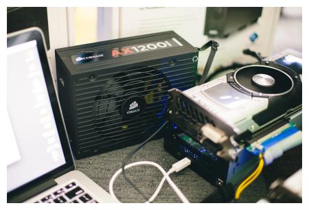

  2. This is my second AKiTiO Thunder2 Setup with a Titan Z and MacBook Pro for Octane Render C4D plugin. I show all the parts that I use for the setup, plus how I install drivers and edit the .kext files. Process for Yosemite - Link: http://youtu.be/cPOB9qmPjaE eGPU parts - Link: http://youtu.be/5BJyf6TSW7M Parts: AKiTiO: Amazon.com: Akitio Thunder2 PCIe Box: Computers & Accessories PCI-E x16 to PCI-E 16X Riser: PCI E Express x16 to 16x Molex Powered Riser Adapter Card Safer Version | eBay Corsair RM1000 Amazon.com: Corsair RM Series 1000 Watt ATX/EPS 80PLUS Gold-Certified Power Supply - CP-9020062-NA RM1000: Computers & Accessories Drivers: http://www.nvidia.com/download/driver... https://developer.nvidia.com/cuda-dow... Software: ---textwrangler--- Bare Bones Software | Products... ---PackageMaker--- https://idmsa.apple.com/IDMSWebAuth/l... ---Cuda-Z--- http://cuda-z.sourceforge.net Thanks!
  3. !!!Up And Running!!! AKiTiO with the TITAN Z up and running. Here is my process. http://youtu.be/cPOB9qmPjaE http://youtu.be/cPOB9qmPjaE

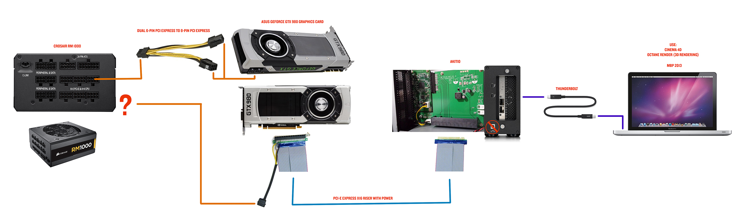

  9. Hi AKiTiO friends, I'm new to this. I just want to know if my diagram is OK and if someone can tell me how to connect the PCI riser to the PSU. I just want to know how to connect everything before I buy all the components. This is going to be my little 3D render computer for C4D and Octane Render. I already own the PSU and the computer. I need: 1- AKiTiO Thunderbolt 2 2- ASUS GTX 980 3- Dual 6-Pin PCI Express to 8-Pin PCI Express 4- PCI-e Riser powered 5- Thunderbolt cable Thanks for the help!
