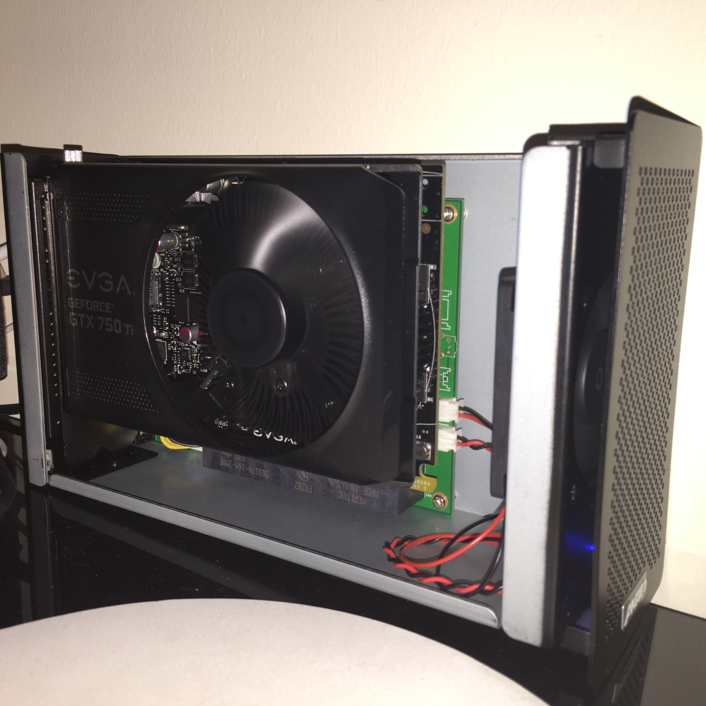

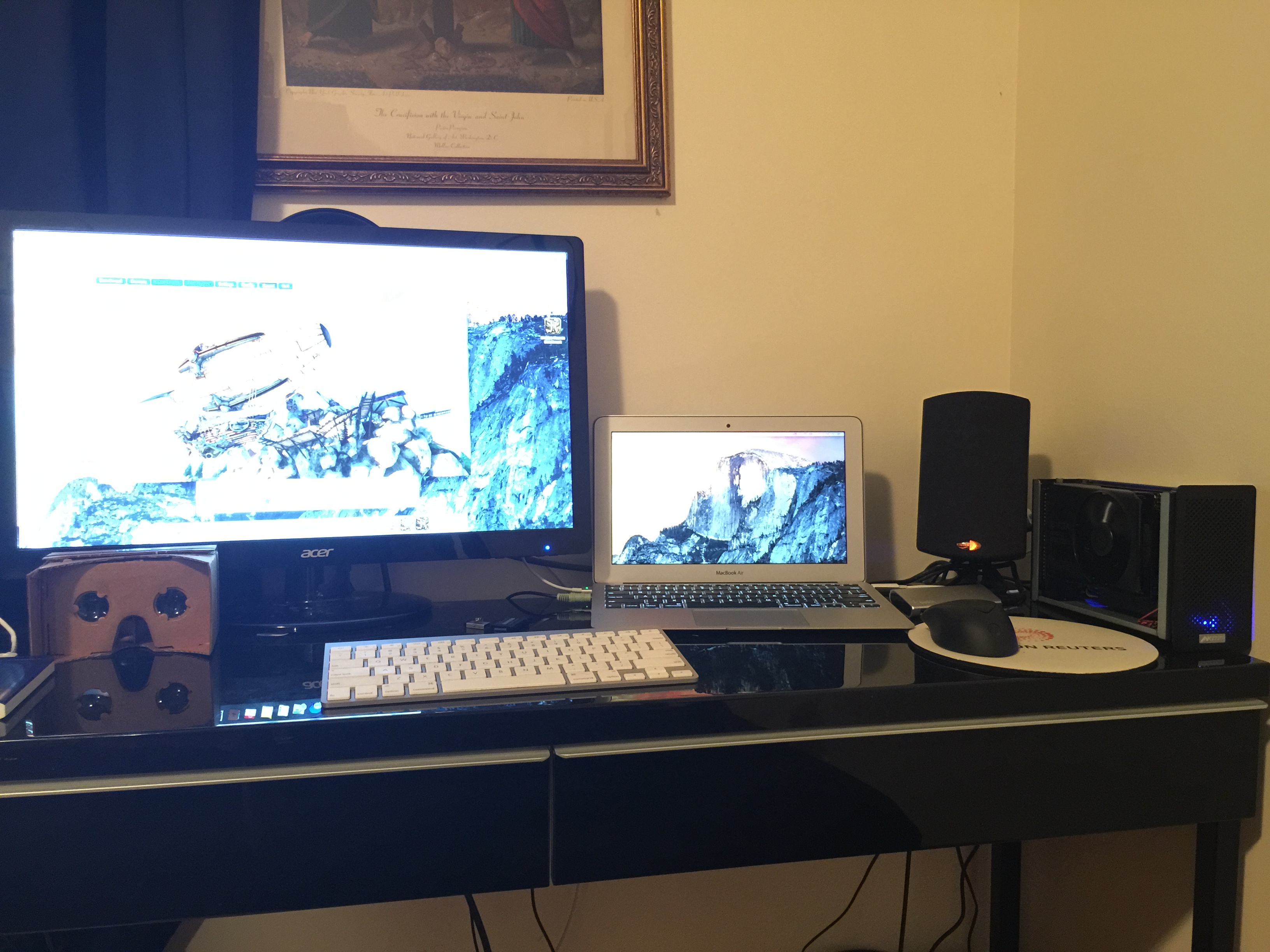

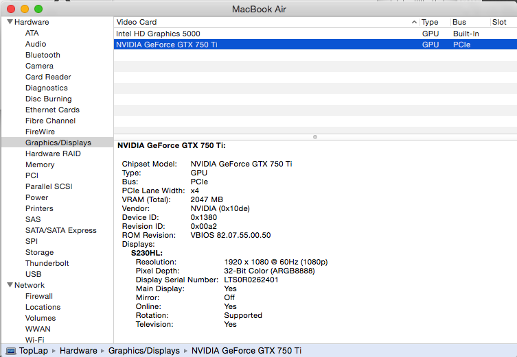

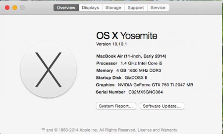

johndshea Posted January 3, 2015 Share Posted January 3, 2015 Hello all! I've been a lurker on this thread for several months now and decided to finally bite the bullet and do my first eGPU build with the AKiTiO. It's up and running beautifully in Yosemite after following @entzoe's instructions here, after a few hiccups (e.g., apparently the driver installation and kext editing must be done in a very specific order). Right now, I'm running the 750Ti off the AKiTiO's power alone, with the enclosure on too. And it seems to be running fine! This is confusing to me because my understanding is that the AKiTiO only provides 25W to the card and even the 750Ti requires 60W. So I'm concerned that a) I'm damaging the AKiTiO by exceeding its power envelope or my 750Ti won't run properly because it's power-starved, or both. Update: running the 750Ti on the AKiTiO's 60W PSU alone proved to be moderately unstable. I eventually shifted to using a 500W ATX PSU + powered riser with the 750Ti, which was more stable, then to running a Mini-ITX GTX760 and later a Mini-ITX GTX 970 with the AKiTiO, both of which were even more stable. I'm well behind the learning curve on electrical engineering compared to most people on this thread. However, if my setup really is working well, it's possible that the AKiTiO is capable of running a midrange Maxwell GPU without any other hardware needed. OpenGL benchmark with the GTX750Ti running only on the AiKiTO's own power supply (not bad for a base model 11'' MBA!): OpenGL benchmark with the GTX750Ti running on an EVGA 500w ATX PSU through a powered riser (as you can see, barely any difference): For comparison - OpenGL benchmark for the MBA's original integrated Intel HD5000 GPU: For good measure: here's the same benchmark replacing my 750Ti with a GTX 970: 2 Quote Link to comment Share on other sites More sharing options...

johndshea Posted January 5, 2015 Author Share Posted January 5, 2015 Hi @salut, Heat doesn't appear to be an issue. The 750ti runs very cool, usually even cool to the touch even when running, for example, Dragon Age Inquisition at Ultra settings, 1080p (which runs off the Frostbite III engine, very demanding). However, my machine is unstable lately - I've been getting periodic crashes both in Windows and in OS X. I'm 90% sure the eGPU is to blame, but the crashes don't appear to follow any discernible pattern. For example, they seem to be no more likely to occur when I'm stressing the GPU (gaming, benchmarking, etc) than any other time, and they don't appear to be more likely to occur if the computer has been running for some time. As far as I can tell, they are random. The obvious suspect is the power supply issue on the AKiTiO. I'm currently testing a hunch that the cause may have been the fact that I daisy-chained a Thunderbolt ethernet adapter with the AKiTiO and that the ethernet adapter might have been the culprit creating unpredictable power requirements on the AKiTiO's PSU unrelated to the power draw of the 750Ti. It sounds pretty out-there, but I'm testing that theory and we'll see how it goes.Update: removing the daisy-chained thunderbolt ethernet adapter didn't seem to improve things. Neither did running the 750Ti with a 500w power supply and a powered riser, so either my riser is busted or the power draw isn't the culprit. Something else is awry here, and I'm not sure what it is. Quote Link to comment Share on other sites More sharing options...
salut Posted January 5, 2015 Share Posted January 5, 2015 From what I read in the Forum, the Akitio doesn't need it's own PSU when driven with the powered riser.So if your setup works with the riser and without Akitio's PSU that would be a sign for the riser working properly I think.Did you check that? Quote Link to comment Share on other sites More sharing options...
johndshea Posted January 5, 2015 Author Share Posted January 5, 2015 I did, and the AKiTiO will not run with only the powered riser. So that could mean my riser is defective. I should have another one tomorrow to test. Quote Link to comment Share on other sites More sharing options...

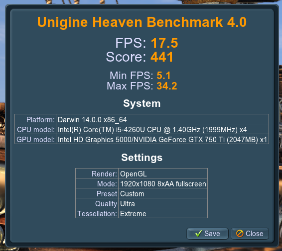

johndshea Posted January 6, 2015 Author Share Posted January 6, 2015 I just tried with the new riser and had the same result - the AKiTiO still needs its own power supply. I also tested the AKiTiO/gtx750Ti combo with a brand-new 13'' Macbook Pro and it got the exact same benchmarks as the MBA (which is odd - you'd expect that the jump from Thunderbolt 1 to Thunderbolt 2 would result in a performance jump, not to mention the spec jump from the base MBA to a MBP with twice the RAM and a faster CPU). Lately, I've tried booting the AKiTiO with the MBP and its own internal power supply and it won't do it at all. I am hoping that I haven't permanently damaged the AKiTiO, which was my primary worry. I have a GTX760 coming tomorrow and will test with that. Very confused. Quote Link to comment Share on other sites More sharing options...

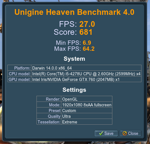

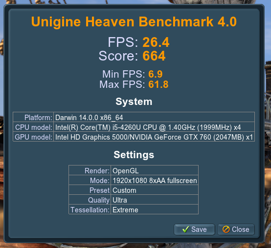

johndshea Posted January 8, 2015 Author Share Posted January 8, 2015 Thanks, @goalque, I wasn't aware of the different types of risers. That explains it! I appreciate the electrical help, I'm not very experienced with that. Update: I received my MSI mini-ITX GTX 760 today and am running it now on the AKiTiO box with my 500w ATX PSU providing power through the PCIe 8-pin connector on the 760 as we speak. It appears to be completely stable in OSX Yosemite (so far). It runs an external display perfectly both on my 11'' Early 2014 Macbook Air and on my 13'' Mid 2014 Macbook Pro (Retina). Interestingly, benchmarks on each are pretty close to being the same (see below). It appears that there is little-to-no performance difference between a Thunderbolt 2 connection (on the Macbook Pro) and a Thunderbolt 1 connection (on the Macbook Air) when using an eGPU with the AKiTiO. My speculation is that this is because the 4 PCIe lanes the AKiTiO provides already max out at 5Gbps themselves, well within the throughput range of both TB1 and TB2. In summary: 1) Early 2014 11'' Macbook Air (TB1) with GTX750Ti running purely on the AKiTiO's own power (no riser): works under both OSX and Windows, but unstable under load, scores roughly 440 in Unigine Heaven benchmark "Extreme" @ 1080p. 2) Mid 2014 13'' Macbook Pro (TB2) with GTX750Ti running purely on the AKiTiO's own power (no riser): works under both OSX and Windows, but unstable under load, scores roughly 440 in Unigine Heaven benchmark "Extreme" @ 1080p. 3) Early 2014 11'' Macbook Air (TB1) with GTX750Ti running on the AKiTiO with a 500W ATX PSU via a powered riser: works under both OSX and Windows, stable under load, scores roughly 440 in Unigine Heaven benchmark "Extreme" @ 1080p. 4) Mid 2014 13'' Macbook Pro (TB2) with GTX750Ti running on the AKiTiO with a 500W ATX PSU via a powered riser: works under both OSX and Windows, stable under load, scores roughly 440 in Unigine Heaven benchmark "Extreme" @ 1080p. 5) Early 2014 11'' Macbook Air (TB1) with Mini-ITX GTX760 running on the AKiTiO with a 500W ATX PSU via 8-pin PCIe connectors (no riser): works under both OSX and Windows, stable under load, scores roughly 660 in Unigine Heaven benchmark "Extreme" @ 1080p. 6) Mid 2014 13'' Macbook Pro (TB2) with Mini-ITX GTX760 running on the AKiTiO with a 500W ATX PSU via 8-pin PCIe connectors (no riser): works under both OSX and Windows, stable under load, scores roughly 680 in Unigine Heaven benchmark "Extreme" @ 1080p. Update: The Mini-ITX MSI/Nvidia GTX760 appears to run properly as an eGPU even when using the stock Mac OS X graphics driver in Yosemite! I'm not entirely sure why this is - perhaps because Yosemite supports the GTX760 natively? I'm surprised it will allow it to run in an eGPU though. Can anyone else with a GTX760 and an AKiTiO confirm this? Quote Link to comment Share on other sites More sharing options...

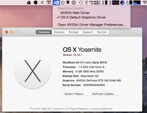

MVC Posted January 10, 2015 Share Posted January 10, 2015 Yes, the Nvidia drivers are only REQUIRED for Maxwell cards and Titan Black and 780Ti. All the rest of previous Nvidia cards have drivers in OS and don't REQUIRE web drivers, per se.Could you correct title of this thread?A 2011 MBA is a very different story from a 2014 one. You are one of very few people with a TB2 Mac having no trouble getting external displays running and the title of this thread is hiding the value of your success. Quote Link to comment Share on other sites More sharing options...
johndshea Posted January 10, 2015 Author Share Posted January 10, 2015 @MVC you are very kind. I'm not sure how to rename the thread but I'll give it a try. Thanks! @Tech Inferno Fan I believe you created this thread, are you the only person who can rename it? Quote Link to comment Share on other sites More sharing options...
MVC Posted January 10, 2015 Share Posted January 10, 2015 Your Early 2014 Macbook Air is the 3rd TB2 Mac supporting screen output via Nvidia eGPU, concluding the reports that I have seen here so far. EDIT: I thought all the 2014 Macs are TB2, but your model is TB1.Wow, so a 2014 MBA is TB1?AT this point I wonder what the other 2 @ TB2 Macs with TB2 were that got display output, as at this time it is appearing that TB2 killed eGPU display output in OS X. Will be very important thing to clarify.johndshea, can you verify that your machine is TB1? Quote Link to comment Share on other sites More sharing options...
johndshea Posted January 10, 2015 Author Share Posted January 10, 2015 @MVC yes, my Early 2014 MBA is TB1. I also have a Mid-2014 MBP which is TB2. Both are working with my GTX760/AKiTiO eGPU. Quote Link to comment Share on other sites More sharing options...

johndshea Posted January 10, 2015 Author Share Posted January 10, 2015 It's a Mid-2014 13" Macbook Pro with Retina Display with an Intel Iris GPU. I did the exact same setup that I did with my Early 2014 Macbook Air (Nvidia Web Drivers, AKiTiO unit w. 500W ATX PSU, MSI Mini-ITX GTX760), and it worked equally well. Oddly enough, the performance difference between the TB1 MBA and the TB2 MBP was negligible. But they both were quite stable in OSX Yosemite with the eGPU. Quote Link to comment Share on other sites More sharing options...
