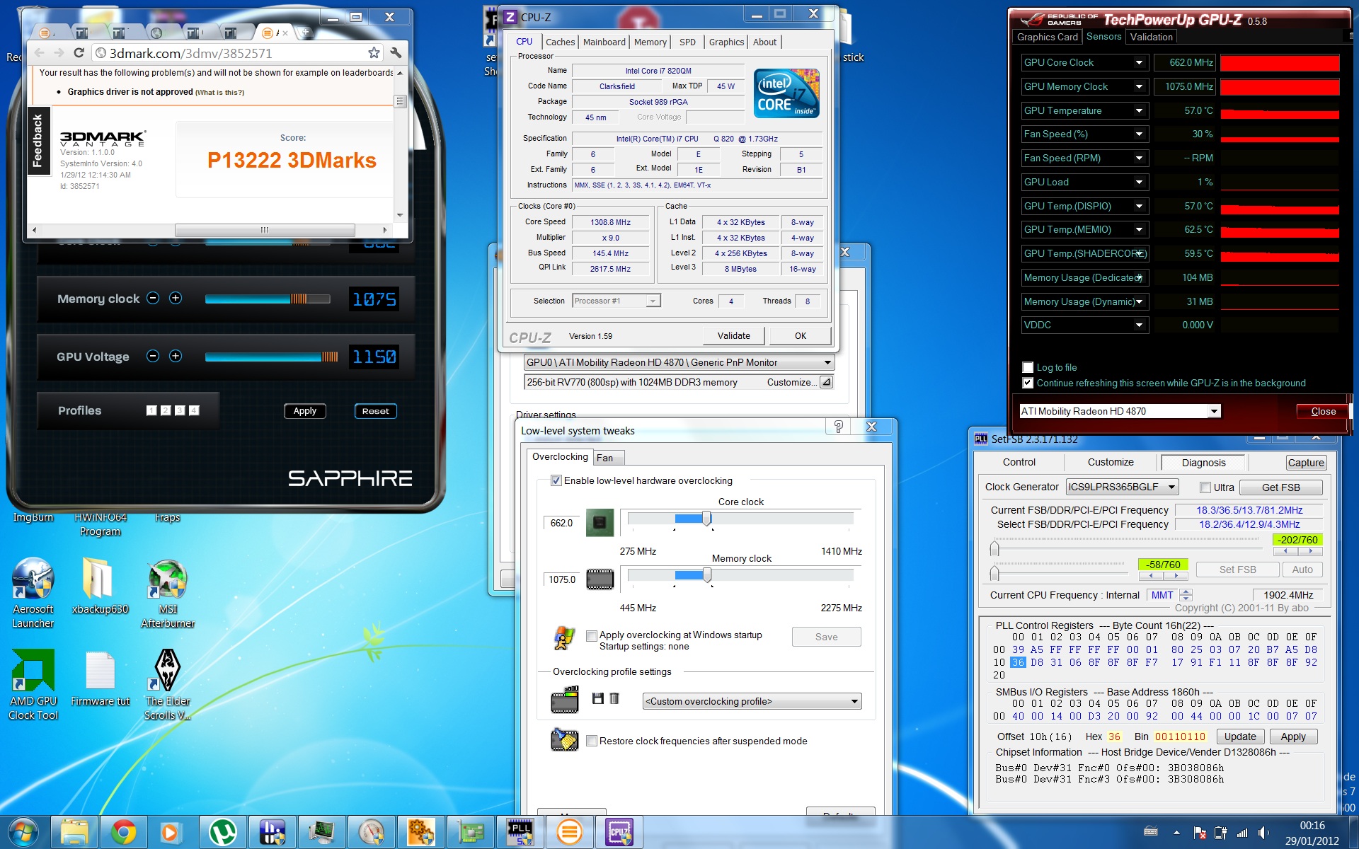

OK first of all I'd like to say hi :) as its my first time posting on here. im fairly new to overclocking in the sense that i have results but i have no idea how good it is or not when compared with other peoples. ok im running an M17x-R2 with an core i7 820qm processor and DUAL HD4870S IN CROSSFIRE. now ive devoted most of this weekend to squeeze every last ounce of power from my pc. I was trying to break P13K score on 3dMark Vantage and i wouldnt rest until i had done so. THE GOOD NEWS IS. I DID!!! i have know idea whether a score of P13222 is good for dual 4870s in crossfire but as far as im aware its pretty good so im fairly happy lol. i used SetFSB to overclock the 820QM processor to 1.90 GHz. and had both my 4870s overclocked to a core speed of 662 MHz and a memory speed of 1075 Mhz. for cooling i only used the fans on the laptop itself running at the highest rpm possible (forces using HWiNFO 64) so i wont try overclocking anymore cos my cards hit 91 degrees and the prcessor core 1 hit 92 aswell.
but anyway the final result i got to with 3dMark Vantage was P13222 (for dual 4870s i believe that is very good)

Nice to see someone pushing his system, you got really a good score, almost 14k GPU score. Did you change the voltage of the GPUs? (TriXX seems to be at the limit with the voltage... if you were at 1.15, what is the stock voltage?).
The latest driver might boost your performance a bit... worth a try if you wanna improve your score.
If your CPU was at 92°C it won't really give you Turbo Boost anymore, so if you can keep it cooler it should result in a higher clock speed.

Welcome to T|I @kieran2112 and grats for your score! Have you considered repasting your GPUs with some good quality thermal paste and performing the retention mod for some greater down-force of your heatsinks so you can squeeze some extra juice out of your cards?

1) is there anything you think i could do to push it any further
2) is it possible using any program to overvolt the card past 1.15v (and the stock voltage is 1.05)
3) is it possible to change the turbo boost cap on the cpu so for example when its running in turbo mode it goes to 3.2GHz instead of 3GHz
and 4) also is there any way of auxillary cpu cooling tht u could recommend because thts the thing thats limiting me at the moment.
Added after 3 minutes:
could you post a link to the retention mod pls cos i have heard of it but i have no idea what it is or how to do it lol.
like i say i think one of the main limitations im facing here is that well im running the A10 V1F modded bios tht unlocks cpu overclocking + i can use setfsb a bit more so i could probably overclock my cpu wayy more but the main limitation is it will overheat if i take it above around 1.92GHz so is there any auxillary cooling that you guys could recommend so i could take it a bit further
and also. how do you set a signature so you can put your system specs at the bottom of your forum posts. (sorry im a bit of a noob to forums)
Edited by kieran2112
  • Founder
The retention mod can be found here: http://forum.techinferno.com/alienware-m17x/13-m17x-r2-cooling-mod-ashtefere.html
Extra info on cooling here: Alienware M17x Teardown & Cooling Modification | Tech|Inferno
Another GPU repasting example with ICD 24 here: http://forum.techinferno.com/general-notebook-discussions/913-ic-diamond-24-survey-results.html
1)Repasting and the retention mod will allow you to further overclock. An aircondition unit hitting cold air on the GPUs will help when overclocked during benchmarking but you will need some dry ice or liquid nitrogen to reach extreme levels.
2)You can't go past 1.15V with any software
3)You can't, for that you will need an extreme CPU like 920XM/940XM
4)All that apply for the GPU apply for the CPU as well, for extreme levels though you will have to resolve to extreme solutions.
For the signature you will have to exceed I think 10 posts or something before you can use one.
