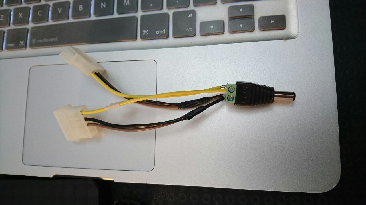

So I can recommend this setup to anyone looking to use this cable and screw terminal. Just look at the pictures above for details.
The only advice I can give is:
Check if yellow from the Molex plug is connected to the inner part of the barrel and black to the outer part.
Also cross check that is NOT the other way around, e.g. yellow on the outer part.

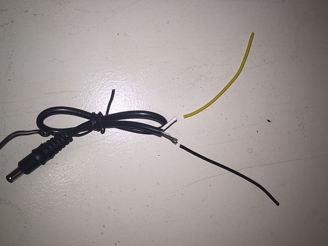

Hello there! I want to use Akitio own power source plug in my 2 splitters setup. So I just cut it off and I am about to solder it. I just want to confirm that this is the way it should be. I'll try to burrow a friend's multimeter in order to double check that, too. Also, I've seen that its better to use 2 or even 3 cables (yellow/black each) but the last bit of the cable would be this simple one, since the plug is attached to it... Does this represent a problem? I guess I should cut the wire shorter...
Thank you very much!

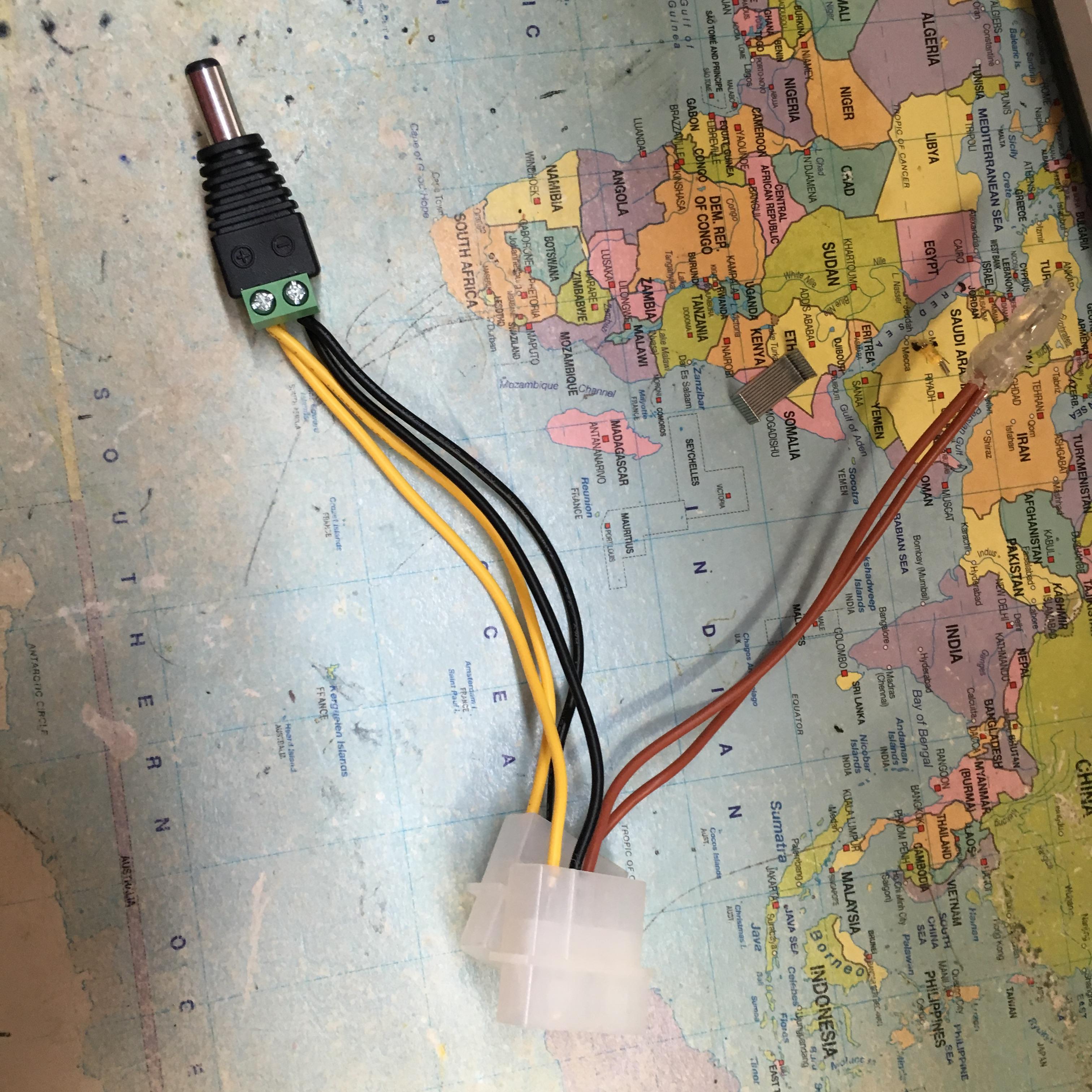

Hi people, just made this. The molex cable came with my old graphic card, don't know what the brown wires are. I suppose they are just another ground, can you confirm?
Two yellows in the positive (+), two blacks in negative (-)
And there is an "E" attached to one of the yellows
IMG_2016-04-16 12:58:04.jpg
IMG_2016-04-16 12:55:50.jpg

On 12/17/2015 at 8:06 PM, Dschijn said:
@Enano Seems ok, but I would recommend to make that with two Molex plugs.
 http://www.ebay.co.uk/itm/UK-Seller-Twin-Molex-Power-to-6-Pin-PCIE-PCI-E-Graphics-Card-Power-Cable-/162094829149?hash=item25bd9ace5d:g:eusAAOSwBLlVTIhy
Would buying this and taking all the wires out of the 6 pin and placing the required wires in a solderless 2.5 x 5.5mm solderless plug work?
Yup. 2 black, 2 yellow, that's fine. Twist black and yellow cables and you're good to go.

On 4/16/2016 at 1:15 PM, Dschijn said:
Seems good :)
Brown is equal to black = ground.

Ok guys this is what it now looks like, I have glued the brown wires as I understand I do not need them? Then I twisted the two yellows together and placed them in the positive slot and i twisted the black wires together and placed them into the negative slot? Will this work for powering the akitio?
Yup. But honestly I wouldn't twist the brown cables together and glue them, just isolate them seperately. I've simply used some duct tape once.
@Dschijn It works for me.
42 minutes ago, Dschijn said:
Yeah, they work now :D
Brown = black = ground.
Cable looks fine.
