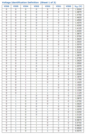

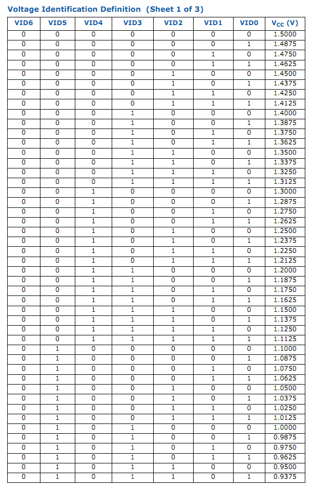

A quick explanation: The core voltage (Vcc) gets regulated by combining 7 different voltage identificators pins (VIDs), VID0, VID1, ... VID6.
Each VID has a different voltage value.
VID0 = -0.0125V
VID1 = -0.0250V
VID2 = -0.0500V
VID3 = -0.1000V
VID4 = -0.2000V
... you get the idea.
Simplified you can say the Vcc is at 1.5V when no VID is active, every active VID pin will subtract it's value from the Vcc and in this way create the needed Vcc.
post-80-14494988136958_thumb.pngLooking at the VID table should help to understand the concept. A 1 represents an active VID, a 0 an inactive VID pin.
The seven VID pins allow a wide variation of different voltages which allow smooth transitions and can get easily controlled with a simple binary code.
E.g. the string for 0.9250V would be 0101111
Now if you permanently deactivate a VID pin by connecting it to Vss (CPU ground), you increase the voltage of each possible VID combination which uses this pin actively (set to 1).
This means with this method you always change a whole range of different voltages.
For example if you connect VID3 to ground, you will increase each voltage which contains VID3 = "1" in the table by 0.1V.

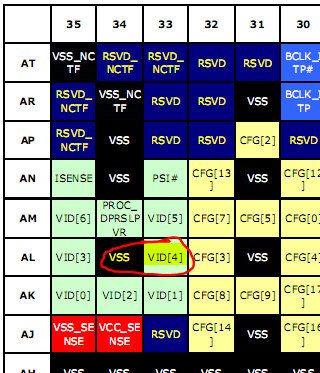

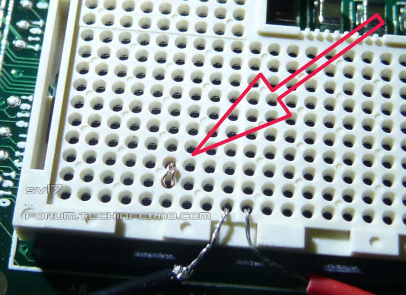

The datasheet provides all the necessary information about the pin locations. Below you see how it looks, encircled in red is what must get connected to permanently set VID4 to "0".
For doing this you simply connected the Vss and VID4 pin in the CPU socket with a very thin wire. Make sure the CPU pin has still enough room.
If it's done it'll look like this:

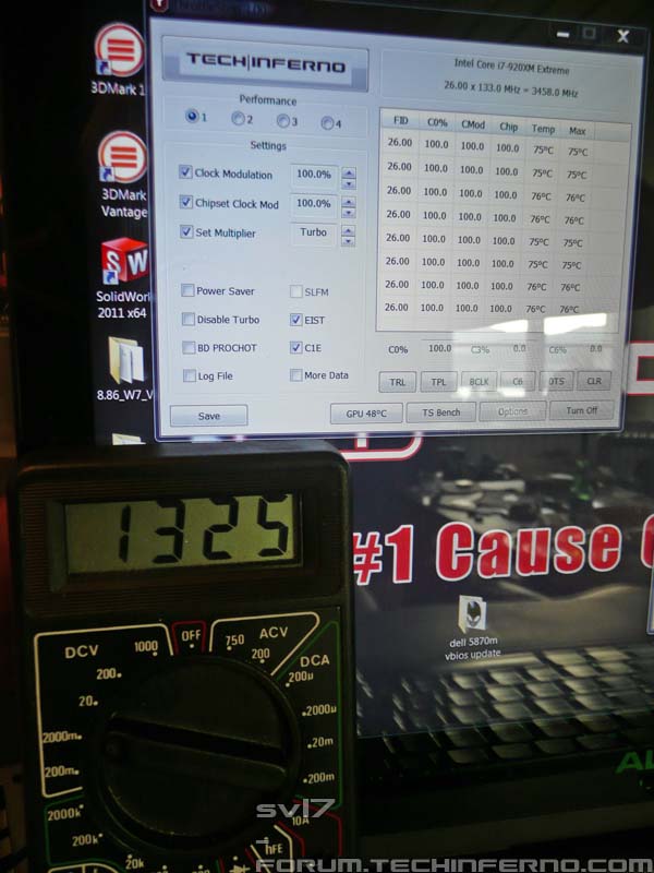

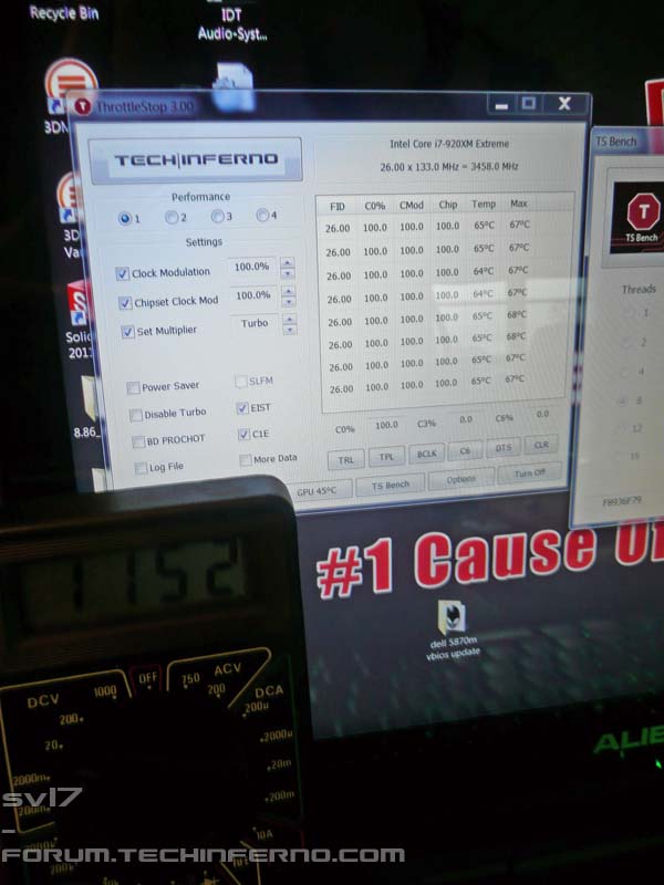

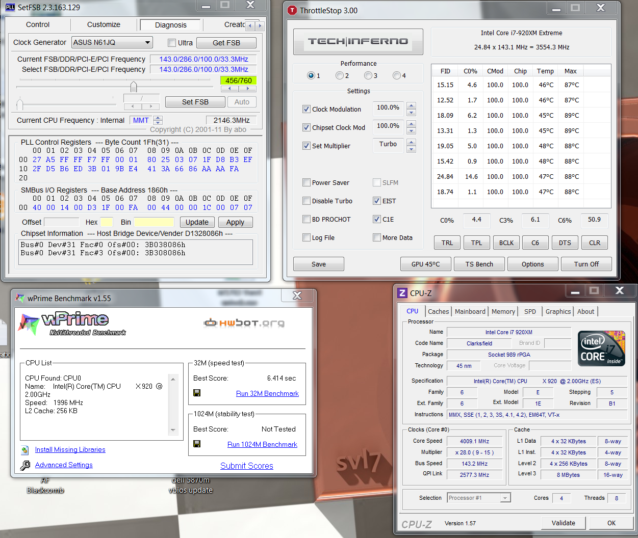

I measured the voltage to make sure it worked as intended. The left picture shows the voltage a multi of 26x on all cores before the mod, the right pic the voltage after the mod.

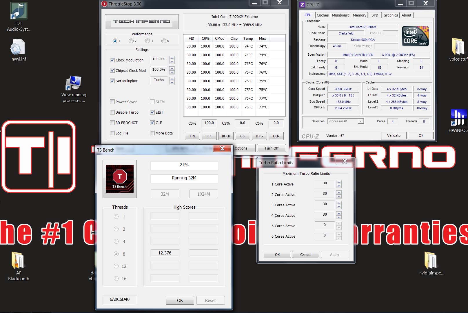

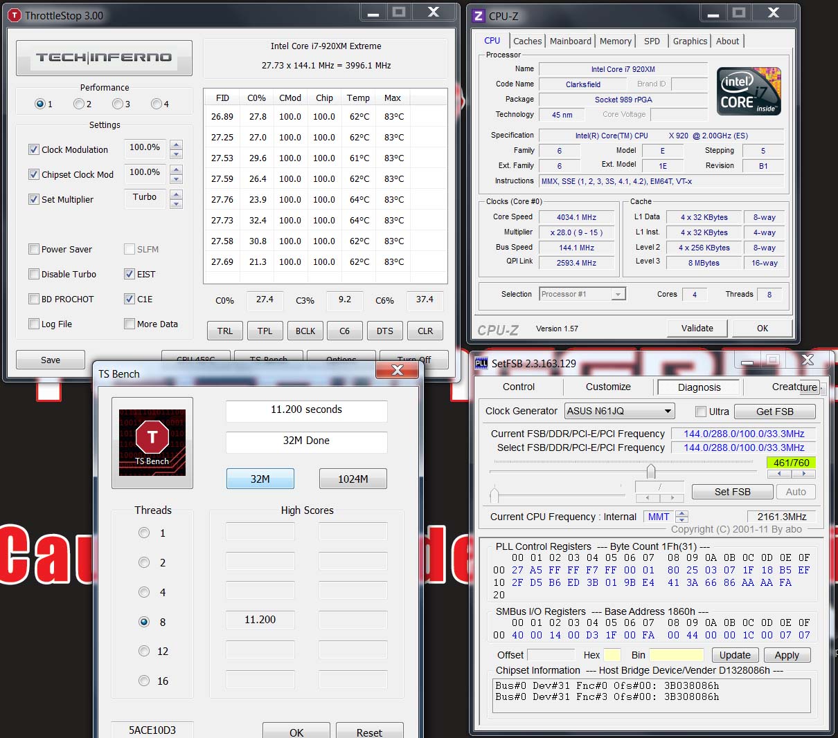

I didn't do a lot of testing yet, but the results are very impressive so far. I've been able to raise the multi to 30x on all cores an run a quick TS bench. And with a multi of 28x and a BCLK of 144 MHz I was able to run the 32M TS bench at more than 4GHz on 8 threads.
The previous limit was 26 on all cores.
Left: Check out the multi shown in Throttlestop
Right: 32M TS bench at 4GHz on 8 threads
I'll see what I can do with proper cooling... this is gonna be fun :D

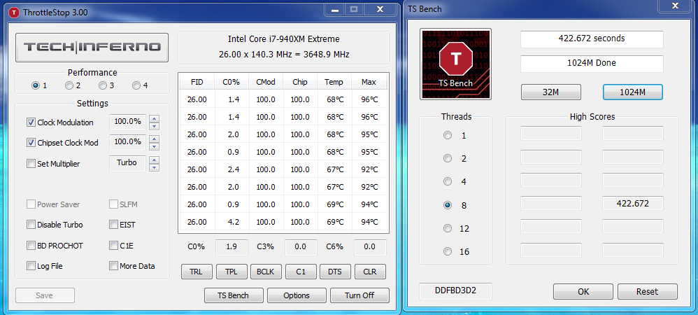

mine is 26 x 140.3 (3,6489 GHz) I use it for everyday since no program (including those you've mentioned) pushes the CPU that hard for that long in order to crash. It's all about ambient temperatures though, if your room is airconditioned then it's fine, if not... :26_002:
So is prime95 the hardest bench to pass and the greatest load on the cpu from all benching software? You know something interesting with prime95... the long term runs push things to the limits... if in prime95 you hit bench or something it starts loading the cpu on single threads adding more and more threads of usage and my system was stable on small ffft and all those tests but the bench ran about 3-4 times in a row immediately after the other really told me if I was stable especially if I had set different multiplier limits per core usage... this doesnt apply to your usual 4 core constant max turbo tweak.

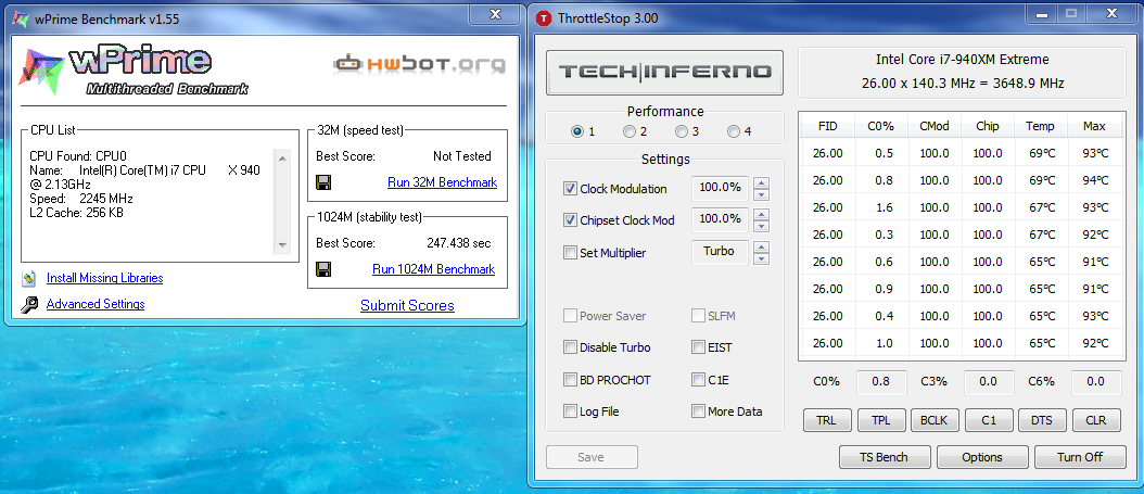

I got my 240W PSU today, and some quick tests indicate that it indeed helps! I only did some very quick testing so far since I don't have sufficient cooling possibilites, but I managed some 32M wprime tests, not a single crash :D I pushed up to 28x on all cores and 143 Baseclock... hehehe. PSU peaked at 210W according to my kill-o-watt, the regular M15x PSU tripped instantly at about 200W.
6.414 seconds so far... more than 4GHz on eacht thread, though I guess some of the programs and processes running in the background slowed it down a bit. I'll do some real benching soon and then I'll see how much further I can push this.
This was with room temps, no cooling pad, I didn't even remove the backplate... it doesn't matter for such a short time. It may peak at 95°C, but that's ok.
I will as soon as I have cooling, it won't work without additional cooling as long as I have the voltage mod applied... temps go crazy with a 200mV higher core voltage. It would throttle immediately, or, with Throttlestop activated, hit 100°C and shut down.
I can do 26x without voltage mod, this results in about 222 seconds.

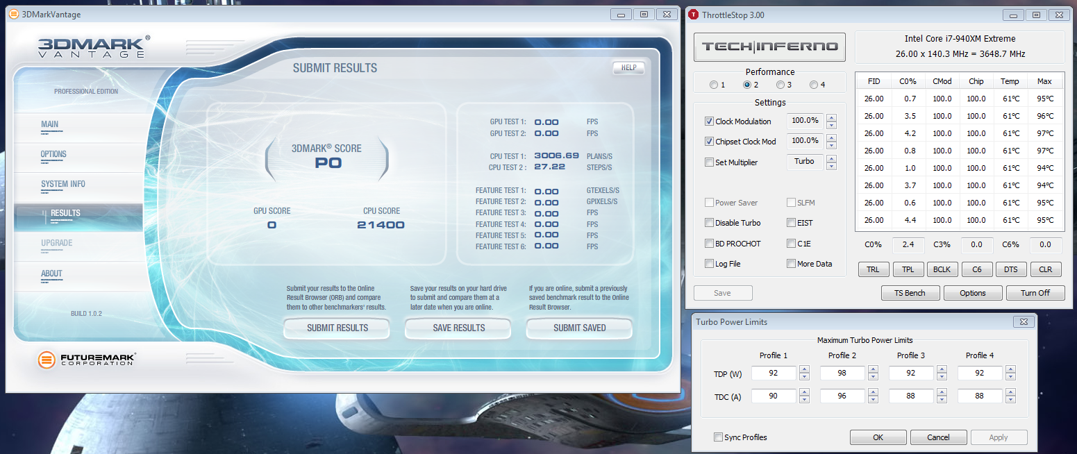

I have mine with the backplate removed and sitting on the cryo lx at 75mV and 140x26 with 98/96 TDP/TDC with temps maxing out at 97 C and it does the 1024M in 240sec. I need to try with an air-condition blowing some cold air from underneath...
*EDIT*
Same with vantage
That's pretty good, 240 secs means that there's only very slight throttling at the end of the test. My 222 seconds with 26x were done with very low ambient temps, no throttling. With room temps and 26x I got about 260 seconds if I remember correctly... but as I said, the voltage increase causes the temps to go crazy, no long runs without auxiliary cooling.
