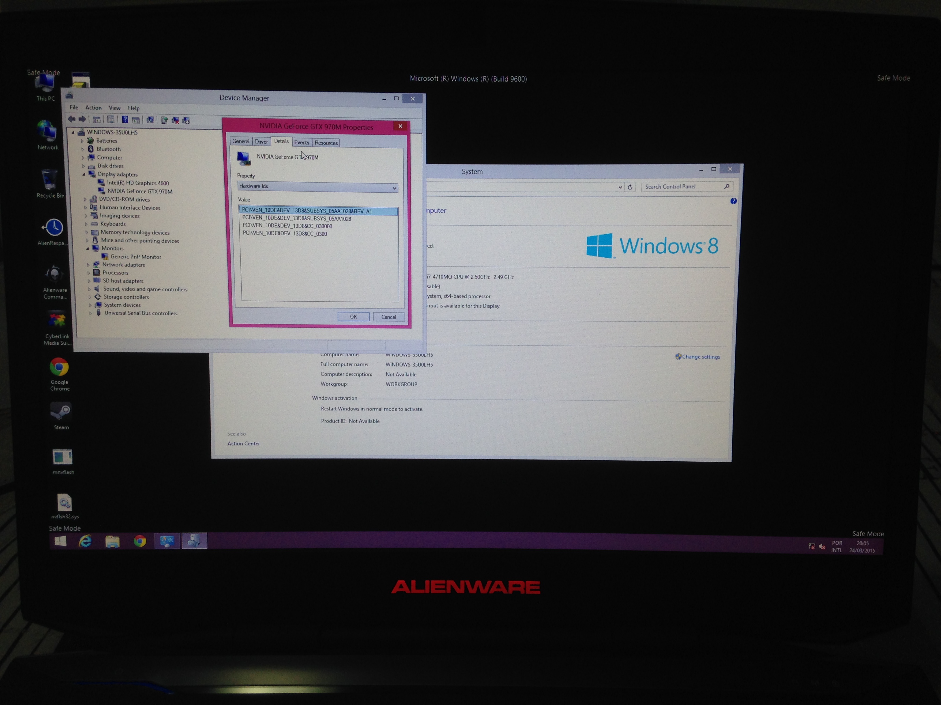

mitchellpeixer Posted March 24, 2015 Share Posted March 24, 2015 Guys, Alienware 17 A14 GTX 970M (originally 880M) running Windows 8.1 UEFI, legacy off. Optimus on, 240W PSU. My card: my card id: 10DE 13D8 05AA 1028 After a fresh new installation of windows 8.1 and the modded driver 347.25 (and many others) that I downloaded here in forum I got this problem: (its a short video that shows my stuck after windows boot) http://youtu.be/MYbHl_xGjX0 https://mega.co.nz/#!4kwQQZLL!TIZGLMr7IkOUFC3xParX9z0WvsgDvGoN878p8IAbV_4 a print from safe mode: I have tested with windows 7 too and sistem boots pretty well and the driver installation are fine, but after the first restart the sistem becomes unstable and starts to freeze I'm freaking out :'( Quote Link to comment Share on other sites More sharing options...
Guest Posted March 25, 2015 Share Posted March 25, 2015 With respect to Windows 7, your system is functioning normally. UEFI, Legacy off, does not work for Windows 7. There have been a few one-off examples of where it works, but 99.9% of the time Windows 7 will freeze at the Welcome screen (before Logon or Desktop) without Legacy/CSM support enabled in the BIOS. Why one system can boot Windows 7 without Legacy support enabled and another seemingly identical model will not remains a mystery. If you do a Google search on this topic you will find endless examples of people looking for a solution to this problem. Some newer low-budget laptops lack the BIOS feature to enable Legacy/CSM support and those people will find themselves forever stuck with a Windows 8 or newer OS and no capability to "downgrade" to the superior Windows 7 OS. The sad part of this is Alienware systems (those before the new BGA turds) are not 100% compatible with Maxwell GPUs. To run in discrete graphics mode (no Optimus) you must use a pure UEFI environment, which means you won't be able to run Windows 7 unless are you have one of the extremely rare one-off examples of a system that will somehow boot Windows 7 without Legacy support enabled in the BIOS. With a single GPU system and Optimus enabled, you can boot with a Maxwell GPU installed with Legacy support because the system will boot using the Intel HD Graphics. If Optimus is disabled and Legacy enabled, the system will fail to POST with 8 beeps because the system BIOS has a compatibility problem with Maxwell GPUs. With respect to Windows 8.X.X you need to install it in UEFI mode, to GPT disks with EFI bootable media or you will have problems like Windows 7. There are specific steps to follow during Windows Setup to install Windows 8.X in UEFI mode or it defaults to Legacy mode, which is not compatible with a no Legacy (pure UEFI) BIOS setting. http://www.eightforums.com/installation-setup/25561-windows-8-install-uefi-mode.html https://codechief.wordpress.com/2013/02/14/how-to-setup-windows-8-in-uefi-bios-in-uefi-mode/ Sorry for the accent this person has, but it was the first YouTube example that popped up on my Google search. If you find it difficult to understand what he is saying, I am sure there are other videos that are similar if you search for them. Quote Link to comment Share on other sites More sharing options...
mitchellpeixer Posted March 25, 2015 Share Posted March 25, 2015 You goddamn right! My system are not capable to run with optimus on, I just turned it off and EVERYTHING WORKS NOW OMG! I've tryed it before but the legacy was on I did not realized that was a problem, so now with the legacy off, I was capable to turn optimus off with no problem Quote Link to comment Share on other sites More sharing options...

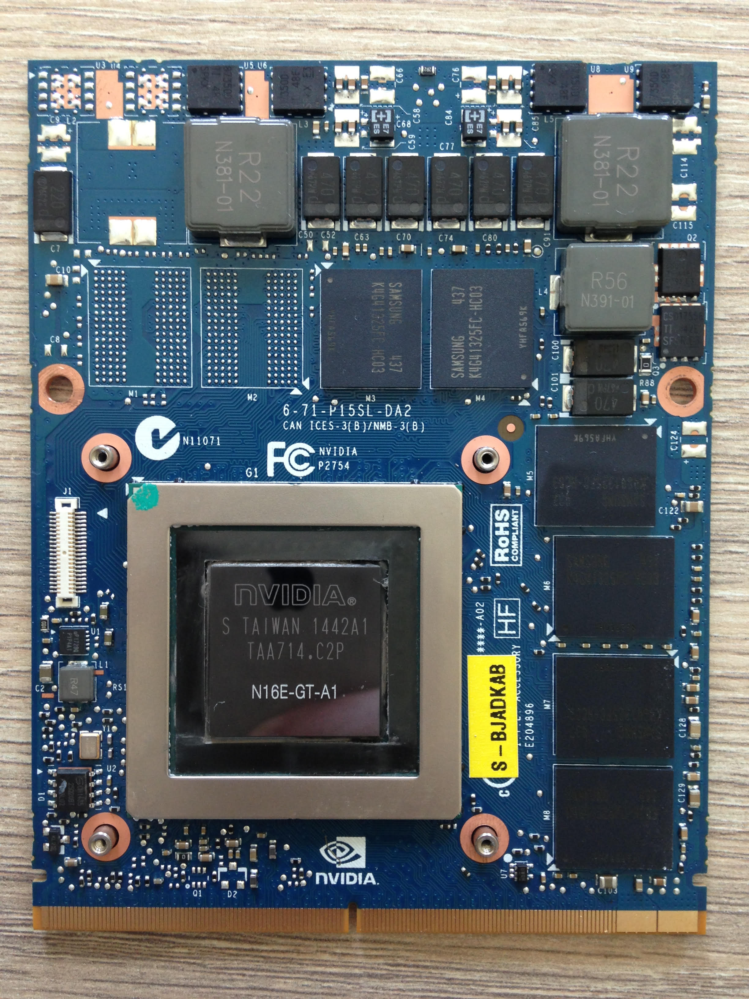

brokendown Posted April 2, 2015 Share Posted April 2, 2015 Somewhat on this topic. I spoke with mysn.de from where I bought my XMG clevo based laptop with custom choice parts. I wanted to know the possibility to upgrade my CLEVO P370EM with nvidia 680m to 980m.They told me they couldn't or didn't have supported upgrade options nor sold GPU's separate. But in chatting with them I found out that a modded vBIOS for CLEVO P370EM would work with the 980m even if its unsupported by both devs. So question is if anyone happen to have such a modded vBIOS out there? Quote Link to comment Share on other sites More sharing options...
J95 Posted April 5, 2015 Share Posted April 5, 2015 GeForce Hotfix driver 350.05GeForce Hotfix driver 350.05Battlefield Hardline - crash with Direct X error message on some systemsDragon Age: Inquisition - TDR crash PhysX 9.15.0324nv_dispi.inf: PEG/Dedicated & Optimus/M17xR4.nvcvi.inf: Optimus Alienware 17 / 05AA (only) GTX 980M - 970M - 965MGeForce 350.05 HF @chiefule Try installing 350.05 using nv_dispi.inf, check throttling stock clocks. Soon modded .inf that removes throttling/stock clocks.nv_dispi.inf_v350.05_AW17_M17x_AW18_M18x_GTX_980M_970M_880M_780M_680M.zipnvcvi.inf_v350.05_Optimus_Alienware_17_GTX_980M_970M_965M.zip Quote Link to comment Share on other sites More sharing options...
TomJGX Posted April 6, 2015 Share Posted April 6, 2015 Somewhat on this topic. I spoke with mysn.de from where I bought my XMG clevo based laptop with custom choice parts. I wanted to know the possibility to upgrade my CLEVO P370EM with nvidia 680m to 980m.They told me they couldn't or didn't have supported upgrade options nor sold GPU's separate. But in chatting with them I found out that a modded vBIOS for CLEVO P370EM would work with the 980m even if its unsupported by both devs. So question is if anyone happen to have such a modded vBIOS out there?You can use a 980M in a P370EM.. All you need to do is flash Prema's modded Bios and EC from his website... This has to be done with your 680Ms inserted... Then you can replace them with 980Ms, install driver and flash either Prema's or svl7 modded 980M vBIOS... Quote Link to comment Share on other sites More sharing options...

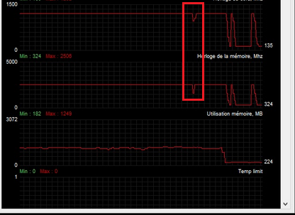

J95 Posted April 6, 2015 Share Posted April 6, 2015 very good Try running Valley (stock clocks) to check throttling, GPU-Z logging. PEG/AW17, M17x, AW18, M18x, I'm working on a fix for stock throttling...feedback appreciated... Quote Link to comment Share on other sites More sharing options...

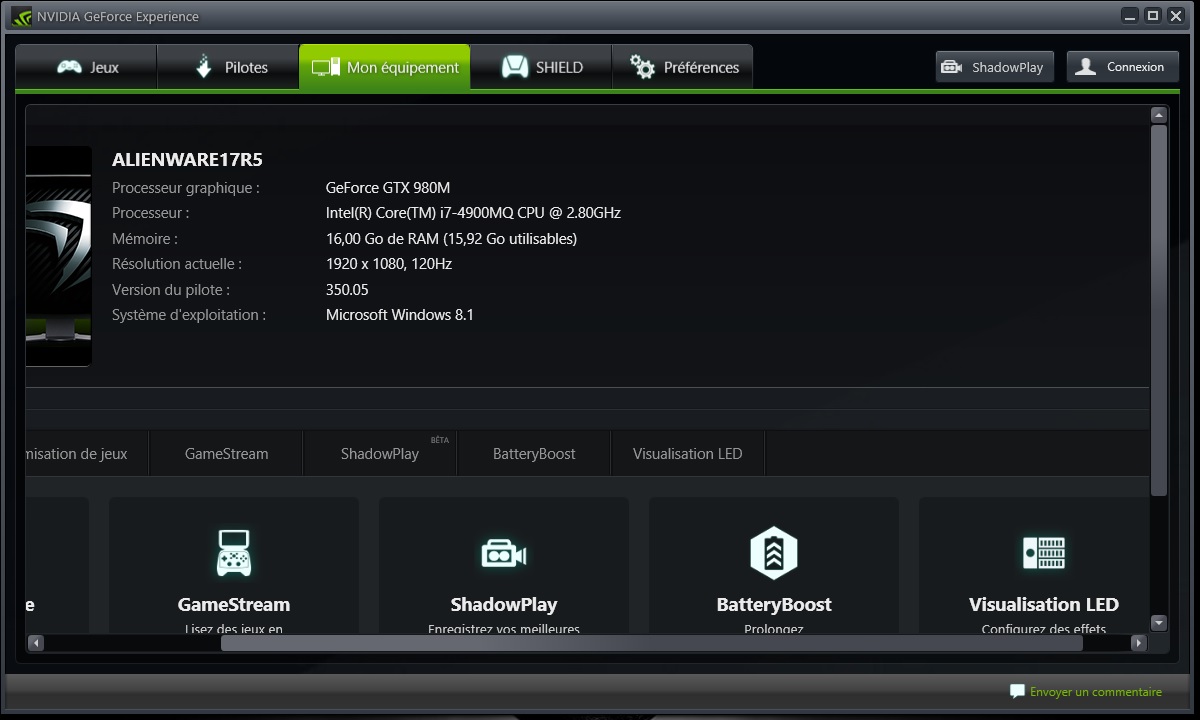

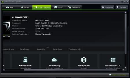

Riri-Fifi Posted April 7, 2015 Share Posted April 7, 2015 My test 1 Quote Link to comment Share on other sites More sharing options...
J95 Posted April 8, 2015 Share Posted April 8, 2015 My test @Riri-Fifi pretty good, dropped to P1 only once. Run DDU and re-install v350.05 using this .inf mod (stock throttling removed), hopefully it won't mess up GFE. Repeat test & settings + GPU-Z logging. - - - Updated - - - AW17/M17x & AW18/M18x (PEG) Stock Throttling Removed (P1 switching) . Optimus .inf option available HERE Flash 900M *svl7* & *Johnksss* vBIOS MODS Run DDU/Safe mode - under options uncheck AMD Audio Bus (bug) -> Clean and Shutdown Win8.1 'F8' Boot options 'Safe Mode' & 'Disable driver Signing' cmd (Admin) bcdedit /set {default} bootmenupolicy legacy -> reboot -> F8 -> select 'Disable Driver Signature Enforcement' -> Install drivers. Extract driver w/ 7-Zip -> Display.Driver folder -> copy/overwrite nv_dispi.inf Run setup.exeGeForce 350.05 HF nv_dispi.inf_v350.05_PEG.zip Quote Link to comment Share on other sites More sharing options...
Riri-Fifi Posted April 8, 2015 Share Posted April 8, 2015 [ATTACH=CONFIG]14527[/ATTACH] @Riri-Fifi pretty good, dropped to P1 only once. Run DDU and re-install v350.05 using this .inf, hopefully it won't mess up GFE. Repeat test & settings + GPU-Z logging.GeForce 350.05 HFlook log gpuzGPU-Z Sensor Log.txt 1 Quote Link to comment Share on other sites More sharing options...
J95 Posted April 8, 2015 Share Posted April 8, 2015 look log gpuzBenchmark22:19:5722:24:41Not a single drop/MHz...? GFE is working without any issues? Quote Link to comment Share on other sites More sharing options...
Riri-Fifi Posted April 8, 2015 Share Posted April 8, 2015 benchmark22:19:5722:24:41not a single drop/mhz...? gfe is working without any issues?gfe ???? Quote Link to comment Share on other sites More sharing options...
J95 Posted April 8, 2015 Share Posted April 8, 2015 gfe ????GeForce Experience.Benchmark22:19:5722:24:41Not a single drop/MHz...? GFE is working without any issues?Did you notice any drops? Quote Link to comment Share on other sites More sharing options...
