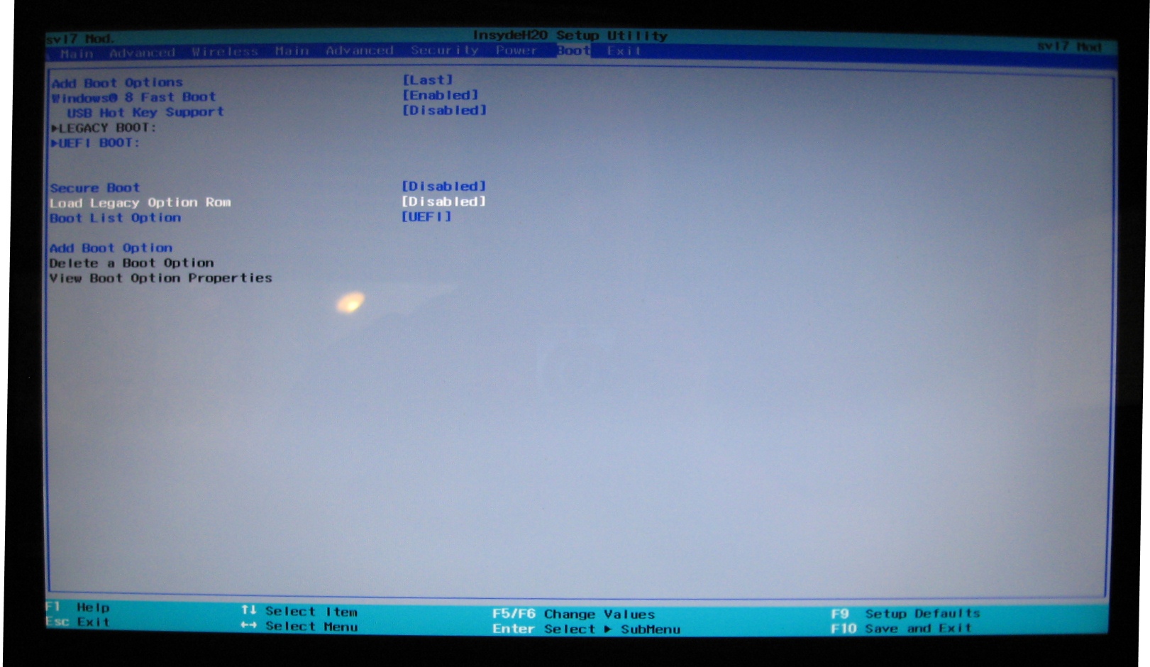

Just boot up the notebook without the GTX 980M installed (You cant access BIOS with 980M with Legacy enabled) and go to BIOS settings and set it to boot as UEFI (enable it) and disable Legacy.
Save and continue.
Open the notebook up and install the GTX 980M. After that is done, just turn the power on like normal and it should work regardless if you have Optimus enabled or not.

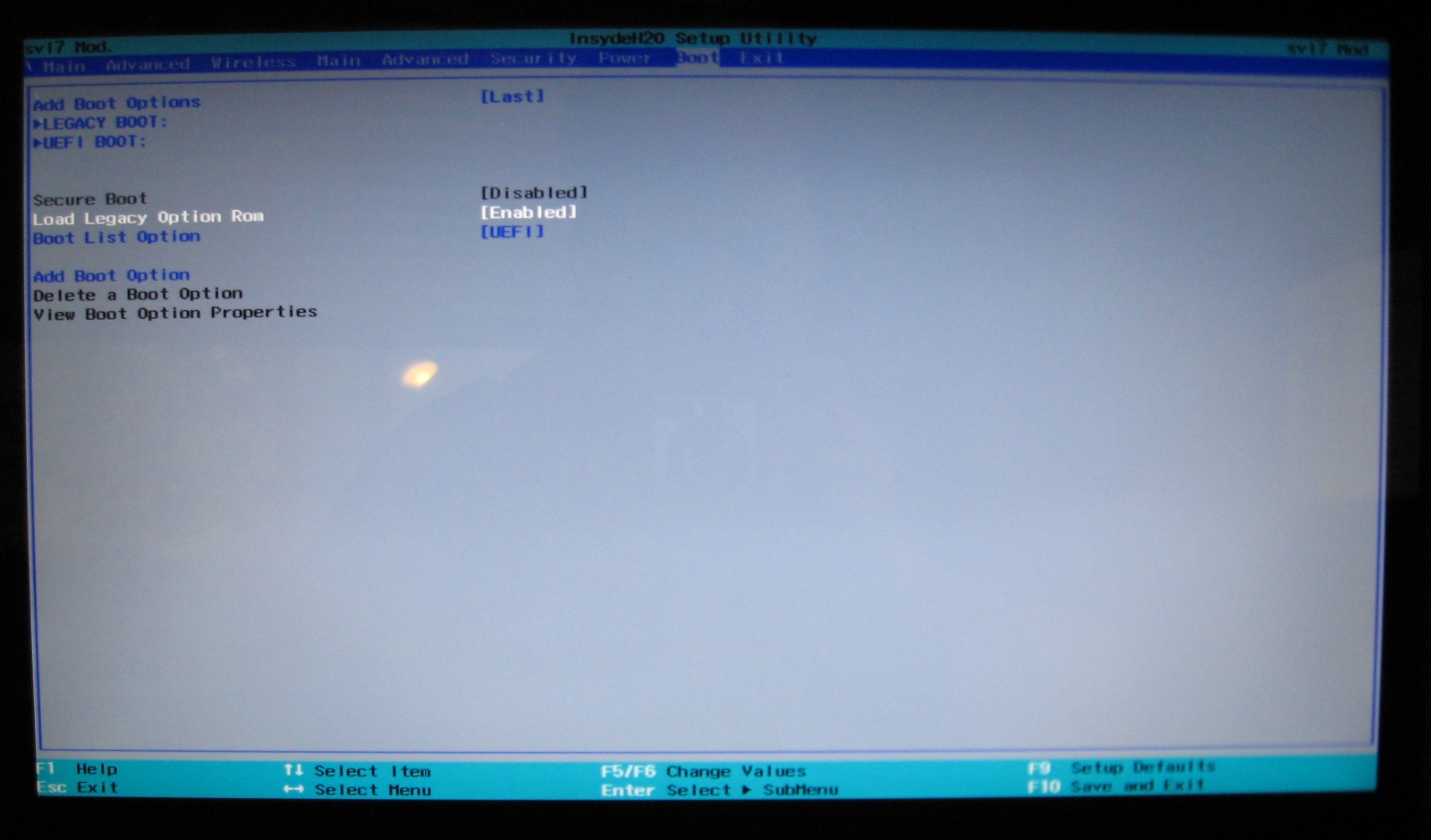

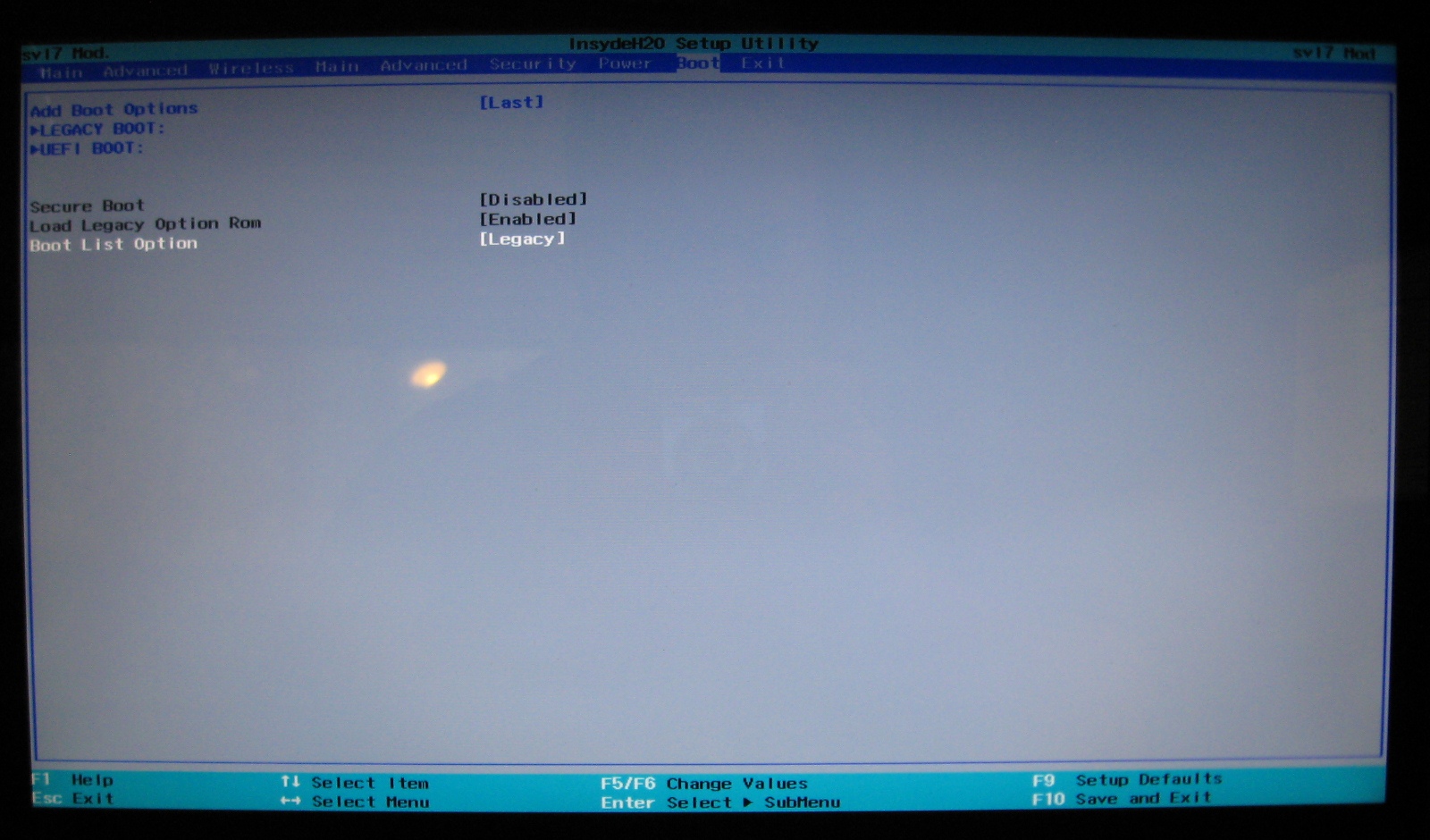

Windows 7 requires either Legacy boot, or UEFI w/ Legacy Option ROM. Brother godfafa, are you using the BIOS option shown in the second photo?
Pure Legacy Mode (no UEFI support):
UEFI w/ Legacy Option ROM: (Can use UEFI Windows Boot Manager)
I have never been able to get Windows 7 install or boot with this BIOS configuration, even using a UEFI USB stick with GPT disk configuration.
Note: This is pure UEFI with no Legacy Boot support. If I am not mistaken, only Windows 8 and newer supports this BIOS configuration.
[ATTACH=CONFIG]13253[/ATTACH]
UEFI w/ Legacy Option ROM: (Can use UEFI ㅆWindows Boot Manager)
[ATTACH=CONFIG]13254[/ATTACH]
[ATTACH=CONFIG]13255[/ATTACH]
Me neither. Not able to install win7. The last picture is the one we need. I think if we want to use win7, we need a new bios or a new vbios that has legacy boot rom.

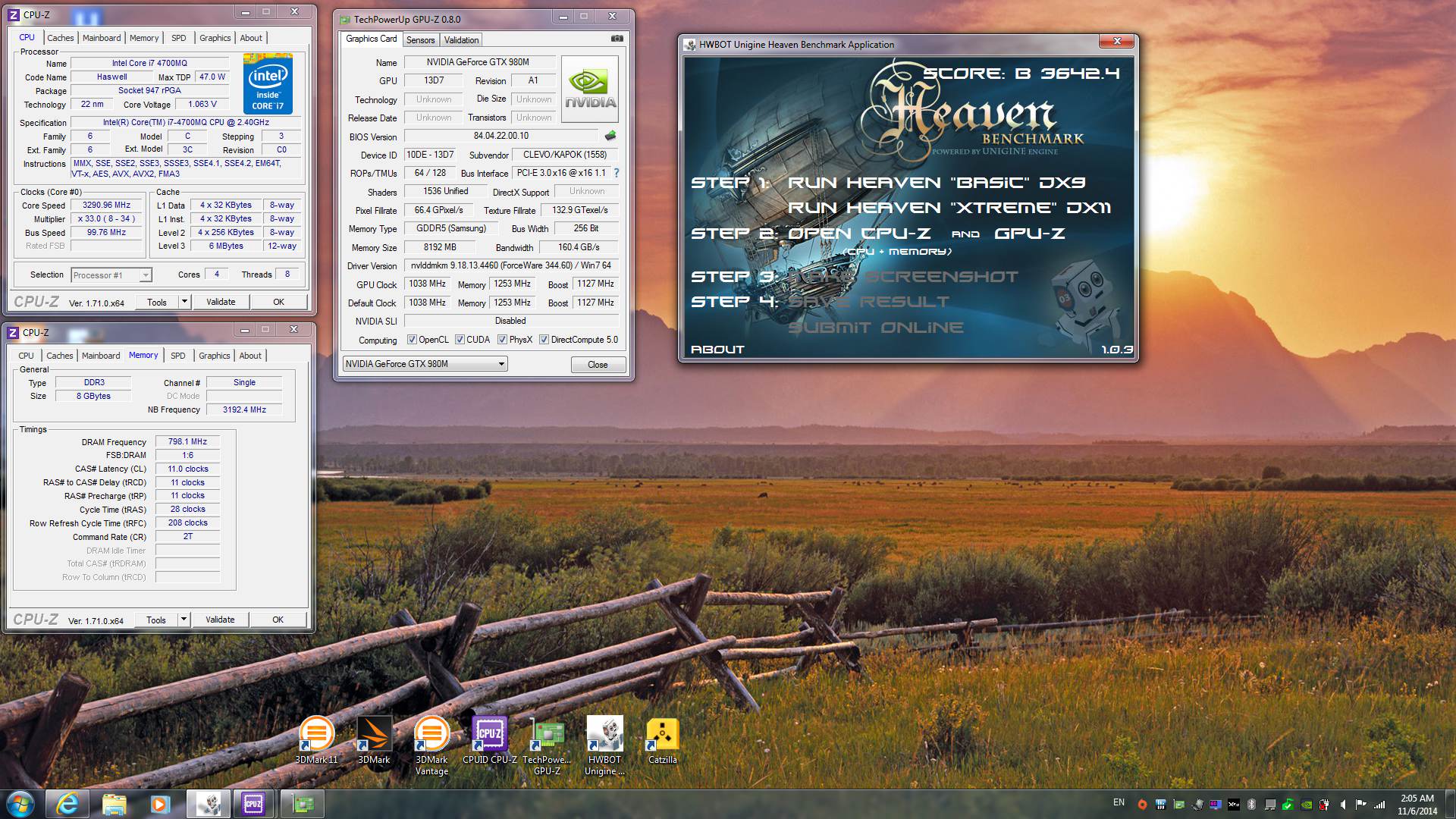

GTX 980M is working on Clevo with Windows 7.
[ATTACH=CONFIG]13256[/ATTACH]

It was Clevo P151SM1 (unlocked Prema BIOS) with core i7 4700MQ, chipset Intel HM87 (Lynx Point), and GTX770M. No problem with installing and work GTX980M under Legacy mode on Windows7 x64. I tried to install GTX980M in my AW 17 3D (2013) under Legacy Mode on Windows7 x64 - and without success. I think that the problem in the Alienware BIOS because in Clevo (unlocked Prema BIOS) everything worked without problems. Today I will try to install Windows7 x64 under UEFI on AW17 with GTX980M - and of course, I will write here.
Update: on Clevo GTX980M worked with Optimus (no 3D 120Hz screen on this Clevo)
