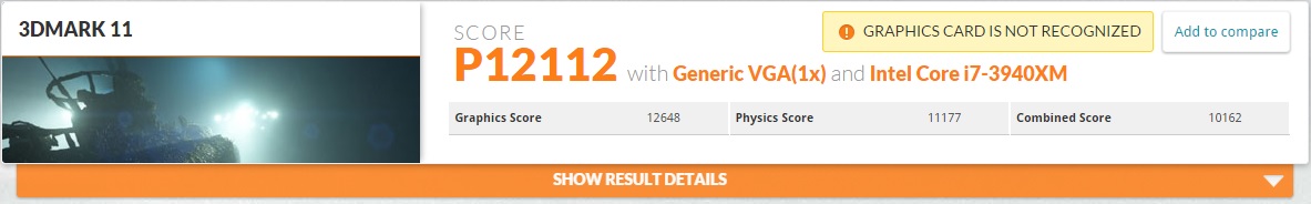

godfafa Posted November 24, 2014 Author Share Posted November 24, 2014 Okay It works in m18x R2 as single 980m "non-optimus". It's 2:23AM, I will do more test tomorrow and let you guys know what I know. Since I have two 980m, I will test more tomorrow and do more benches. All credits to "HARU" from Korean Alienware Forum. 6 Quote Link to comment Share on other sites More sharing options...

Guest Posted November 24, 2014 Share Posted November 24, 2014 Okay It works in m18x R2 as single 980m "non-optimus".It's 2:23AM, I will do more test tomorrow and let you guys know what I know. Since I have two 980m, I will test more tomorrow and do more benches. All credits to "HARU" from Korean Alienware Forum. [ATTACH=CONFIG]13238[/ATTACH] Awesome! What about SLI? Maybe we dont need modding after all the for AW18/M18x? Most importantly, what exactly is changed from the non working 980M to the working 980M? Yay! Looking forward to finding out about SLI and what needed to be done differently than what you had already done. Quote Link to comment Share on other sites More sharing options...
Paolo11 Posted November 24, 2014 Share Posted November 24, 2014 Okay It works in m18x R2 as single 980m "non-optimus".It's 2:23AM, I will do more test tomorrow and let you guys know what I know.Since I have two 980m, I will test more tomorrow and do more benches.All credits to "HARU" from Korean Alienware Forum.[ATTACH=CONFIG]13238[/ATTACH]Nice work, godfafa and Haru. Let's see if it works on AW 18. Quote Link to comment Share on other sites More sharing options...

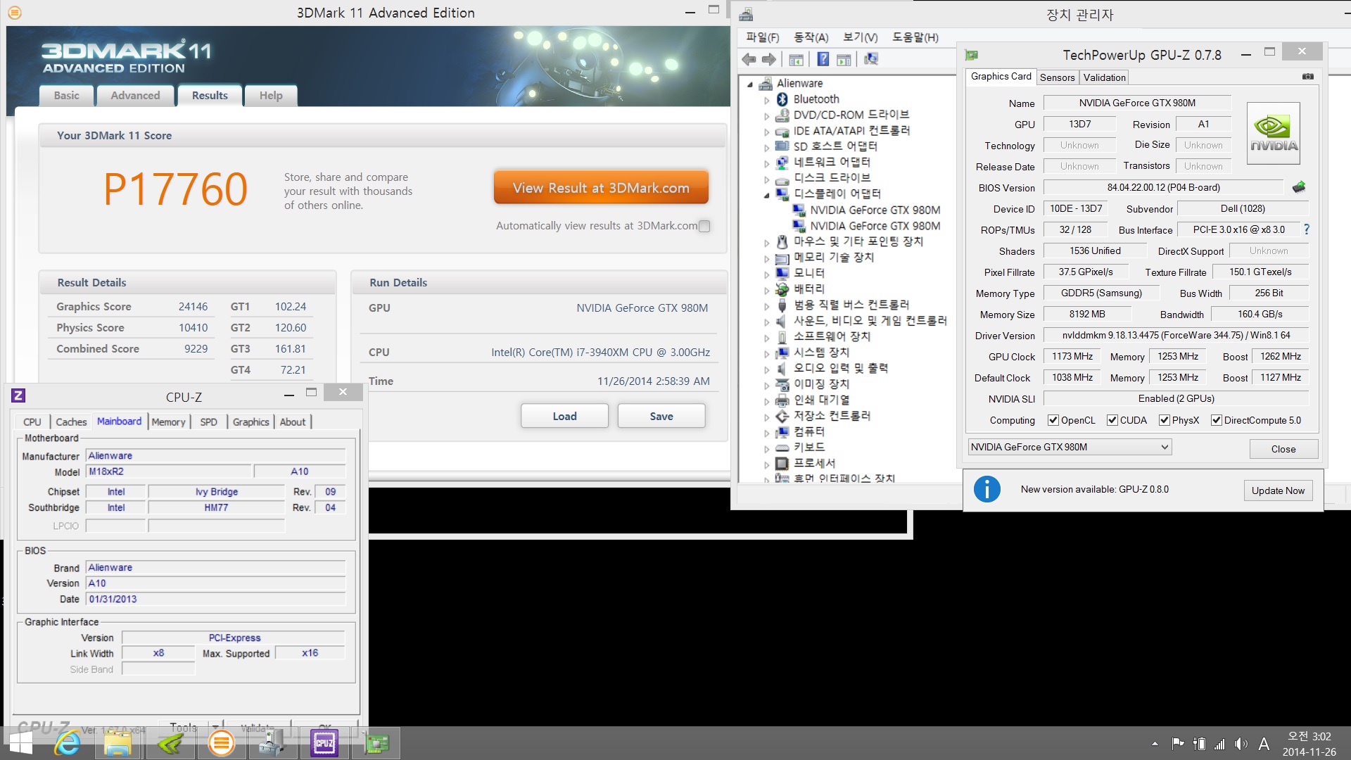

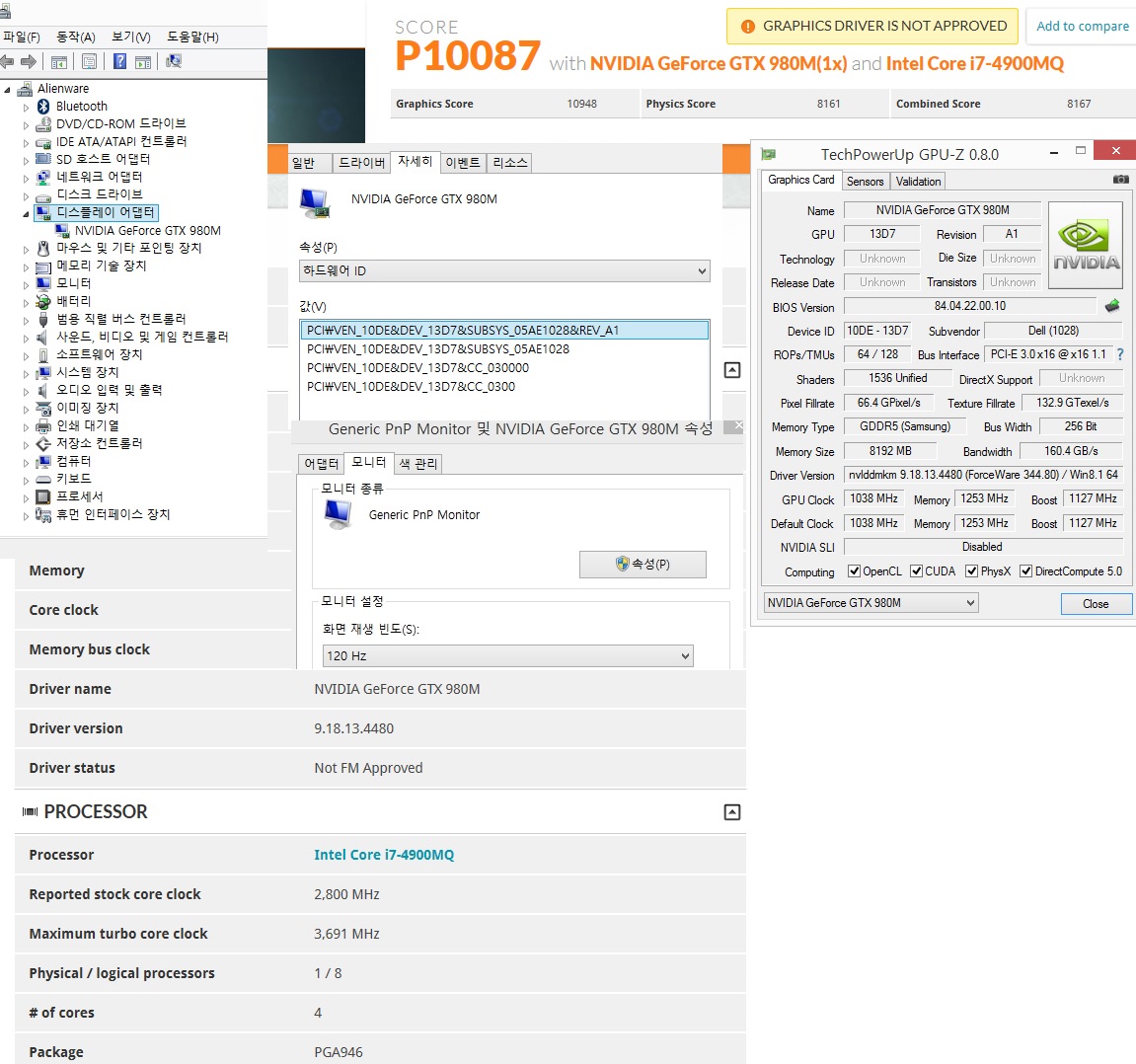

godfafa Posted November 25, 2014 Author Share Posted November 25, 2014 Hello again guys. I am at home. Not yet tested. Mr "Haru" whom I give all the credits wants to share these screenshots here with you guys. His alienware is AW17 3D with 980m. In about 2-3 hours, I think all the tests should be finished. cya. 9 Quote Link to comment Share on other sites More sharing options...
Mickyd1234 Posted November 25, 2014 Share Posted November 25, 2014 [ATTACH=CONFIG]13250[/ATTACH]Hello again guys. I am at home. Not yet tested. Mr "Haru" whom I give all the credits wants to share these screenshots here with you guys. His alienware is AW17 3D with 980m. In about 2-3 hours, I think all the tests should be finished. cya. Woah, what did I miss? It boots fine in the 3D model? Has your man got hold of a Dell vbios or is it a hacked one?Good Luck with the tests . Quote Link to comment Share on other sites More sharing options...
