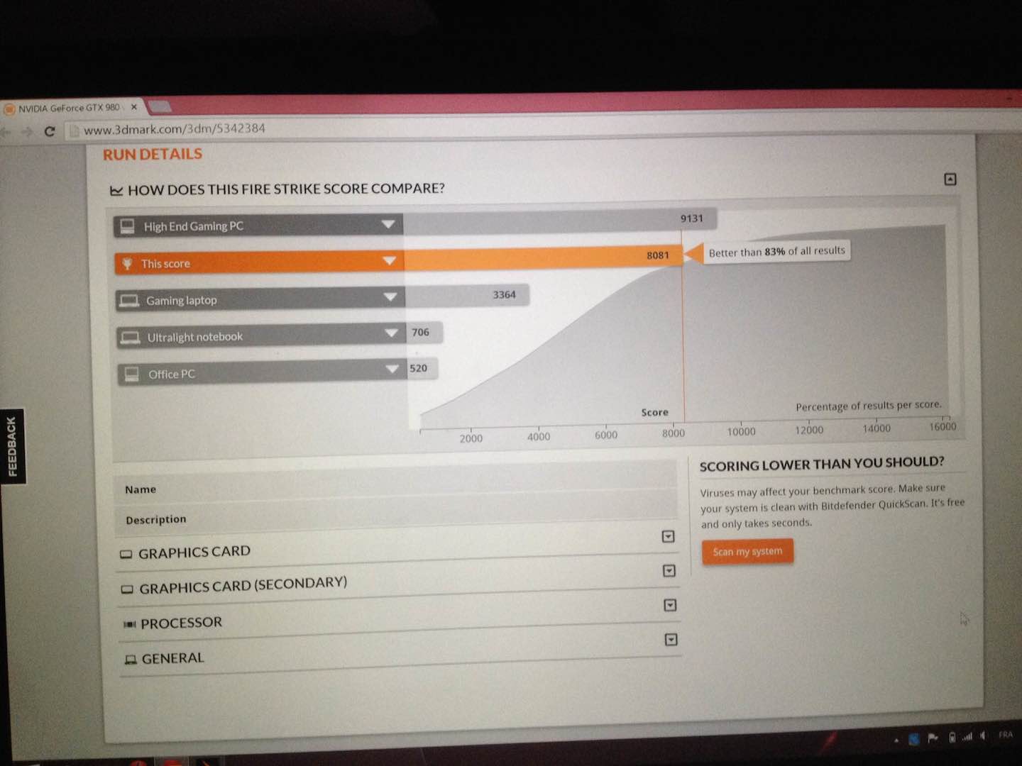

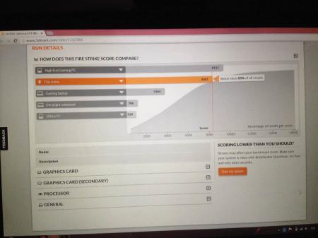

Among others, you gave me the best response and Thank you for that. to clear the confusion My MBPr 15.4" is Late 2013 model with 2 Ghz core i7 processor which has 3.2 Ghz turbo boost.

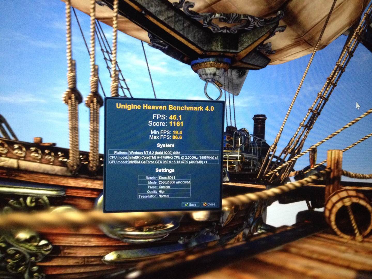

I used Evga Gtx 980 SC ACX 2.0 for my build. I used MBPs Display for Benchmarks and are as follows.
Unigine heaven 4 Score: 1161 at 46 FPS with settings as follows
Mode: 2560x1600 Windowed
Preset: Custom
Quality: High
Tessellation: Normal
Also 3d Mark 11 score is: 8081
Can you use your setup for the same benchmarks at the same setting and show me the score. which will show me the performance difference.

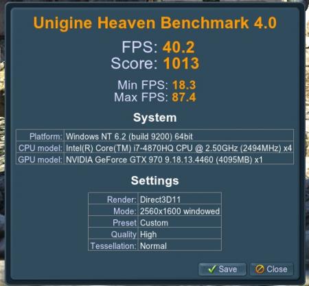

Valley I can do now (give me 5min). But 3dMark 11 Benchmarks do I have already from my first Guide: http://forum.techinferno.com/implementation-guides/7879-%5Bguide%5D-2013-13-macbook-pro-gtx970%4016gbps-tb2-akitio-thunder2-win8-1-osx10-10-a.html
Results are:
internal Display (Optimus): 8205 Link
external Display: 8250 Link
Edit:
Oh boy, that Heaven Benchmark gave me a headache. Didn't want to open 2650x1600 in windowed mode, but was possible after starting and quiting that resolution in fullscreen:

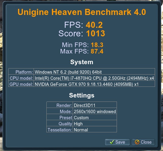

Results are:
Edit:
[ATTACH=CONFIG]13564[/ATTACH]
Looks like its pretty close to my score of 46 FPS. looks like on Internal display, gtx 970 and 980 gives similar performance due to thunderbolt bandwidth limit.
So Dschijn what do you suggest to me, should i return my gtx 980 and replace with gtx 970 as it gives similar or close performance while only using Retina Display for playing PC games.

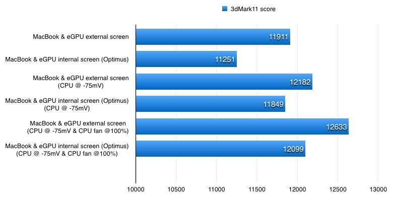

Can you show me 3dmark 11 extreme and performance benchmark score of your egpu setup.
Extreme can't do because that is not possible in the "free" version of 3dMark11.
But Performance I benchmarks I did. Just odd that my external display setup is giving me a worse Physics score.
(All test done with -75mV CPU voltage, GPU with 110% power target and +70 GPU and +20 memory clock speed):
external display: NVIDIA GeForce GTX 970 video card benchmark result - Intel Core i7-4870HQ Processor,Apple Inc. Mac-3CBD00234E554E41
interna displayl: NVIDIA GeForce GTX 970 video card benchmark result - Intel Core i7-4870HQ Processor,Apple Inc. Mac-3CBD00234E554E41
external display (CPU fans @ 100%): http://www.3dmark.com/3dm11/9267439
More detailed 3dMark11 Benchmarks in my Guide now: http://forum.techinferno.com/implementation-guides/8571-%5Bguide%5D-2014-15-macbook-pro-iris-gtx970%4016gbps-tb2-akitio-thunder2-win8-1-a.html#post116865
