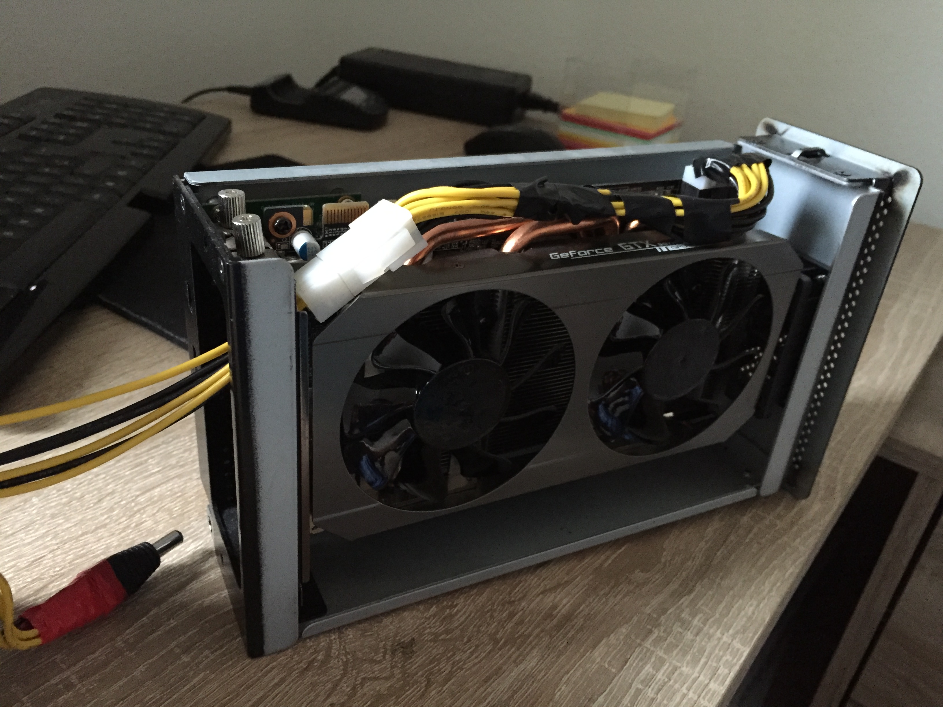

cogliostro Posted April 6, 2016 Share Posted April 6, 2016 Macbook Pro 2015 M370x eGPU: MSI Radeon R9 390x https://de.msi.com/Graphics-card/R9-390X-GAMING-8G.html#hero-overview Box: Aktiito 2 TB2 PSU: Enermax MaxRevo 1350W http://www.enermax.com/home.php?fn=eng/product_a1_1_1&lv0=1&lv1=43&no=158 Monitor: Asus vg236h I Soldered the original Barrel Plug from the Akitio Case to the Molex directly to the Enermax PSU. Sorry but what you mean with the "Power Riser" ? you mean the Barrel Plug to the Enermax PSU? The Akitio will not Power On withouth the Barrel/Molex. Also i have an GTX 970 in my Mac Pro. I can use this to test if the problem still exist with the Aktitiobox. @Morv can you tell my how i have to handle this because you have installed the Radeon Driver by default from Apple. I dont think it is nice to have 2 GPU Drivers on one System? Quote Link to comment Share on other sites More sharing options...
Dschijn Posted April 6, 2016 Share Posted April 6, 2016 @unseenmars There are scripts to disable the monitor (I think on github). Do NOT use sleep with an eGPU! @cogliostro Hmmm... weird. Please check if all cables are fitting propperly. Maybe the TB cable wiggles a bit? Quote Link to comment Share on other sites More sharing options...
cogliostro Posted April 6, 2016 Share Posted April 6, 2016 (edited) @Dschijn 100% Sure without the Barrel the egpu wont start up. The blue indicator lights only shows that its running when i plugged the Barrelplug in the Aktito Edited April 6, 2016 by cogliostro Quote Link to comment Share on other sites More sharing options...
Dschijn Posted April 6, 2016 Share Posted April 6, 2016 Can you post a picture of your hardware? Quote Link to comment Share on other sites More sharing options...
