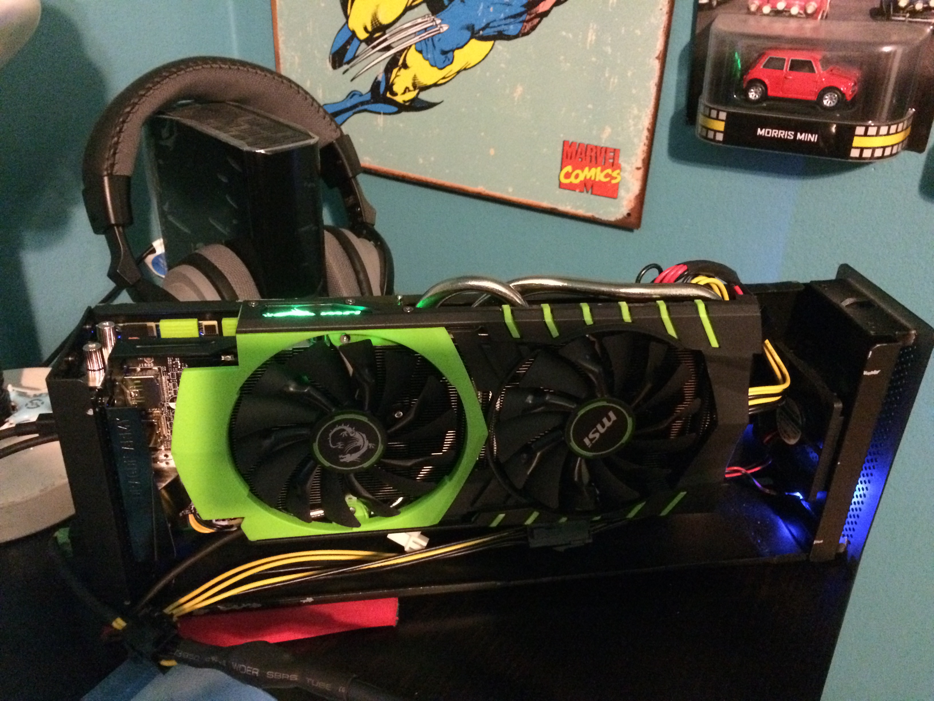

Hello everyone,

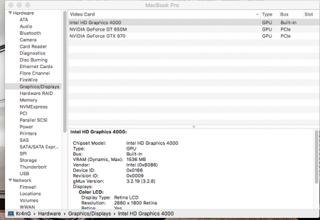

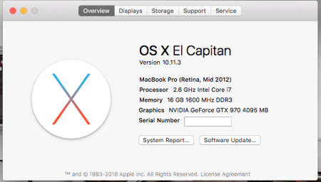

I just got my egpu running on my mid 2012 macbook pro retina with the gtx 970 MSI 100ME using El Capitan 10.11.3. I used the script to get it going but I have a few questions someone on here could help me out and answer.

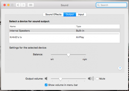

1. When I plug my tv/monitor into my egpu my audio comes out my mac and not my tv. Is this normal? Shouldn't I have audio out my tv since I'm using the hdmi cable? Is their a fix to this or do I just have to use my laptop internal speakers or headphone jack.
2. Do I need to plug in a monitor into the video card in order to get the egpu performance?  Or this is how it is suppose to be..meaning the performance boost is only their when their is a monitor plugged into the egpu only. In other words, is it possible to get the internal monitor running as the gtx 970 egpu without attaching a monitor to the egpu. It seems that when I dont have a monitor connected to the egpu the mac is doing all the work. Is this normal?

1. Go into the audio preferences in OSX and try the different outputs.

Thank you for the answers. I got answers to questions  2 : 4 : 5.   So can someone let me understand question 1 and 3 ?
As far as the audio coming out of the egpu I had no luck. Take a look at my screen shots. Ignore the output to my tv that is actually my apple tv not turned on at the moment or plugged in. Can anyone else confirm that they are getting audio out their egpu unit and not the laptop speakers or jack.
56aad82e6b60f_ScreenShot2016-01-28at9.5256aad83a1f360_ScreenShot2016-01-28at9.5156aad8dc42524_ScreenShot2016-01-28at9.5056aad8f57e4c0_ScreenShot2016-01-28at9.51
Also, is it safe to close the laptop or do I need to use an app to make it turn off.
Edited by Kr4nG
@Kr4nG
1. My script doesn’t support HDMI audio.

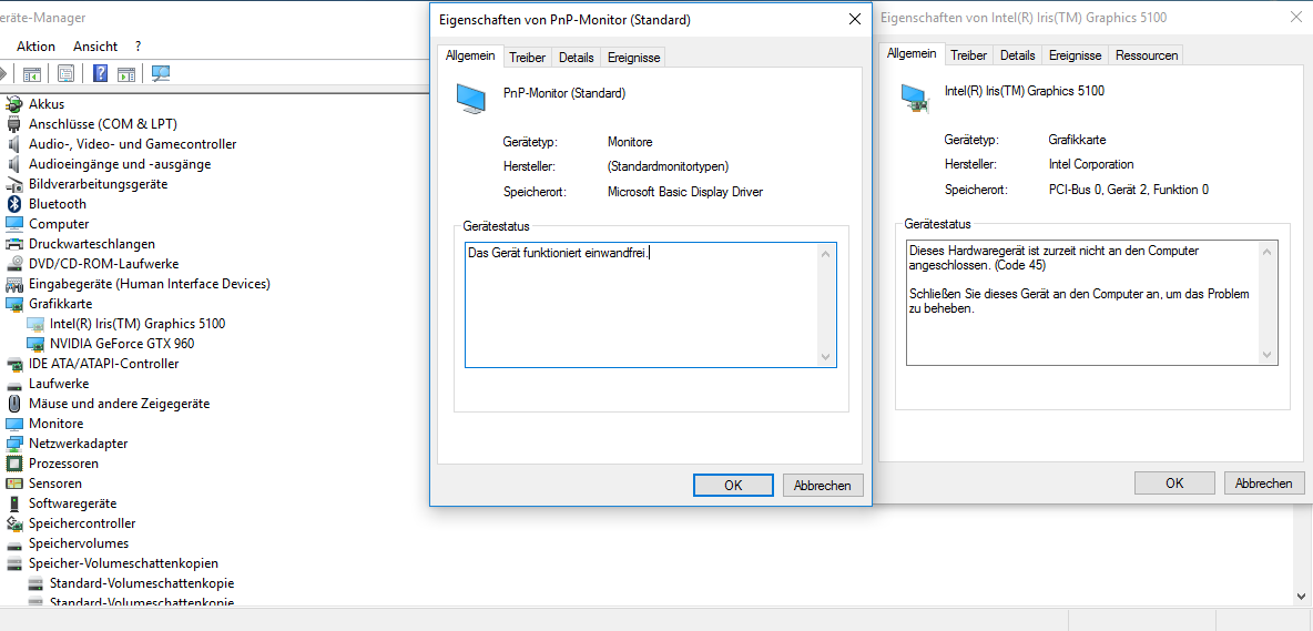

One problem I have is, in Win 10 on an external SSD the internal screen is always black after the installation of the nvidia drivers. IS there any possibility to chance that? In the monitor settings of Windows it recognises the internal Display, but it stays black. Im not sure if this is just an issue with the backlight.
Can anyone help me?
I tried it also with a clean Win 10 installation and the latest nvidia drivers, but that didn't change anything...
@Dschijn Im not sure if i could install the latest ones, as I wanted to install the "latest" ones of the intel website it said while installing, a newer version is already installed, and i repeated the same with the intel driver update utility....
I tried the drivers, but it made no change.
But is it normal/ or supposed to be that the device manager tells me the device is disconnected (code 45)? And it is also set invisible.
Edited by LeoTP

@LeoTP Which device has code 45? The monitor or the Intel Graphics?

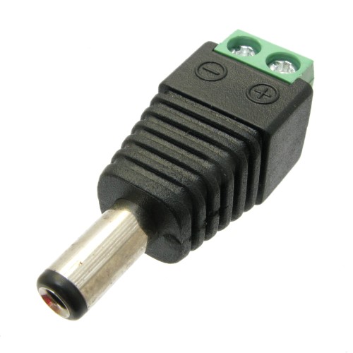

p.s. : It gave me chills when the first time I plugged the barrel mod connected from USED DA-2 220W, triple-checked making sure the output is around 12V!! Luckily it didn't blow up my thunder2 hahaa. But yes I managed to make the barrel mod ONLY from DA-2 without soldering! :D List of items used:-
@Dschijn The monitor is according to the device manager working normally and the Iris 5100 has code 45

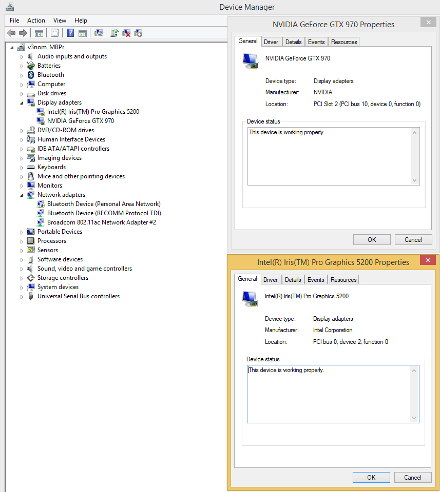

@LeoTP What MB do you have exactly? Is it with a dGPU (Nvidia or AMD) inside as well? Code 45 sounds to me like a driver issue. Have you installed the latest bootcamp driver package?
@Dschijn It's a 13" Mid 2014, Core i5 2.6GHz, 8GB Ram, 128GB SSD. Can you make a screenshot of your Windows Device Manager in Windows? Can you see your iGPU there?
Mine looks like:
And Yes i have the latest bootcamp drivers via AppleUpdate
Edited by LeoTP
E1: Added Screenshot E2: bootcamp drivers
So does the MSI gtx 970 support Metal tool? I still get the same error when using the new command
" xcrun -sdk macosx swiftc -o metaltest metaltest.swift "

@LeoTP Windows 8.1 here:
Edited by Dschijn
pic
@DschijnThanks, so it looks like there is an issue for Win 10/Nvidia Drivers to activate (or not deactivate) the iGPU :/
Only with the EFI Mod,  Win10 does not deactivate it, maybe i need to wait for the next nvidia driver update...
I installed the latest Nvidia drivers, sadly that did not help. If you or anyone else has any idea what I can do, it is highly appreciated. :)
