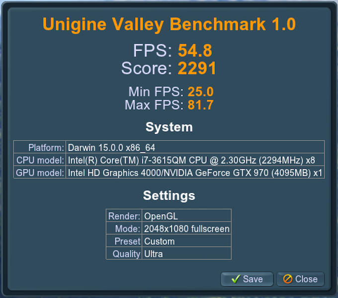

@Morv: Today I tested again and it works! :D
Earlier this week I tested it in Optimus mode without and external display -> doesn't work (crashs after wake up from hibernate).
Now, with an external monitor connected to the eGPU, it works!

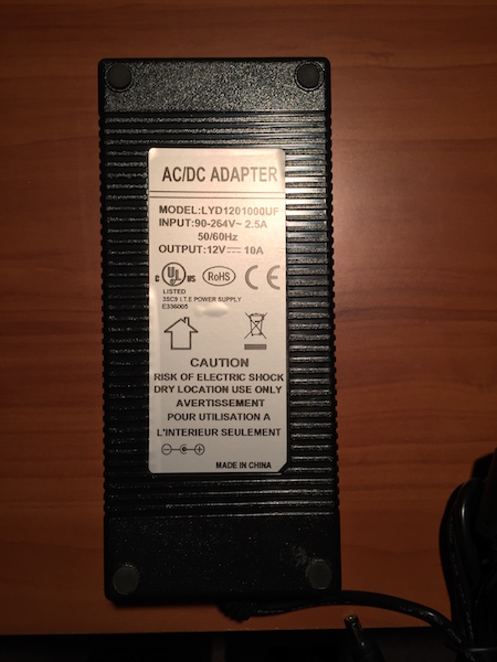

Aren't they all made in China :) .
I was concerned about getting a quality PSU, so I bought one from Amazon for $50. It seems to be of reasonable quality. It is 17.5 x 7.5 x 5cm.
When I measured the output at the barrel connector with my very simple multimeter, it read 12.35V without fluctuation. So I'm not sure what else to do.
Do you think the issue could be between the EVGA GTX 750Ti SC vs GTX 750?
The total power draw on the 750Ti is 60W vs 55W for the base 750, so I would not expect the extra 5W to make a difference if the Akitio is indeed delivering 75W from the PCIe port.

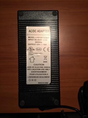

So I tried another external PSU (12V 10A) and still had problems. Kernel panics with web browsing and even simple OS tasks, so I'm starting to think that PSU power isn't the issue. Either there is a driver problem or the power output from the Akitio's PCI-e slot is insufficient.

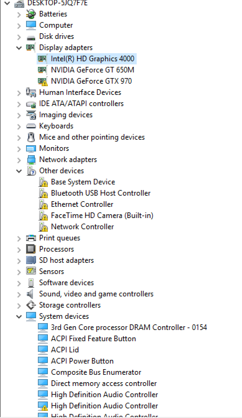

Apologies for my windows ignorance; until now I only used my EGPU with OSX but yesterday I decided to install windows 10 in UFI mode which is now done.
Could someone point me to the right guide or thing to do please; Im almost there; just need to get rid of this code 12 horror
Here is a screen of my system devices
Thanks in advance. any help is appreciated.
