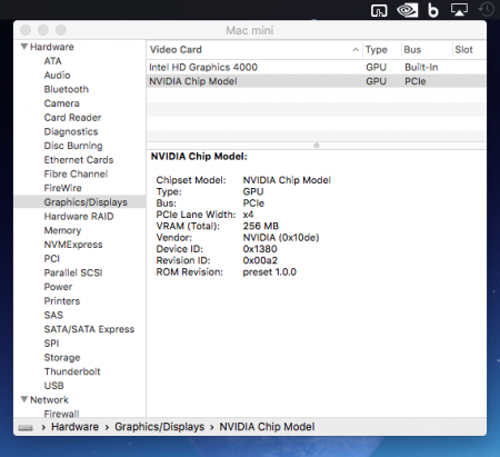

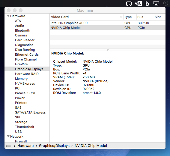

  13. Hi Everyone, Thank you to goalque and everyone else for the amazing support and information. It is really fun to take on a project like this. That being said, I'm having some trouble getting my eGPU set up working. The hardware is as follows: 2012 Mac Mini running Mac OS 10.11.1 (El Capitan) Akitio Thunder2 PCIe Enclosure Lenovo 120W power supply connected directly to Akitio EVGA GeForce GTX 750 Ti SC I was able to get everything connected fine and installed the drivers, etc. using goalque's script. Everything appeared to run smoothly after disabling SIP, but now I am unable to get output from the eGPU when I connect my external display. As you can see in the pictures, the eGPU is detected (although it does not list the specific model) and the NVIDIA software manager is running, but I only get the display signal from the internal GPU. When I reboot and connect the eGPU, the display says that it is not receiving any output. Any help or thoughts would be greatly appreciated. Thanks in advance! Pani
